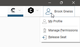

Once you have signed in to Leapfrog Geo using your Seequent ID, the user ID menu in the upper right-hand corner of the main window is used to manage your MySeequent profile and your permissions:
If you are offline, options that require an internet connection will be greyed out. You can continue working in Leapfrog Geo while you are offline until your session expires. To see when this is, click on the user ID menu and select Manage Permissions. The window that appears will display the time and date when your session will expire.
If your organisation shares Leapfrog Geo seats between users, you can release your seat for other Leapfrog Geo users in your organisation when you have finished working with Leapfrog Geo. To release your seat, you can either:
- Select the Release Seat option from the user ID menu.
- Close Leapfrog Geo and choose the Release Seat option when you are prompted.
When you close Leapfrog Geo, the Quit option retains your seat and the next time you launch Leapfrog Geo, you will not have to sign in, nor will you have to select your entitlements.

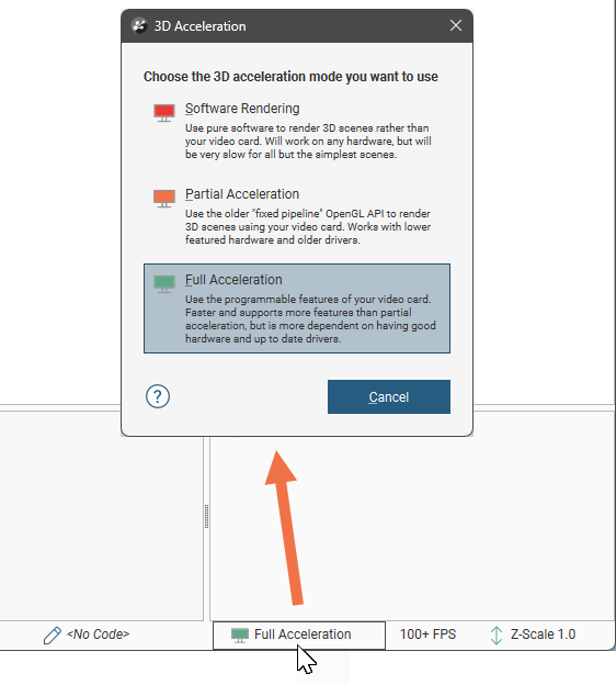

Leapfrog Geo can run in one of three acceleration modes. These modes are selected by clicking on the button at the bottom of the main window:
See 3D Acceleration Mode in Scene Settings for more information on these settings.
A newer computer will run in Full Acceleration mode without issues. However, if you are running Leapfrog Geo on a computer that is more than five years old, it is a good idea to run the graphics test to test your computer’s graphics capabilities.

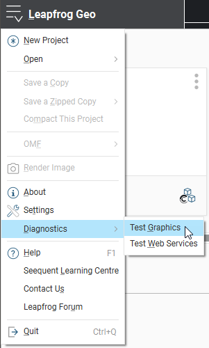

To start the test, open Leapfrog Geo and select Test Graphics from the Leapfrog Geo > Diagnostics menu:

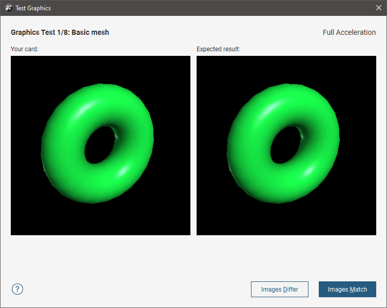

The graphics test displays a series of image pairs that test your computer’s capabilities for the currently selected acceleration mode. For each pair, compare the images:
Even if the differences are slight, click the Images Differ button. If the images match, click the Images Match button. The next test will be displayed.
At the conclusion of the test, the result is displayed. If one or more tests have failed, information about solving problems will be displayed.
If you click on Save Report, you will be prompted to save the file on your computer.
If the test has failed, try switching to a different acceleration mode and running the test again. If possible, avoid using Software Rendering as it can be very slow.
