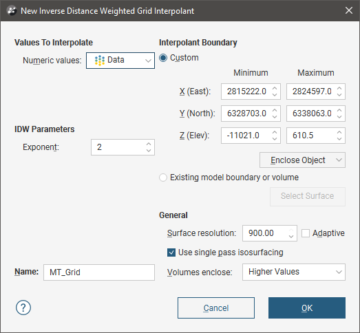

To create an IDW interpolant, right-click on the Numeric Models folder and select New IDW Grid Interpolant. The New Inverse Distance Weighted Grid Interpolant window will be displayed:
This window is divided into four parts that determine the values used to create the interpolant, the IDW parameters, the interpolant boundary and general interpolant properties.
If you are unsure of some settings, most can be changed later. However, the Numeric values object selected when the interpolant is created cannot be changed.
Values Used
You can build an IDW interpolant from Magnetotelluric models, UBC grids and GOCAD models. All suitable data in the project is available from the Numeric values list.
IDW Parameters
The Exponent setting adjusts the strength of the weighting as distance increases. A higher exponent will result in a weaker weight for the same distance.
The Interpolant Boundary
Once the interpolant has been created, you can further modify its boundary. See Modifying an IDW Interpolant’s Boundary with Lateral Extents and Adjusting the Interpolant Boundary below.
Set the Surface resolution for the interpolant and whether or not the resolution is adaptive. See Surface Resolution in Leapfrog Geo for more information on the effects of these settings. The resolution can be changed once the interpolant has been created, so setting a value in the New Inverse Distance Weighted Grid Interpolant window is not vital. A lower value will produce more detail, but calculations will take longer.
The Volumes enclose option determines whether the interpolant volumes enclose Higher Values, Lower Values or Intervals. Again, this option can be changed once the interpolant has been created.

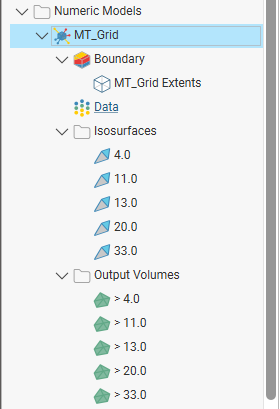

The IDW Interpolant in the Project Tree
The new interpolant will be created and added to the Numeric Models folder. The new interpolant contains objects that represent different parts of the interpolant:
- The Boundary object defines the limits of the interpolant. See Modifying an IDW Interpolant’s Boundary with Lateral Extents.
- The points data values object contains all the data used in generating the interpolant. See Changing and Adjusting the Values Used.
- The Isosurfaces folder contains all the meshes generated in building the interpolant.
- The Output Volumes folder contains all the volumes generated in building the interpolant.
Other objects may appear in the project tree under the interpolant as you make changes to it.

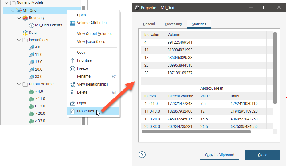

IDW Interpolant Statistics
You can view the approximated mean for each output volume by right-clicking on the interpolant and selecting Properties. Click on the Statistics tab:

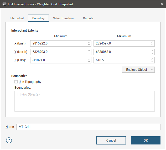

To change an IDW interpolant’s boundary, double-click on the interpolant in the project tree, then click on the Boundary tab:
Lateral extents can be used to restrict modelling to a particular area of interest; for example, modelling can be restricted to a known distance from drillholes by applying a distance function as a lateral extent.

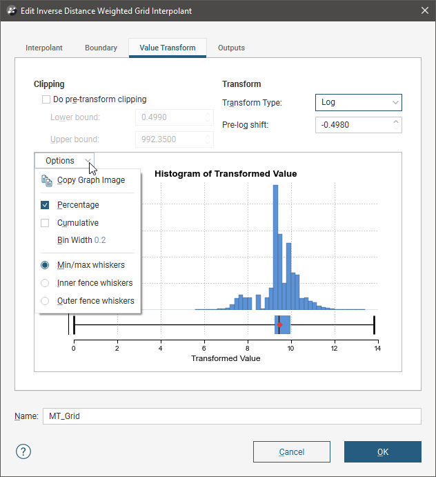

To clip data and apply a transformation to an IDW interpolant, double-click on the interpolant in the project tree, then click on the Value Transform tab:
The settings in this tab are the same as those for RBF interpolants. See Clipping and Transforming Values for an RBF Interpolant in the RBF Interpolants topic for more information.

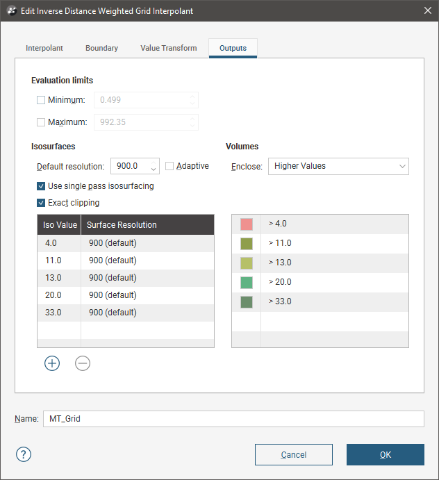

You can change the parameters used to generate IDW interpolant outputs by double-clicking on the interpolant, then clicking on the Outputs tab.
The Evaluation limits apply when interpolants are evaluated against other objects in the project. When the limits are enabled, all values outside the limits will be set to the Minimum and Maximum.
To add a new isosurface, click the Add button and enter the required value. To delete an isosurface, click on it in the list, then click the Remove button. You can also change the colours used to display the isosurfaces by clicking on the colour chips.
If you find that grade shells are overlapping, the resolution may be too coarse. Set Default resolution to a lower value or enable adaptive resolution in the Outputs tab. See Surface Resolution in Leapfrog Geo.
