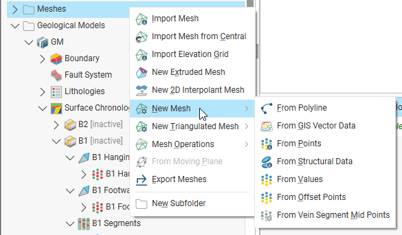

To create an interpolated mesh from data in the project, right-click on the Meshes folder and select from the New Mesh options:
Here, a new mesh is being created from points:

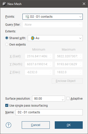

Select the required object from the list.
When defining the mesh’s extents, you can set the extents to be independent of other objects in the project (Own extents) or you can use the extents of another object (Shared with). When you select the Shared with option, the mesh will be updated when the extents object it shares is updated.
Leapfrog Geo automatically sets the surface resolution based on the data available in the project. You can experiment with the surface resolution, adaptive and single pass settings once you have created the mesh. See Surface Resolution in Leapfrog Geo for more information on the effects of these settings.
Enter a name for the new mesh and click OK.

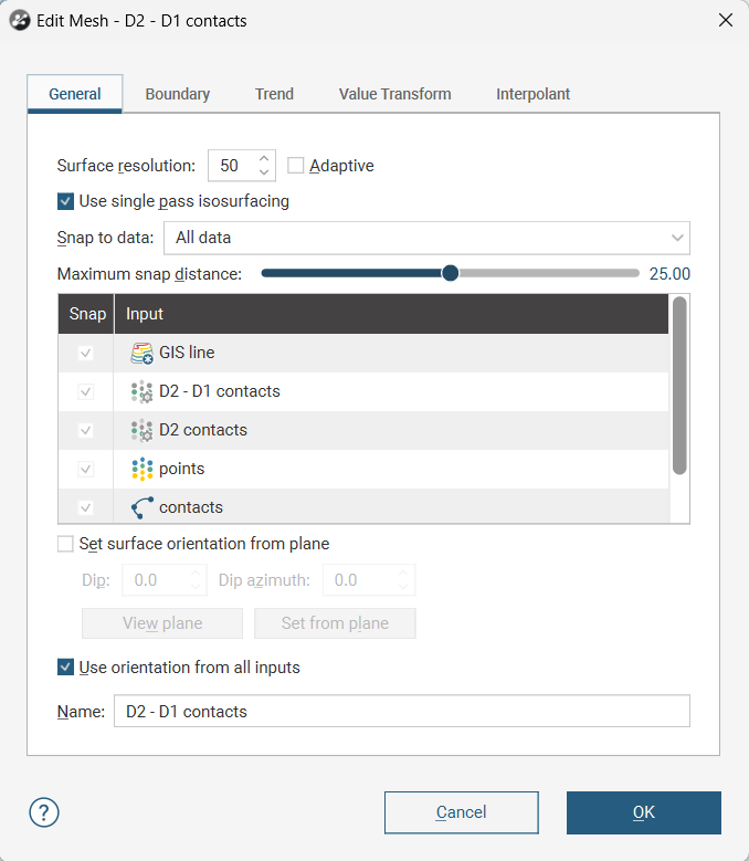

You can also refine editable interpolated meshes by changing the trend, transforming values, adjusting the interpolant and changing the boundary. To do this, double-click on the mesh. The Edit Mesh window will be opened:

Surface Resolution Settings
See Surface Resolution in Leapfrog Geo for more information on the Surface resolution settings in the General tab.
Snap Settings
The mesh can be set to snap to the data objects used to create it. There are four options:
  • Off. The mesh does not snap to the data.
  • All data. The mesh snaps to data within the Maximum snap distance.
  • Drilling only. The mesh snaps only to drilling data and data objects derived from drilling data within the Maximum snap distance but not to other data. For example, the mesh will honour points data derived from drilling data, but not points data imported into the Points folder.
  • Custom. The mesh snaps to selected data objects within the Maximum snap distance.
When Snap to data is set to Custom, you can then set whether or not Snap is enabled for the objects used to create the mesh, as discussed in Honouring Surface Contacts. Custom is the most flexible options as you can select the specific data objects the mesh will or will not snap to.
If you will be exporting the mesh for use in another application, you may wish to adjust the snap settings.
Data used to create the mesh will appear in the Input list. When you add more data to the mesh, those objects will also be listed. You can remove those additional objects by expanding the mesh in the project tree, then right-clicking on the data object and selecting Remove.

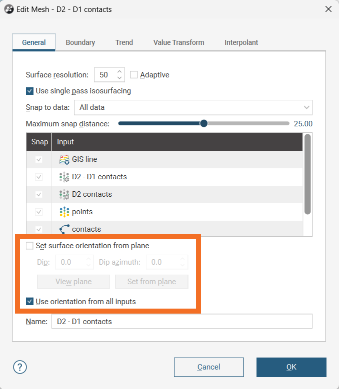

Setting the Surface Orientation
Below the input list there are two additional settings in the General tab, Set surface orientation from plane and Use orientation from all inputs.
These settings relate to the generation of the off-surface points that are used in determining the surface’s orientation.
The Set surface orientation from plane option may be useful if the available input data is sparse or contains inconsistent orientation information.
The Use orientation from all inputs setting is only available when the surface also includes polyline and/or structural data.
  • When this setting is disabled, only the information from the polyline/structural data will be used in generating off-surface values.
  • When this setting is enabled, both drilling contacts and polyline/structural data will be used in generating off-surface values.
Use orientation from all inputs was introduced in Leapfrog Geo 2024.1. New meshes are created with this setting enabled by default. However, when existing meshes are upgraded in Leapfrog Geo 2024.1 or later, the Use orientation from all inputs setting will be disabled in order to preserve the mesh’s pre-upgrade settings.
