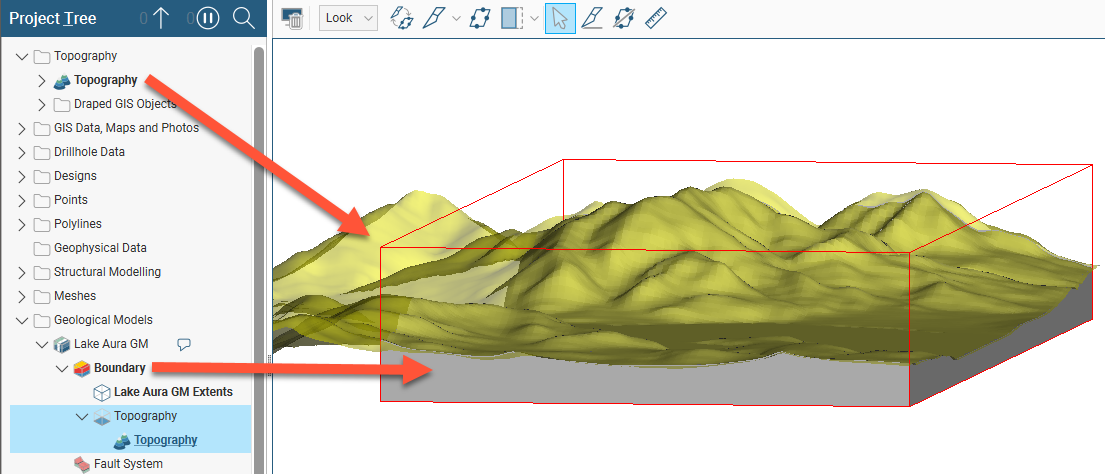

It is not necessary to define a topography to model in Leapfrog Geo, but a defined topography can be used as an upper boundary for all models built in the project. Here, for example, the topography is used as the upper boundary for a geological model; the model’s boundary is shown in dark grey and the topography, which is linked to the model’s boundary, is the transparent yellow. The geological model’s extents object, the red box in the scene below, shows the full height of the model as a whole; the topography effectively cuts away the parts of the model that occur above the topography.

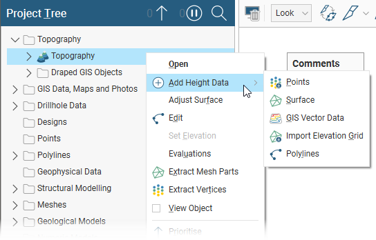

When creating the topography, it is not necessary to decide on a single source of information, as information can be combined. Once the topography has been defined, additional height data can be added by right-clicking on the topography and selecting from the options available:
It is not possible to add structural data or polylines with orientation information to the topography. If you edit the topography with a polyline, your options for editing the polyline will be limited.
For points, surfaces and GIS vector data, you will be prompted to select from the data sources available in the project. For an elevation grid, see Importing an Elevation Grid.

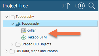

All data objects used to define the topography will appear under the topography, hyperlinked to their parent objects:
When you have added data to the topography, you may need to enlarge the topography extents. See Changing Topography Settings below.

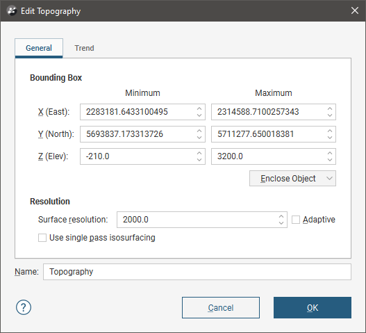

When the topography is created from points or GIS data or when the topography is created by combining data, you can change its boundary and resolution and apply a trend. To do this, double-click on the topography in the project tree. The Edit Topography window will appear:
Changing the Size of the Topography
In the General tab, you can change the topography extents. Use the controls in the scene or enter the required values in the Bounding Box fields.

When the topography is created from points or GIS data or when the topography is created from combining data, you can set its resolution in the Edit Topography window.
When you set a specific Surface resolution without enabling the Adaptive option, the triangles used will be the same size for the whole topography. When you enable the Adaptive option, the resolution of the topography will be affected by the availability and density of real data. See Adaptive Isosurfacing in the Surface Resolution in Leapfrog Geo topic for more information on this option.
Leapfrog Geo uses single pass isosurfacing by default as the accuracy of the mesh is typically adequate with a single pass. Double-pass mesh generation can result in higher accuracy in some situations, but there are tradeoffs. See Single Pass Isosurfacing in the Surface Resolution in Leapfrog Geo topic for more information on this option.

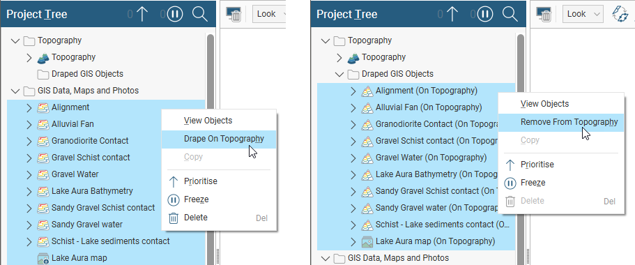

Draping Data Objects on the Topography
Once you have defined a topography, you can drape GIS data objects and images imported into the GIS Data, Maps and Photos folder and contour lines in the Sections, Plans and Contours folder onto the topography.
In versions of Leapfrog Geo before 2022.1, GIS data objects and images imported into the GIS Data, Maps and Photos folder and contour lines created in the Sections, Plans and Contours folder were automatically draped on the topography. When you upgrade projects in Leapfrog Geo 2022.1, objects already draped will remain draped, and you can choose to remove them from the topography, if you wish.

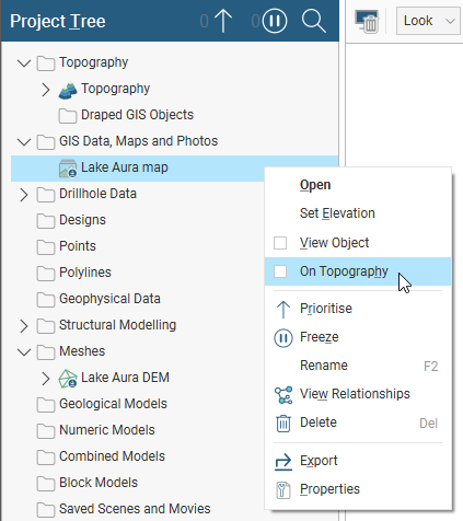

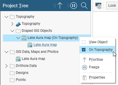

To drape a data object onto the topography, right-click on the object in the project tree and enable the On Topography option:
The On Topography option will not appear in the right-click menu if there is no topography defined.

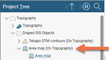

All draped objects will be listed in the Draped GIS Objects folder, under the topography:

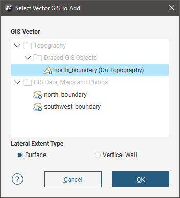

When you have draped objects on the topography and are using those objects in building models, you can sometimes choose whether to use the draped object or the object itself. For example, here in creating a lateral extent for a geological model using the north_boundary GIS object, you can choose whether to use the draped object or the undraped object:
Note that only the southwest_boundary GIS line can be used as it has not been draped on the topography.
To remove an object from the topography, right-click on either the draped object or the object itself and disable the On Topography option:
The object will be removed from the Draped GIS Objects folder and from objects that use the draped object.
You can select multiple objects and drape/remove them all at once:

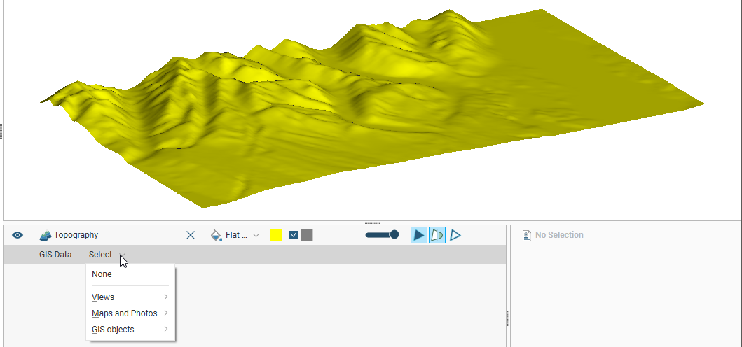

To display the topography in the scene window, either:
- Right-click on the topography in the project tree and select View Object.
- Click on the topography object and drag it into the scene.
The topography will be displayed in the scene window and in the shape list:

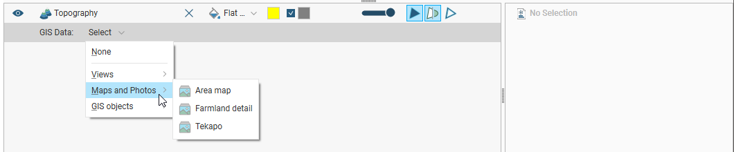

The topography object in the shape list provides additional controls that can be used to change the way the topography is displayed and highlight features of interest. For example, selecting an imported map from the list results in it being displayed draped onto the topography:
Note that only objects that have been draped on the topography are available from the GIS Data list. See Draping Data Objects on the Topography above for more information.
The list is organised into:
- Views. This contains options for creating and editing custom topography views and also lists any views already defined. With custom topography views, you can view multiple GIS objects, maps and contours. See Custom Topography Views below for more information.
- Maps and Photos. This lists all images stored in the GIS Data, Maps and Photos folder that have been draped on the topography.
- GIS objects. This lists all GIS data objects stored in the GIS Data, Maps and Photos folder that have been draped on the topography.

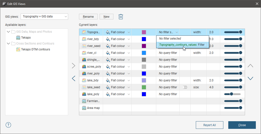

In Leapfrog Geo, a topography can be displayed with any of the GIS data, images and contour lines in the project that have been draped on the topography.
Note that only objects that have been draped on the topography can be added to custom topography views. See Draping Data Objects on the Topography above for more information.

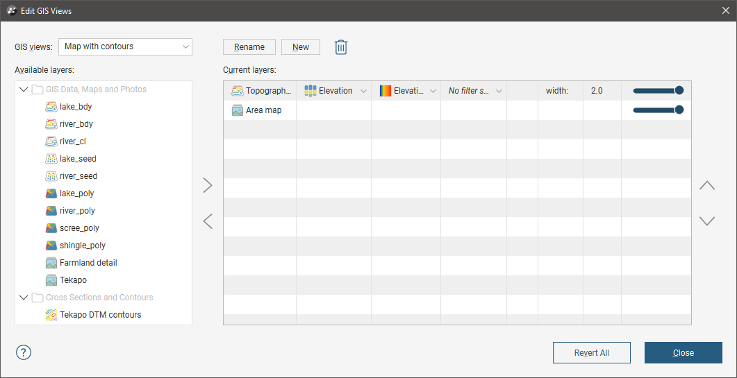

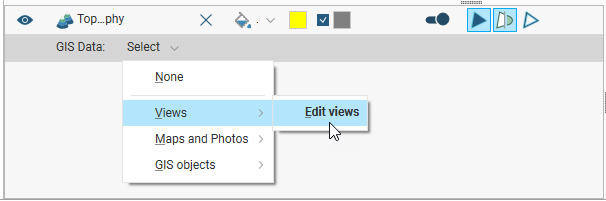

To create a custom view, add the topography object to the scene. Select Views > Edit views from the GIS data list:

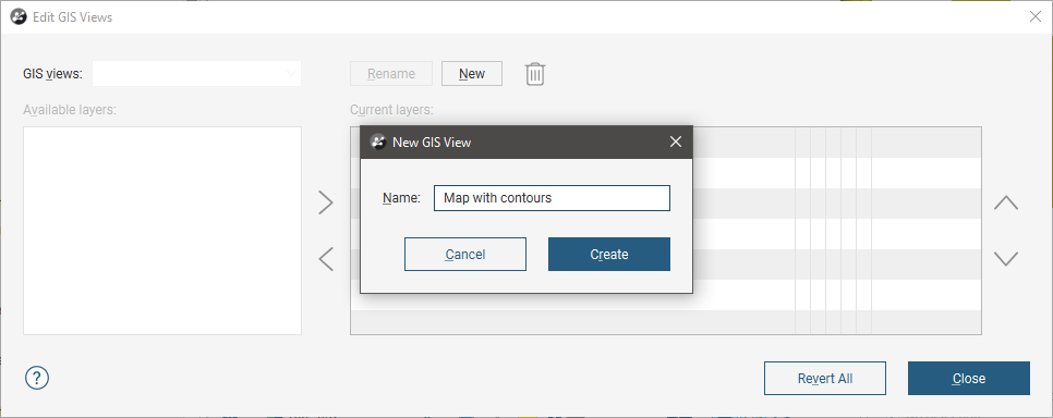

The Edit GIS Views window will appear. Click New to create a new view. Enter a name for the new view and click Create:
The new view will be created in the Edit GIS Views window, together with a list of Available layers. Use the arrows to move layers into the Current layers list and organise them:
If you have defined a query filter for an object, you can use that filter in the custom view:
Use the transparency and point and line size controls to emphasise data.

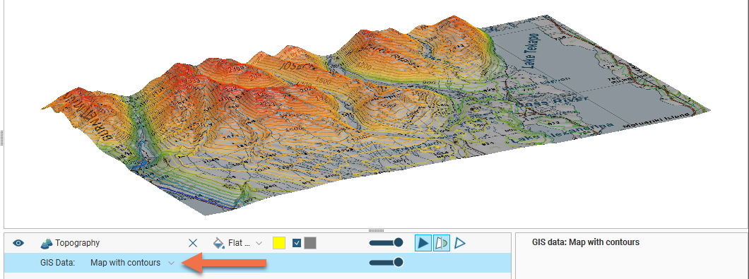

Click Close. The topography will be displayed in the scene with the new view applied:
