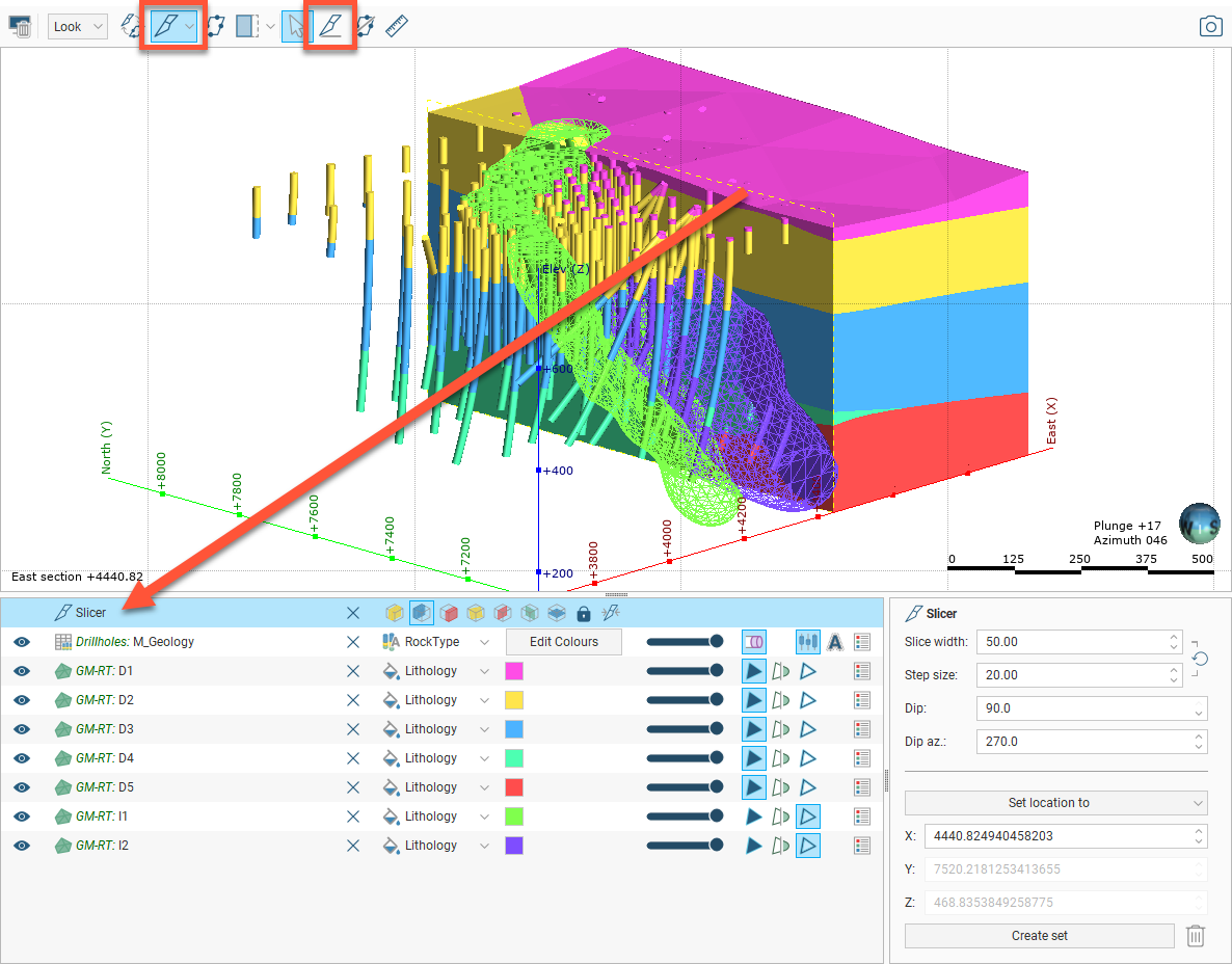

Two buttons in the toolbar can be used to add the slicer to the scene:
You can add the slicer to the scene by clicking the Show slicer button (
) or (
). The slicer will appear in the scene and you can adjust its position using the controls in the shape list.
You can also click the Draw slicer line button (
) then click and drag in the scene to cut a slice through the scene.
The scene may appear empty because the slicer has removed all visible data. Reposition the slicer or turn it off.

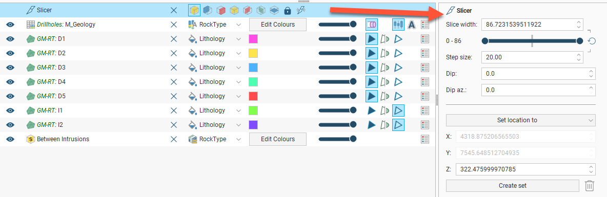

You can change the way the slice appears in the scene using the controls in the shape list, and finer controls are available in the shape properties panel:

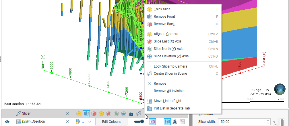

Right-click on the slicer in the shape list to view more information about each option:
Some objects may not be sliced in the scene because of their Slice mode setting. See Object Slice Mode for more information.
Remove Front (
) and Remove Back (
) will cut through the scene along the slicer and only show sliced objects on the front or back side of the slicer, respectively.

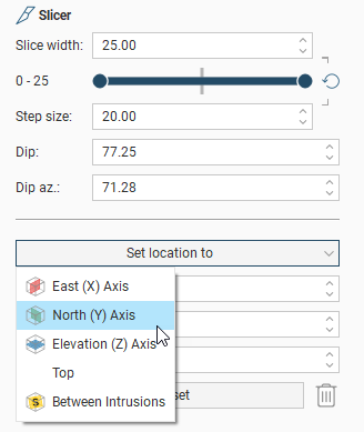

You can get an asymmetric thick slice with different amounts either side of the slicer plane by dragging the ends of the thickness adjustment control in the properties panel immediately below the Slice width field. Double-click on the thickness adjustment control to zoom in for finer control, and right-click to zoom back out.

The Set location to list in the shape properties panel contains options to slice across each of the coordinate axes, plus the options to set a slice at the very top of the model and to position the slicer at the location of any sections displayed in the scene:

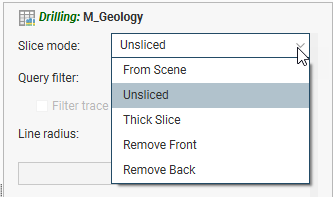

Object Slice Mode

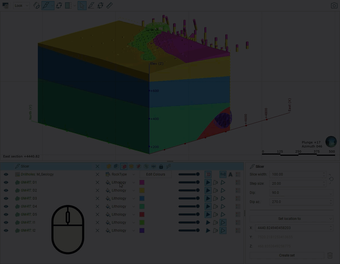

When the slicer is in the scene, how an object is sliced depends on its Slice mode, which is set in the properties panel. Being able to set Slice mode for each object gives you more flexibility in how you display data in the scene. For example, here the M_Geology table is selected in order to change how the drillholes are displayed in relation to the slicer:
The From Scene setting is the default; the object is sliced according to the properties set for the slicer.

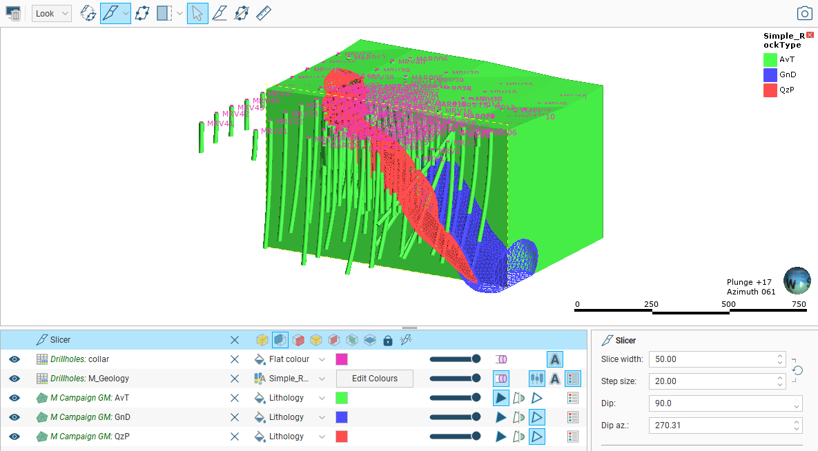

By changing the Slice mode for objects in the scene, you can illustrate how a model has been constructed. For example, here the AvT volume is displayed sliced, but the other volumes are unsliced, as is the drilling data, and we can see the relationship between the drilling data and the two intrusion surfaces modelled from it:

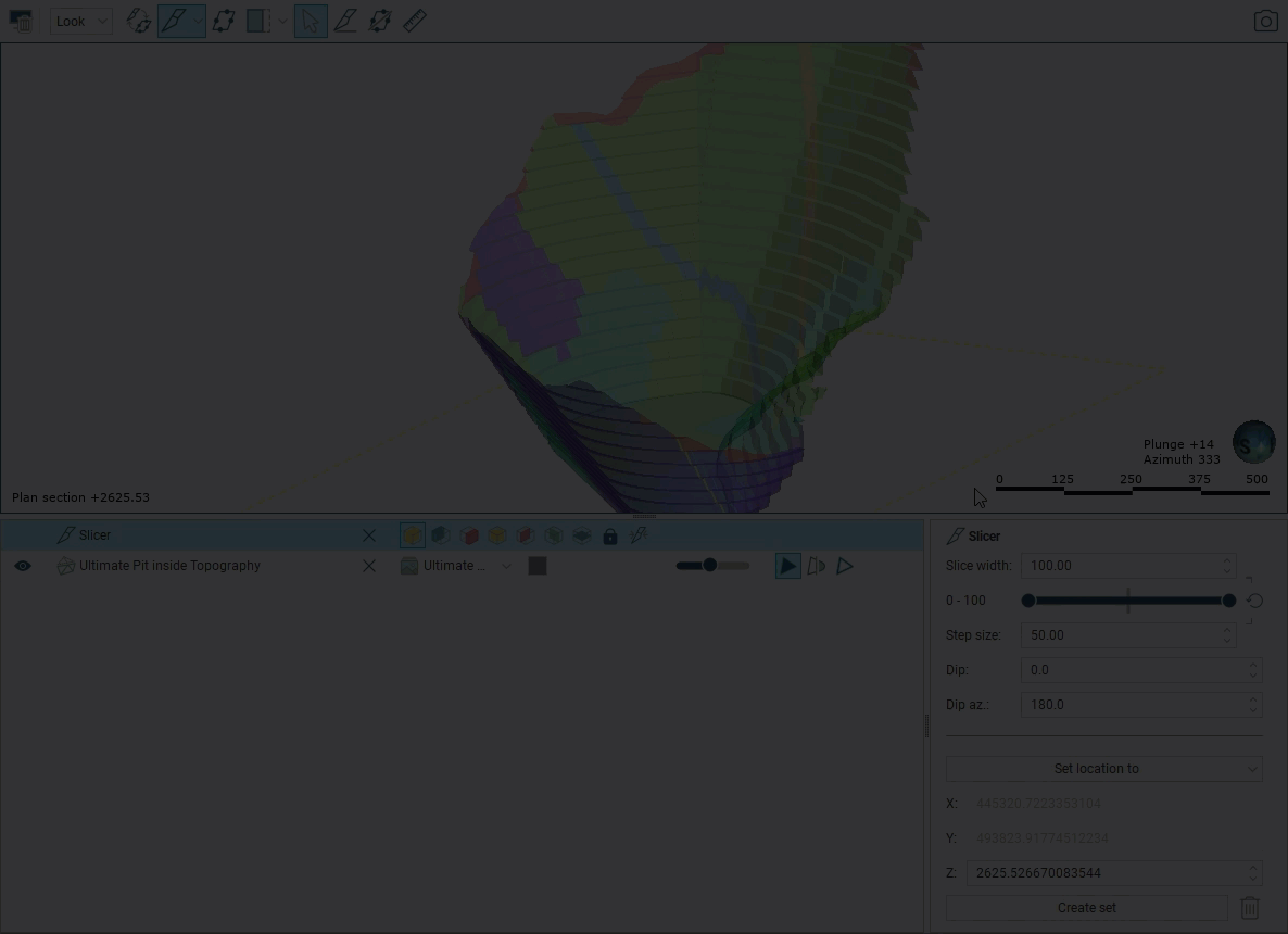

Slicer Sets
Slicer sets create a series of slices a set distance apart, and can be very useful to align multiple slices with stopes/benches/flitches.
When you have settled on a slicer orientation, you can save the slicer position and give it a name by clicking Create Set in the properties panel. You can also define a Number of slices in front of and/or behind the slicer and parallel to it. Once defined, the Show slicer button changes from
to
You can recall a slicer set by clicking the dropdown list indicator next to the Show slicer button (
) and selecting a slicer set from the list. You can step through the adjacent slices using the , and . keys on your keyboard. The , and . keys are the keys that also have < and > printed, so you can think of these as the ‘backward’ and ‘forward’ keys for stepping through the slices.

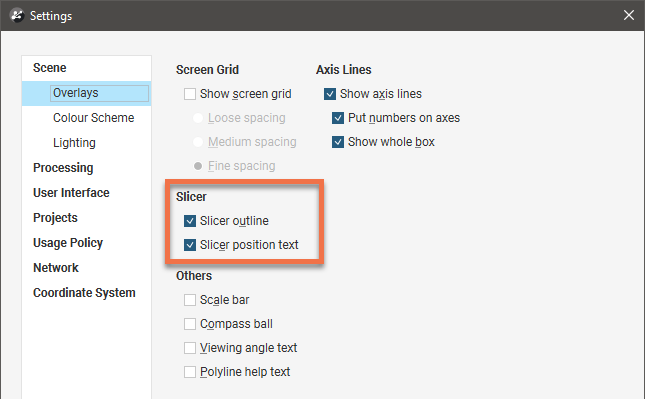

To make these changes, click on the Leapfrog Geo menu and selecting Settings.
In Scene > Overlays, you can show or hide the slicer outline and the slicer position text:

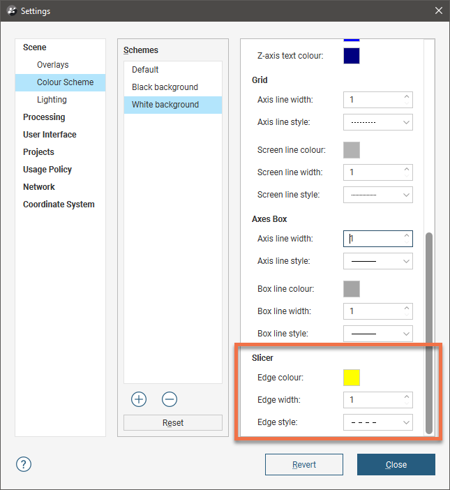

In Scene > Colour Scheme, you can change the slicer’s outline colour and width, along with the line style used for displaying the edge of the slicer.
