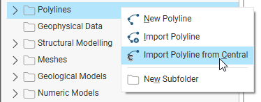

When import from Central is supported, right-clicking on a folder or data object will show an additional import option.

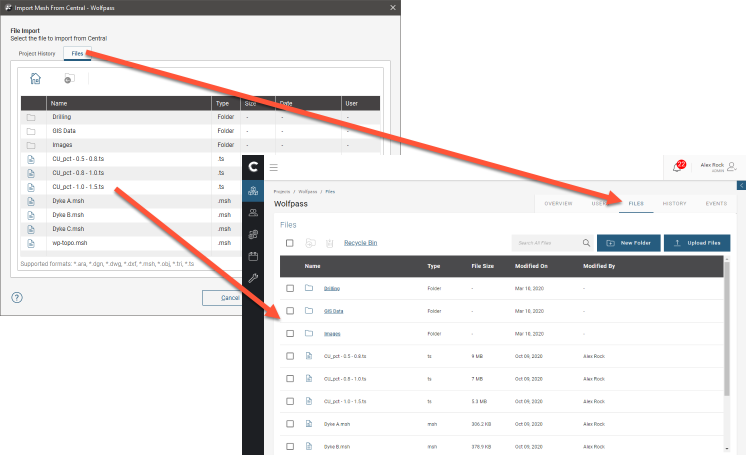

- Uploaded to the project’s files via the Central Portal. These appear in the Import From Central window in the Files tab.

To import data objects from Central, first make sure you are already connected to Central. Then right-click on the folder for the data type you wish to import and select the Import From Central option. In the window that appears, select one of the projects in the repository.

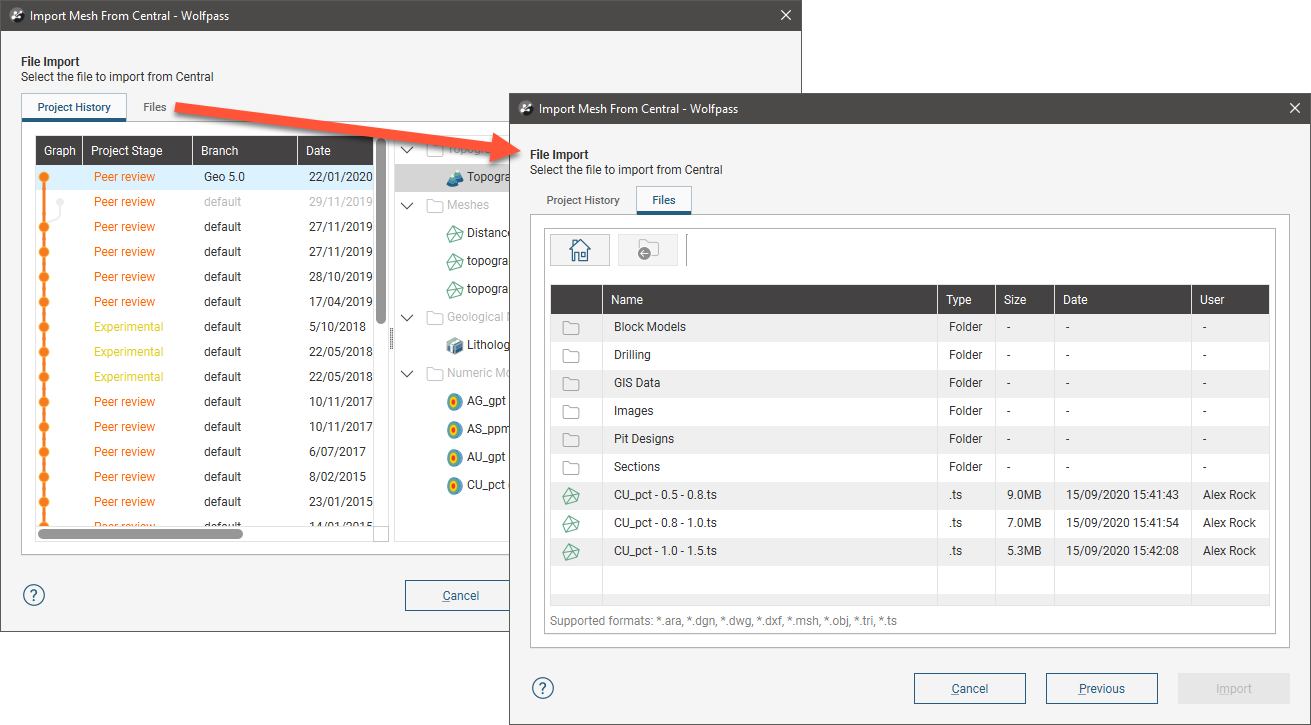

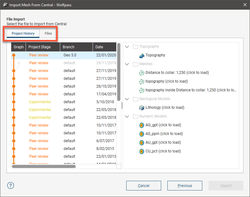

In the next window, there are two options, the Project History tab and the Files list:

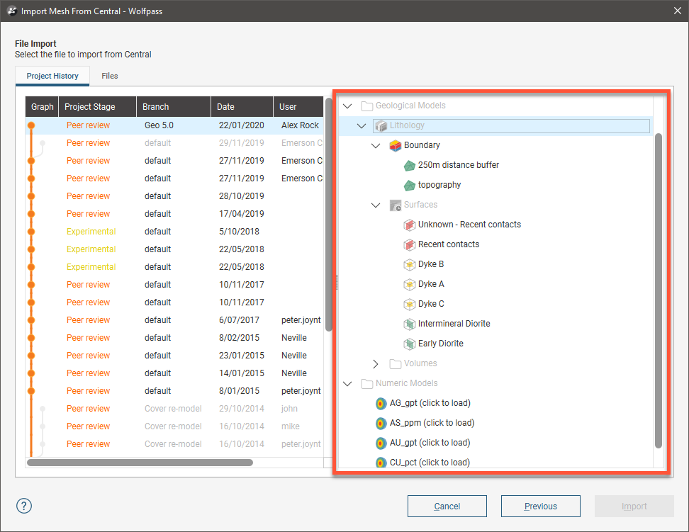

In the Project History tab, select a revision to view its published objects, then click on a model to load its list of objects. The list displayed will depend on the type of data object you are importing. Here, the surfaces in the project are displayed:
The Files tab shows any files that have been uploaded to the Central project’s files:

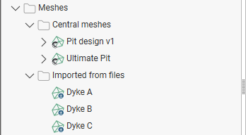

Whether you wish to import data from a revision or from a Central project’s files, use the Shift and Ctrl keys to select as many objects as required. Click Import to import the objects, which will be saved into the project tree. Objects imported from Central are displayed using a different icon. For example, here the meshes in the Central meshes folder are marked with the Central logo (
), whereas the meshes in the Imported from files folder are not (

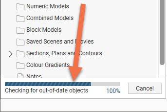

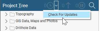

When your project contains objects imported from Central, you can check whether or not updates to those objects are available. To do this, click the button at the top of the project tree and select Check For Updates:
Progress will displayed at the bottom of the project tree:

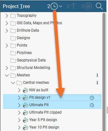

Once the check is complete, the number of objects that updates are available for is indicated in the project tree title bar. Click on the button to highlight each of the out-of-date objects in the project tree:

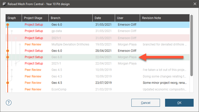

When you select Reload From History, the colouring of each entry in the project’s history indicates whether or not that object is available in a revision:
- The revision highlighted in green is the one you currently have in your project.
- Revisions in white are those that have a copy of the object you’re reloading.
- Revisions in red do not have a copy of the object you’re reloading.
- The revision highlighted in blue is the one you have currently selected, which will be reloaded if you click OK.
For example, here the revision currently in the project is the one published on the Geo 6.0 branch on 22/04/2021, highlighted in green:
The revision on branch 2021r1 dated 31/05/2021 does not have a copy of this mesh and so is highlighted in red. All revisions in white have a copy of this mesh, and clicking OK will load the copy of the mesh from the Geo 6.0 branch published on 31/05/2021, highlighted in blue.
