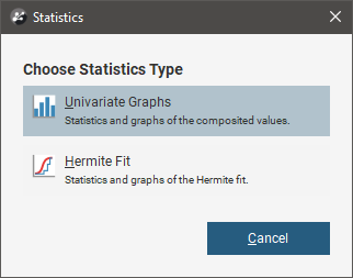

Statistics are available on the transformed values by right-clicking on them and selecting from the Choose Statistics Type options:

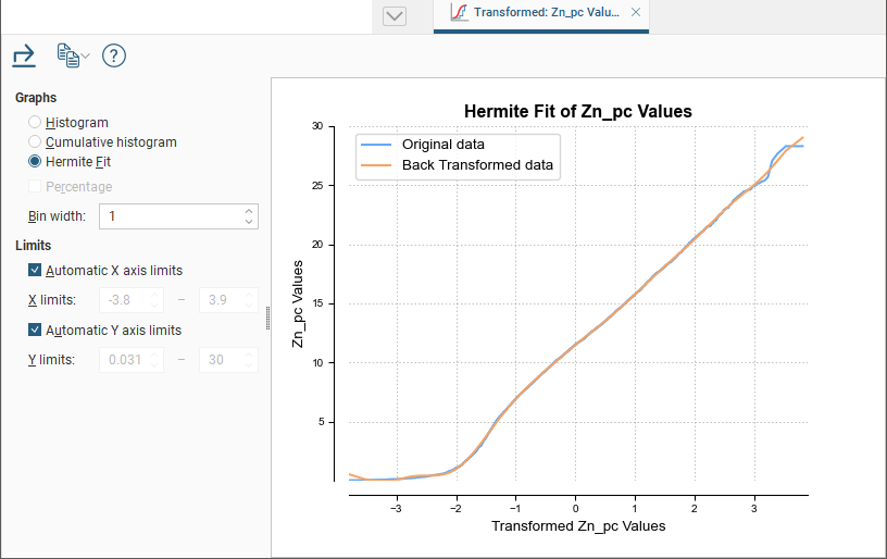

The standard Univariate Graphs option provides a histogram and other related plots of the transformed data. An option specific to transformed values, the Hermite Fit graph, has been added to show the fit of the Hermite polynomial to the cumulative distribution of the raw data.

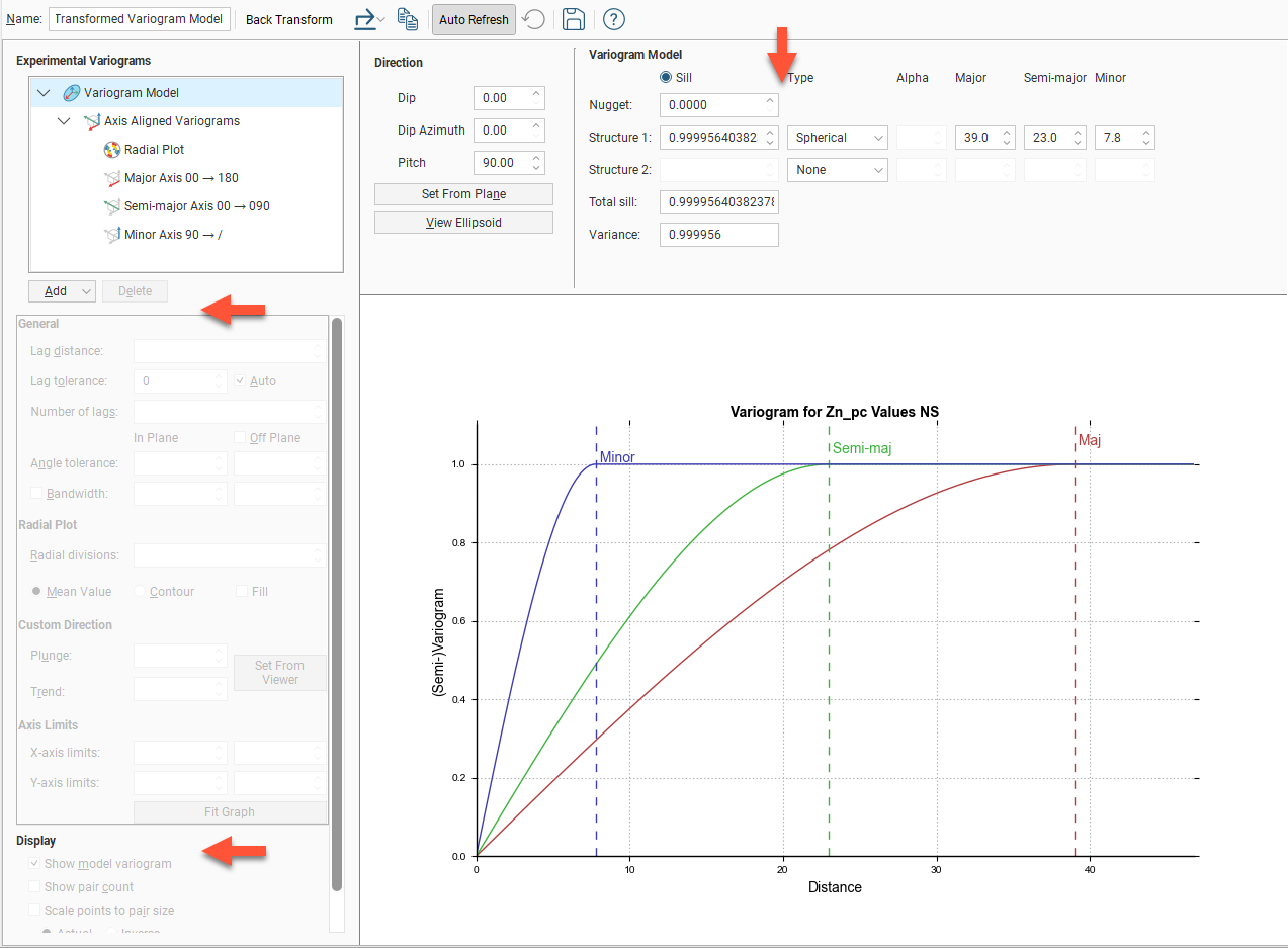

Creating a New Transform Variogram
Create a new transform variogram model by right-clicking on the Spatial Models folder and choosing the New Transformed Variogram Model option.

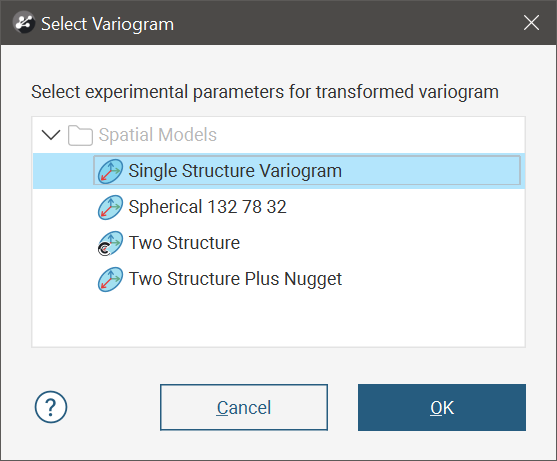

If multiple variogram models exist in the domain, a dialog will appear asking you to select which variogram model to use to obtain the experimental parameters for the new transform variogram model:

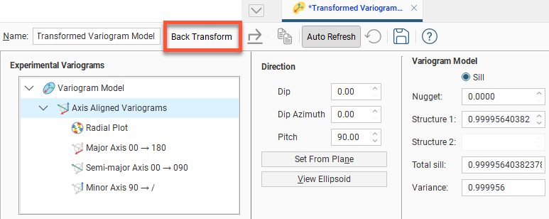

Once the new transformed variogram model has been created, you can perform variography and fit a variogram model as you would for a typical variogram model. As for the typical variogram, there is no automated fitting for the transform variogram. Note that:
- Capping has been removed.
 - There is no normalised sill option.
 - Variogram displays other than the semi-variogram are unavailable.
Viewing the Back Transformed Variogram

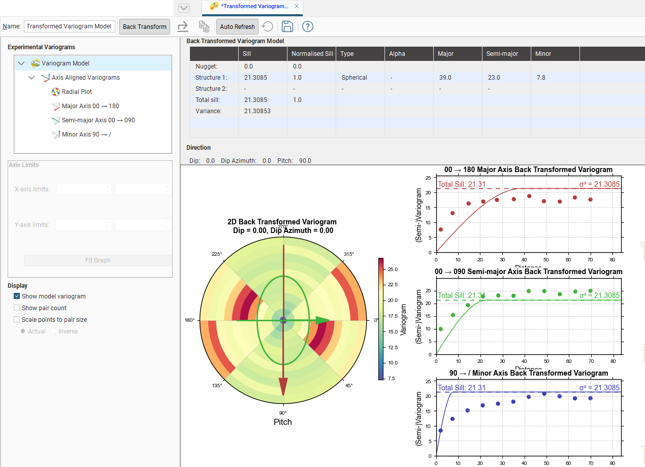

Once the model has been fitted to the transform variogram, click the Back Transform button to view the variogram model back transformed to raw data units. This is the model that will be used in any subsequent estimation.
When in this view, the variogram model cannot be manipulated by directly editing fields or using handles. A summary of the variogram parameters and orientation is provided in fixed text fields at the top of the window, with the sill and variance information back-transformed into the raw data space. Go back to the transformed view to edit the model.

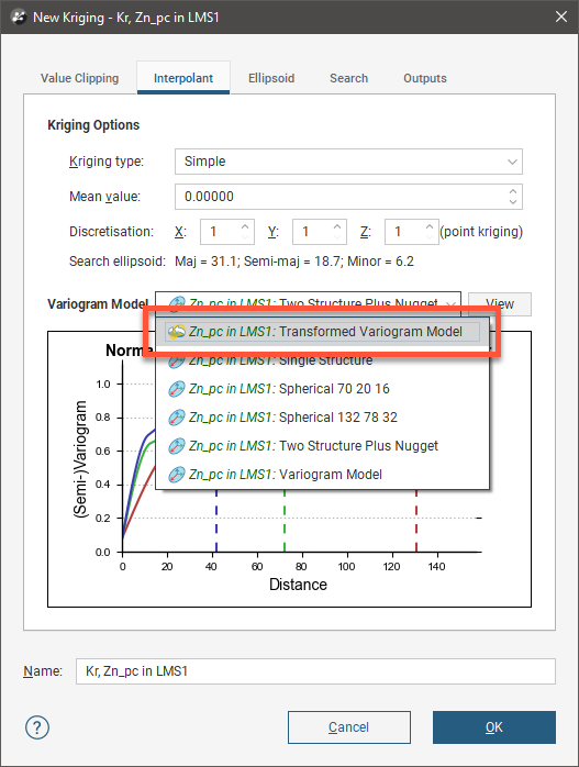

The transformed variogram model is not available for use in Kriging as the relative nugget and sills of the model in transformed space are generally considered optimistic. Instead, the model is automatically back-transformed into the raw data space, where the back transformed variogram model can be selected for use in Kriging, just like any of the untransformed models.
