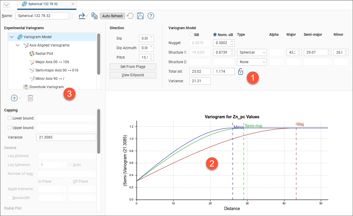

The Variogram Model window is divided into three parts:
Variogram model controls for adjusting the variogram model type, trend and orientation. See Experimental Variography and Variogram Models below. |
Graphs plotting the selected variogram |
Experimental controls for verifying the theoretical variogram model. See Experimental Variography and Variogram Models below. |

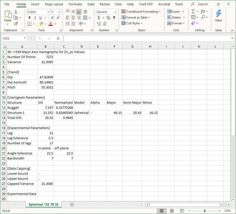

Additionally, you can save variogram parameter data by selecting a theoretical variogram from the list, clicking the Export button (
) and selecting Export data from the options. Note that Export data is not available for the experimental variogram or the Radial Plot.

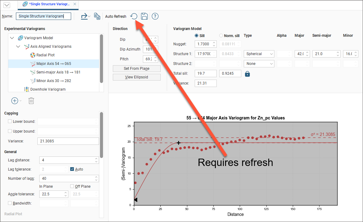

There are two buttons for refreshing the graphs when changes are made:
- When Auto Refresh is enabled, recalculations will be carried out each time you change a variogram value. This can produce a brief lag.
- When auto refresh is disabled, you can click the Refresh button (
) whenever you want the graphs to be updated. This is the best option to use when working with a large dataset.
If auto refresh is disabled and values have been changed without the graphs being updated, the chart will turn grey and a reminder will be displayed over it:
