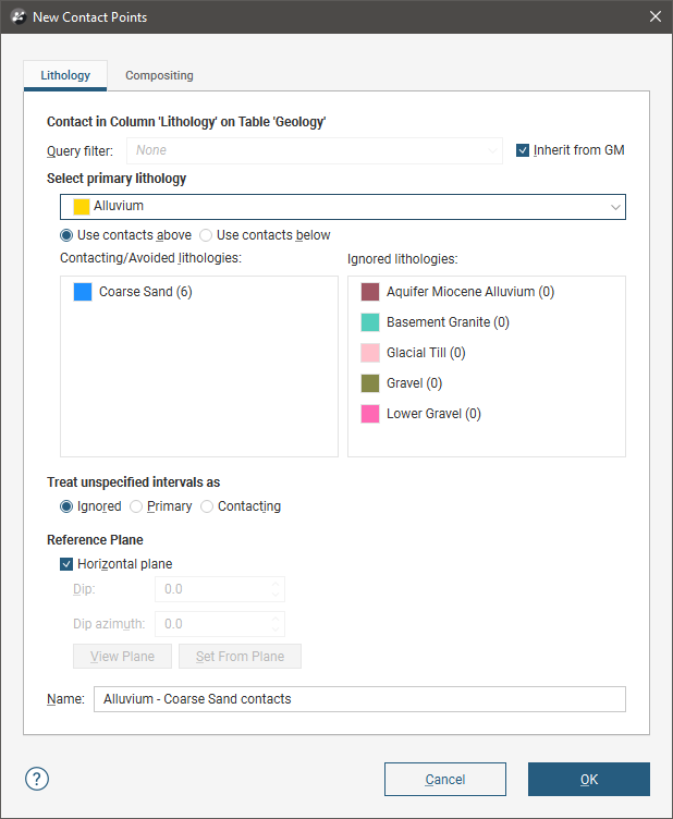

Selecting the From Base Lithology option opens the New Contact Points window:

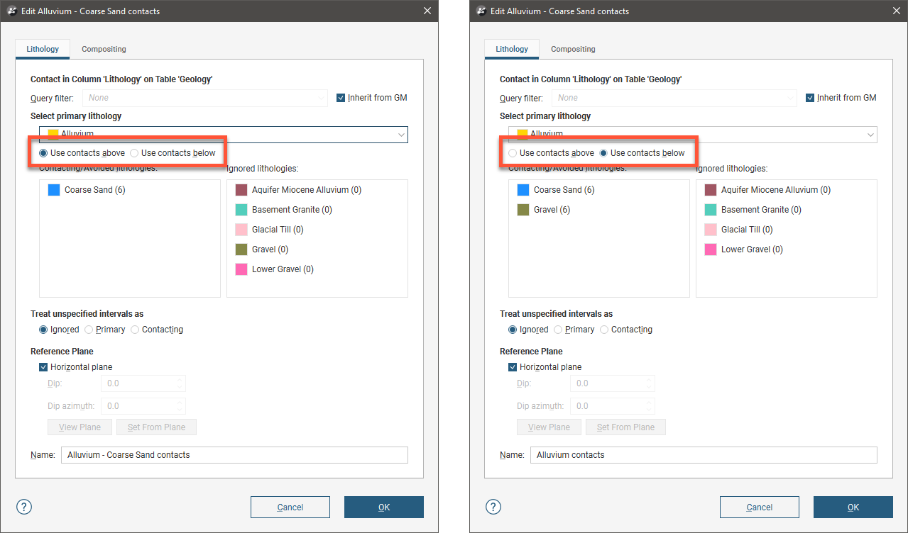

Select the lithology you wish to use to create the surface from the Select primary lithology list; this will be the older lithology (lower down) in the geological model. The Contacting/Avoided lithologies list shows the lithologies that contact the primary lithology and the number of contacts. This helps in selecting which contacts to use to create the contact surface.
By default, Leapfrog Geo will show the contacts above the primary lithology, but you can use the Use contacts below option when, for example, one lithology is interbedded with another. Here we can see that the coarse sand is interbedded with alluvium:

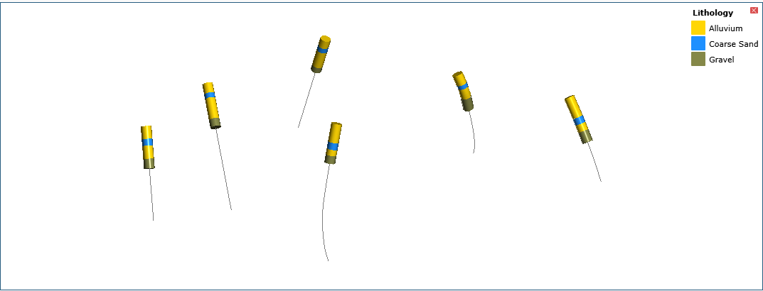

The solution to this is to create two surfaces from the Alluvium contacts, one using the contacts above (younger contacts) and the other using the contacts below (older contacts):

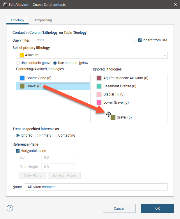

Note that the gravel contacts should be excluded for the surface created from the Use contacts below option, as we can see from the drilling data that gravel appears lower down in the model than the surface we are creating. Do this by dragging the contacts that should be excluded to the Ignored lithologies list:
Unspecified intervals are intervals that have no data. By default, unspecified intervals are ignored when creating a contact surface, but you can also treat them as the primary lithology or as avoided lithologies.

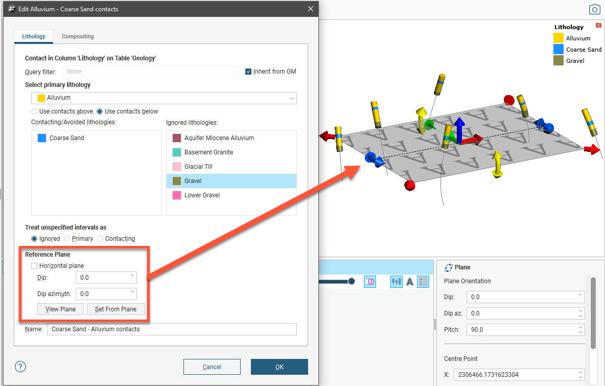

For complex geologies, the up and down directions for the surface may not be clear. If this is the case, untick the Horizontal Plane box. A reference plane will appear in the scene, with the up-facing surface labelled A and the downward-facing surface labelled B:
Controlling the position of the reference plane is similar to controlling the position of the moving plane:
Setting a reference plane for contact points is different from applying a global trend to a surface. To apply a global trend to a surface, double-click on the surface in the project tree and click on the Trend tab. For more detailed information on setting a global trend, see the Setting a Global Trend topic.
Data can be composited at the drillhole level or on a surface-by-surface basis. To composite the data used to generate the contact surface, click on the Compositing tab. See Category Composites for more information.

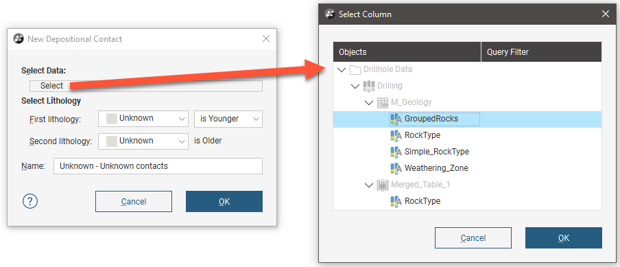

Creating deposit and erosion contact surfaces using the From Other Contacts option is useful when you have created an additional lithology column as part of correcting and working with the drilling data or wish to make use of lithology data in another drilling dataset. For example, if when building a geological model it becomes apparent that changes need to be made to the drilling data, you can import additional data or create a new column using the split lithology, group lithology or interval selection tools. See Splitting Lithologies, Grouping Lithologies and Selecting Intervals for more information.
The process is similar to creating a surface from the base lithology column, but you must first select the lithology column you will use:
Select the First Lithology and Second Lithology, if known. Click OK. The New Contact Points window will appear. Assign the Primary lithology, Contacting/Avoided lithologies and the Ignored lithologies. These can only be selected from the model’s base lithology.
The rest of the process is similar to defining a contact surface from the base lithology. See Creating Deposits/Erosions From the Base Lithology above for more information.

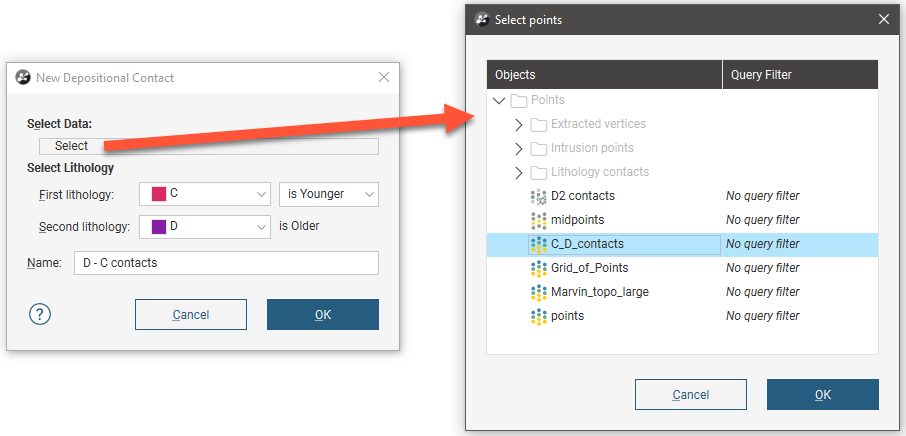

If suitable lithology data is not available, deposits and erosions can be created from other data in the project, such as GIS data, structural data, points, polylines and surfaces. The steps for creating deposits and erosions from other data are similar, regardless of the data used to create the surface:
- Right-click on the Surface Chronology and select one of the data types from the New Deposit/Erosion menu.
- Select the data object that will be used to define the surface. This must already be in the project, unless you are using a polyline, in which case you are given the option to create a new polyline.
- Select the First lithology and Second lithology. These are the lithologies that will be assigned to each side of the contact surface. The lithologies you can choose from are those defined for the geological model in the Lithologies object (see Geological Model Lithologies).
- Set whether the First lithology is older or younger than the Second lithology. Leapfrog Geo will, by default, put the younger side of a contact surface up, but this can be changed later.
Here, a points data object is being used to create a deposit:

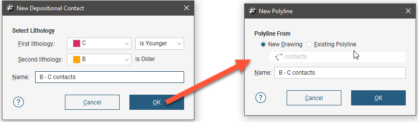

For polylines, you first set the lithologies and the younging order, then click OK to move on to the next step:
You can draw the polyline in the scene directly by selecting the New Drawing option. You can also use any polyline in the project by selecting the Existing Polyline option. You can then select the required polyline from the list.

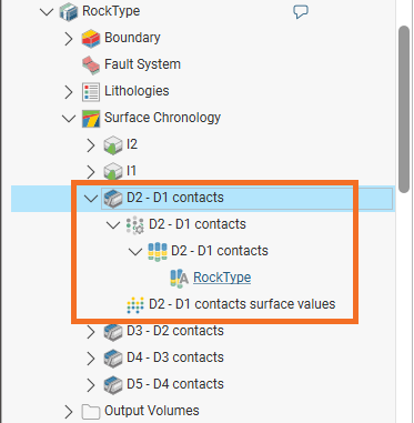

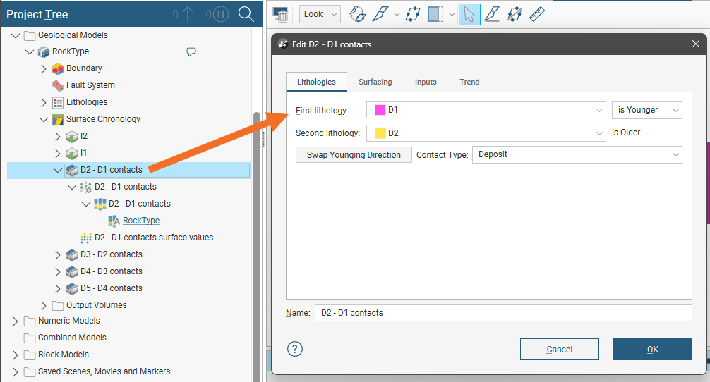

Deposits/Erosions in the Project Tree
The name Leapfrog Geo automatically assigns to a deposit or an erosion is the lithologies assigned to each side of the surface. In the project tree, expand the surface to see how it was made:

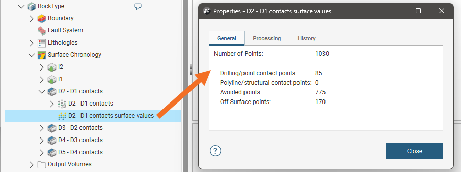

The surface shown above has been derived from lithology data and so the input is the contact points (
). Also shown as part of the contact points are the lithology data the points are derived from (
) and the surface values (
). The surface values are the input points used in generating the contact points and are divided into four categories:
- Drilling/point contacts. These are the contact points derived from lithology data and are equivalent to the contact points (
). - Polyline/structural contacts. These are derived from polylines or structural data, if any have been added to the surface.
- Off-surface points. These points are generated in determining the surface’s orientation and so dictate where the final contact surface will lie.
- Avoided points. These points are used to determine where the contact surface should not go.
The Properties window for the surface values object (
) shows how many of each type of point have been derived:
These surface values can be displayed in the scene by category, which can help in understanding how the different types of input data are influencing the surface.

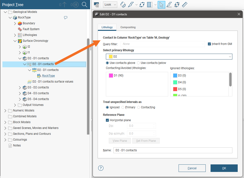

Double-click on the surface (
) to edit it; this opens the Edit window for the surface:
Double-click on the contact points object (
) to edit the lithology and change compositing parameters.

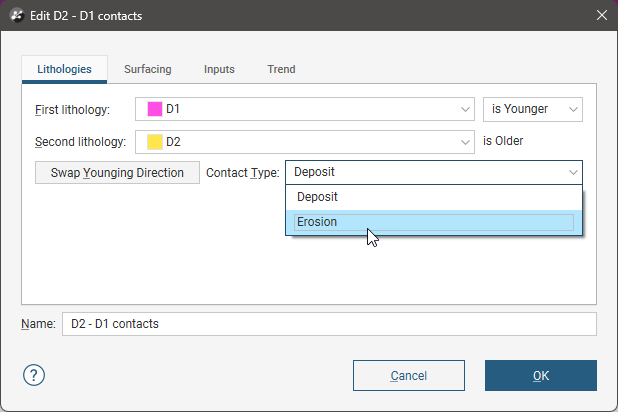

If you are unsure whether to model a surface as a deposit or as an erosion, you can make a copy of, say, a deposit surface and easily change it to be an erosion surface. To do this, double-click on the surface in the project tree and in the Lithologies tab, change the Contact Type:
Refining Deposits and Erosions
You can refine deposits and erosions in several ways:
- Edit the surface using structural data. Right-click on the surface and select Edit > With Structural Data. This option is available for deposits and erosions created from lithology data and other data in the project, but not for offset surfaces. See Editing Surfaces With Structural Data for more information.
To edit the surface’s settings, double-click on it in the project tree. In the Lithologies tab, change the lithologies assigned to each side of the surface, if required.
You can swap the younging direction if the direction was assigned incorrectly when the surface was created. The change will be reflected in the scene. Note that changing the younging direction does not change which lithology is older or younger.

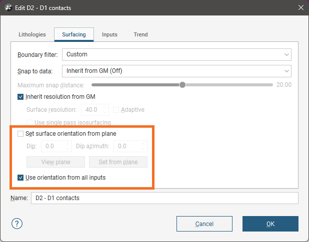

Setting the Surface Orientation
For surfaces derived from lithology data, there are two additional settings in the Surfacing tab, Set surface orientation from plane and Use orientation from all inputs.
These settings relate to the generation of the off-surface points that are used in determining the surface’s orientation.
The Set surface orientation from plane option may be useful if available lithology data is sparse or contains inconsistent orientation information.
The Use orientation from all inputs setting is only available when the surface also includes polyline and/or structural data.
- When this setting is disabled, only the information from the polyline/structural data will be used in generating off-surface values.
- When this setting is enabled, both drilling contacts and polyline/structural data will be used in generating off-surface values.
Use orientation from all inputs was introduced in Leapfrog Geo 2023.2. New surfaces are created with this setting enabled by default. However, when existing geological models with deposits/erosions are upgraded in Leapfrog Geo 2023.2 or later, the Use orientation from all inputs setting will be disabled in order to preserve the surface’s pre-upgrade settings.
