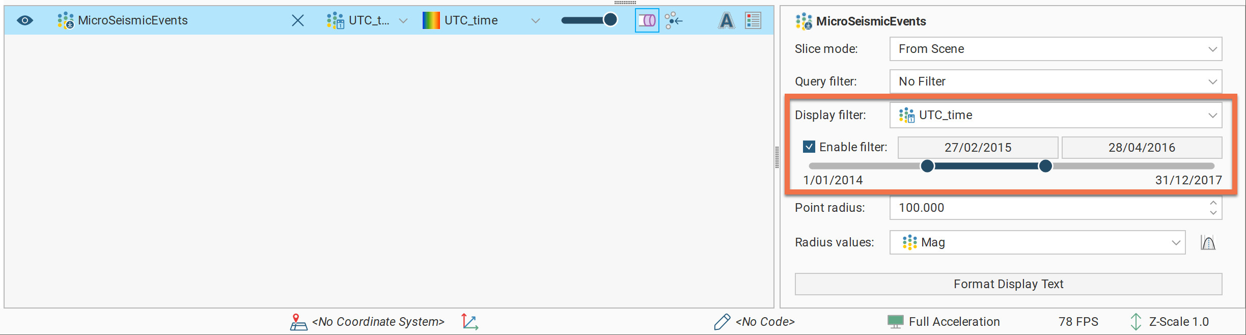

Time-dependent points can be filtered in the scene by another numeric column, e.g. a time or date column. This enables, for example, micro-seismic data to be visualised over time using a range slider. To view data in this way, click on the points table in the shape list, then select a time or date column as the Display filter in the properties panel:
Next tick Enable filter and either click the date buttons to set the upper and lower limits or use buttons on either end of the slider.

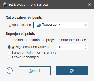

You can set the elevation for points tables by projecting them onto a surface. This overwrites elevation values in the z column of the points table, using the data from the selected surface. If the surface does not intersect vertically with all points, you can choose how the z values for those unprojected points will be handled.
To set the elevation for points from a surface, right-click on the points object in the project tree and select Set Elevation. The Set Elevation window will appear:
Next, select how unprojected points should be handled. There are three options:
- Leave elevation values empty clears the z values for all unprojected points.
- Leave unchanged makes no changes to the z values for unprojected points.

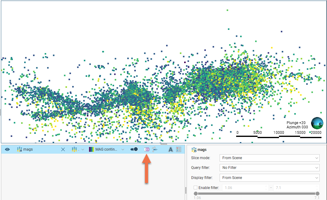

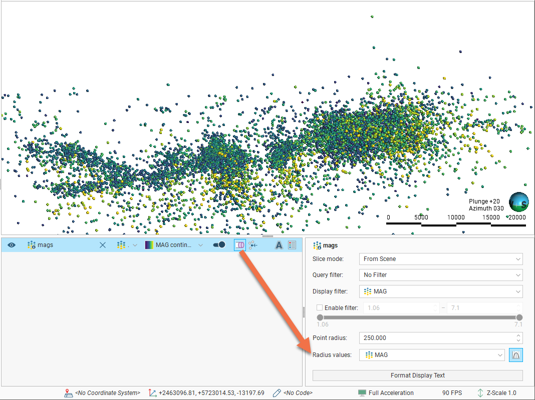

As with drillholes, points data can be displayed as flat points or as spheres. When Make points solid button (
) is enabled for points data, the data points are displayed as spheres. Here, the values are displayed as flat points:
You can restrict the range of values displayed using the Display filter in the properties panel.
When using the spheres option, the points can be displayed using the values from any column in the points table. To do this, select a column from the Radius values list in the properties panel:
The Point radius setting then determines the maximum point size displayed in the scene.
