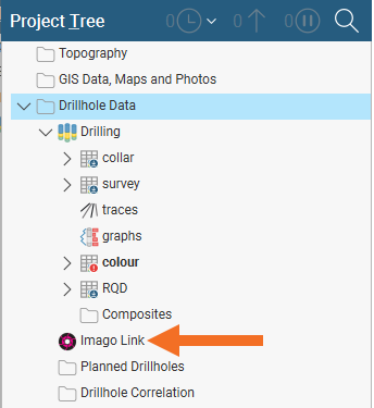

A link will appear in the project tree as part of the Drillhole Data folder:
You can double-click on this link to edit the Imago integration settings.

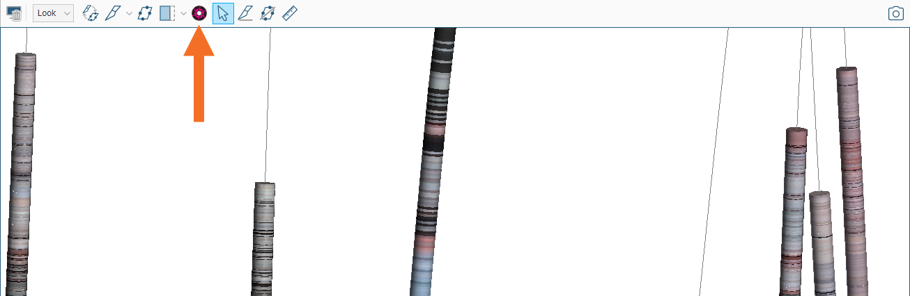

An Imago button (
) will also appear in the toolbar:

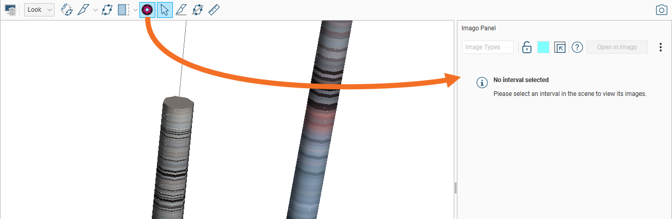

Clicking on this button will open the Imago Panel:
An Overview of the Imago Panel

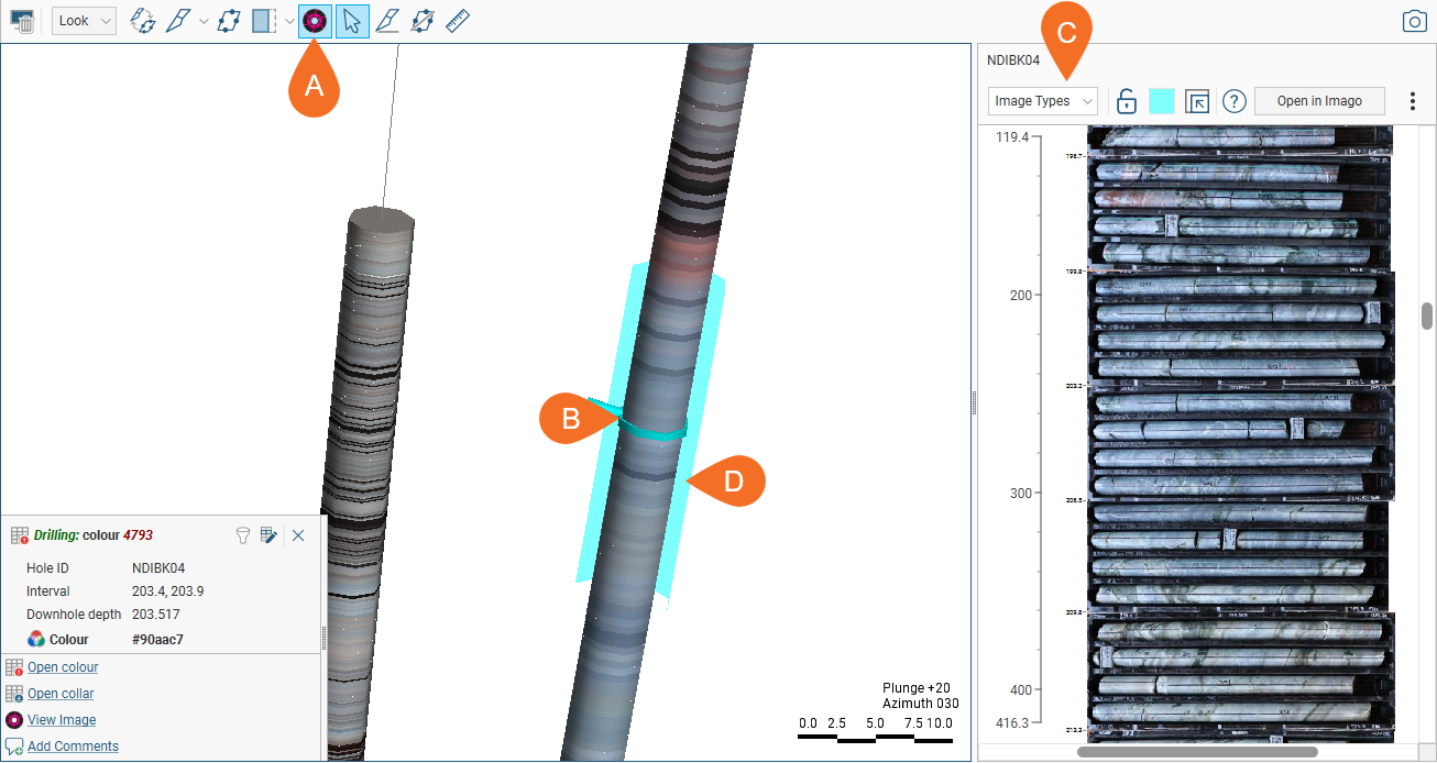

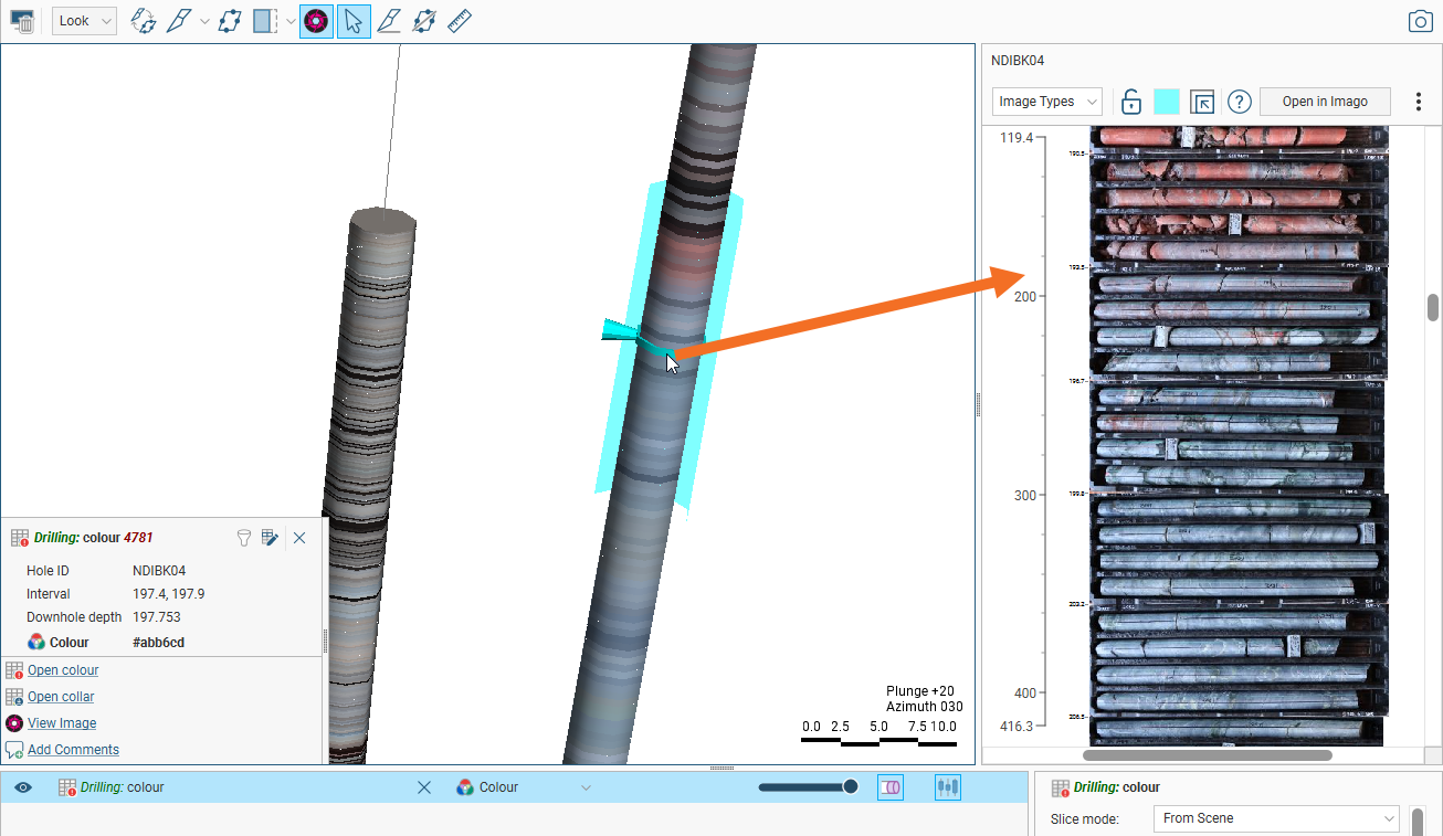

Click on the Imago button (
) in the toolbar (A), then on a drillhole interval in the scene (B) to display Imago imagery for that interval in the docked panel alongside the scene (C). The scene highlight (D) shows the part of the drillhole that corresponds to images in the panel.
The scene highlight is open toward the viewing angle in order to avoid impeding viewing the drillhole data associated with the core imagery. The scene highlight colour and other properties can be customised, which is described in Changing the Scene Highlight Properties later in this topic.

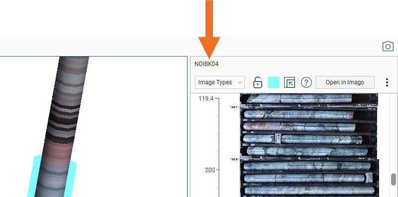

Note that the drillhole ID is displayed at the top of the panel:
Depth information is displayed on the ruler in the panel. To view imagery at a particular depth, click on the ruler at that depth.

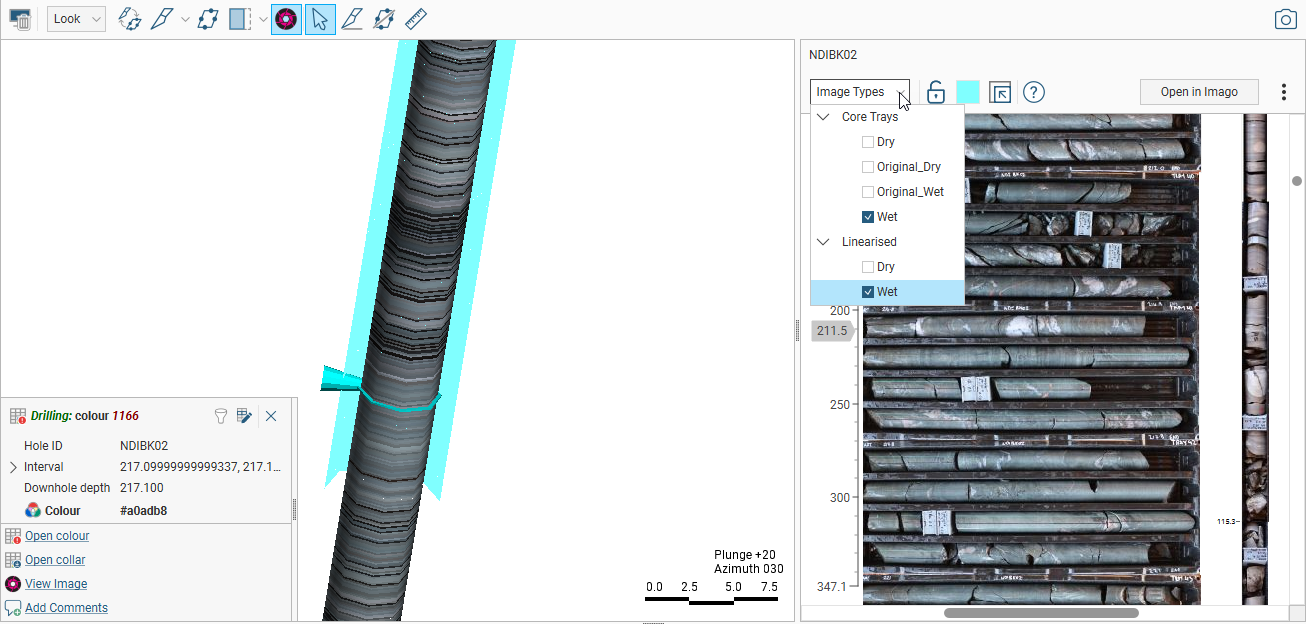

From the Image Types list, you can see all the imagery available for that drillhole that matches the search criteria set in the Imago Settings window. For example, here both core tray images and linearised images are displayed for a drillhole:

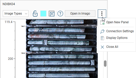

The panel has an overflow menu (
) that contains more Imago streaming settings:
If an image type you expect to see is not listed, you can check your Imago settings by clicking on the overflow menu and selecting Connection Settings. This opens the Imago Settings window.

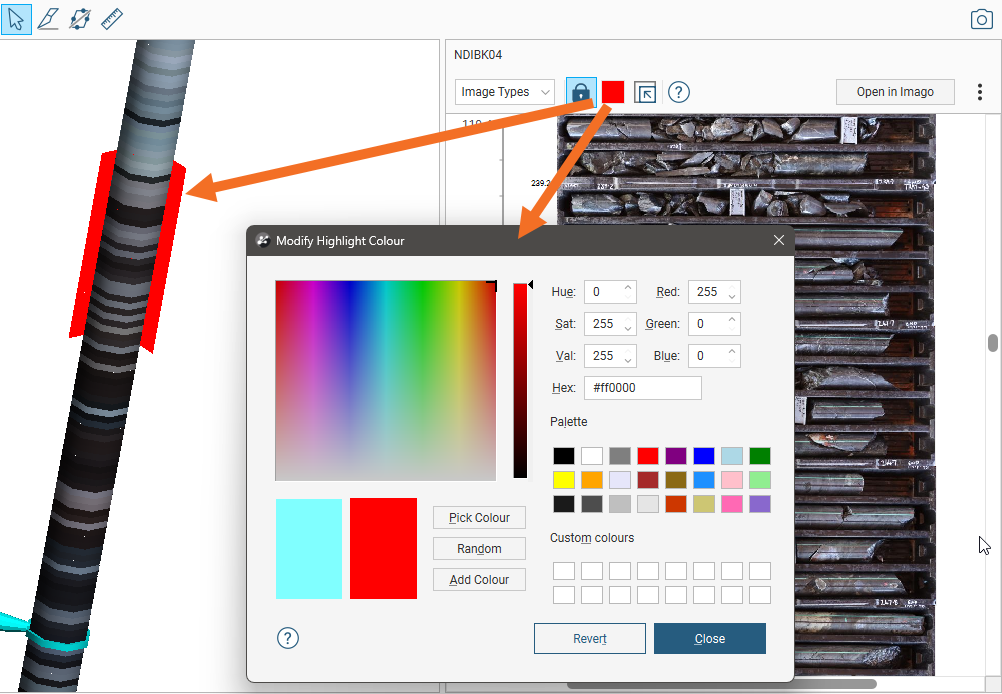

Click on the colour chip to change the colour used for the scene highlight:

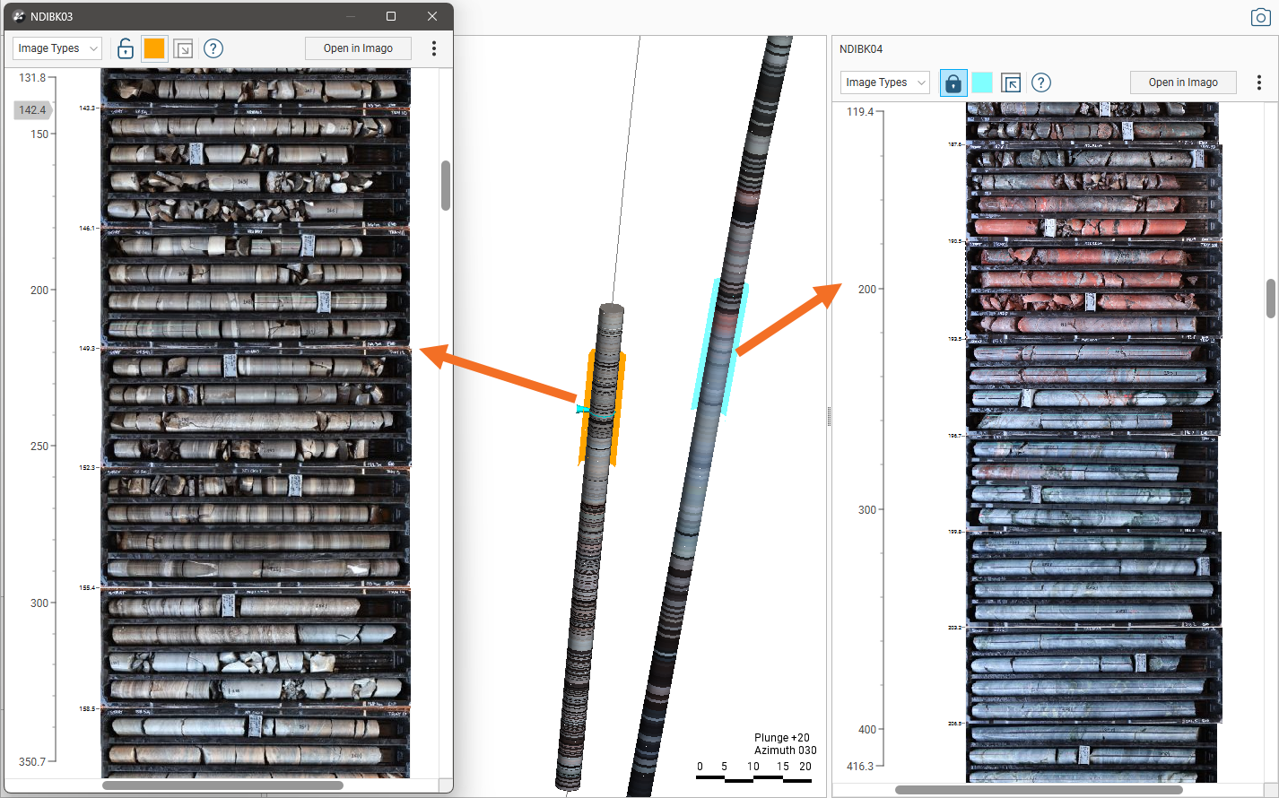

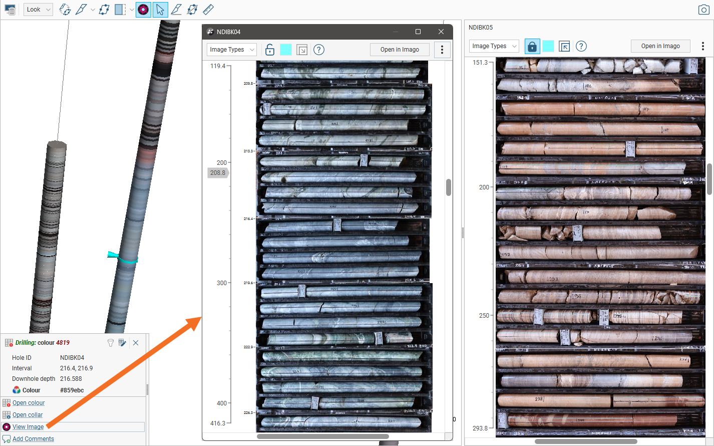

Changing the colour of the scene highlight is useful when displaying imagery for multiple drillholes, which is the case here where the scene highlight is blue for the docked panel and orange for the undocked panel:

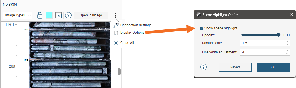

Additional scene highlight properties can be changed by selecting Display Options from the overflow menu:
These settings apply to all scene highlights, whereas the colour setting applies only to the scene highlight for that panel.
Working in Multiple Panels
The panel can be used docked (
) or undocked (
). You can also open multiple panels, although only one panel can be docked at a time.
To open a second panel, lock the first panel. This prevents different imagery from being displayed in first panel when you click on other drillholes in the scene.
Next, click on an interval in the scene. The View Image link in the scene details panel opens a new Imago panel with imagery loaded for that drillhole:

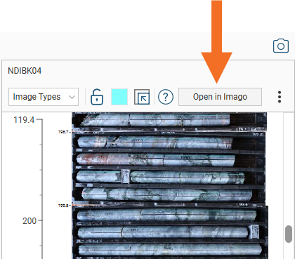

Opening Imagery in Imago
To open imagery in the Imago Portal, click the Open in Imago button at the top of the panel:
This opens the Imago Portal in your default web browser. You may need to sign in.
