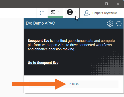

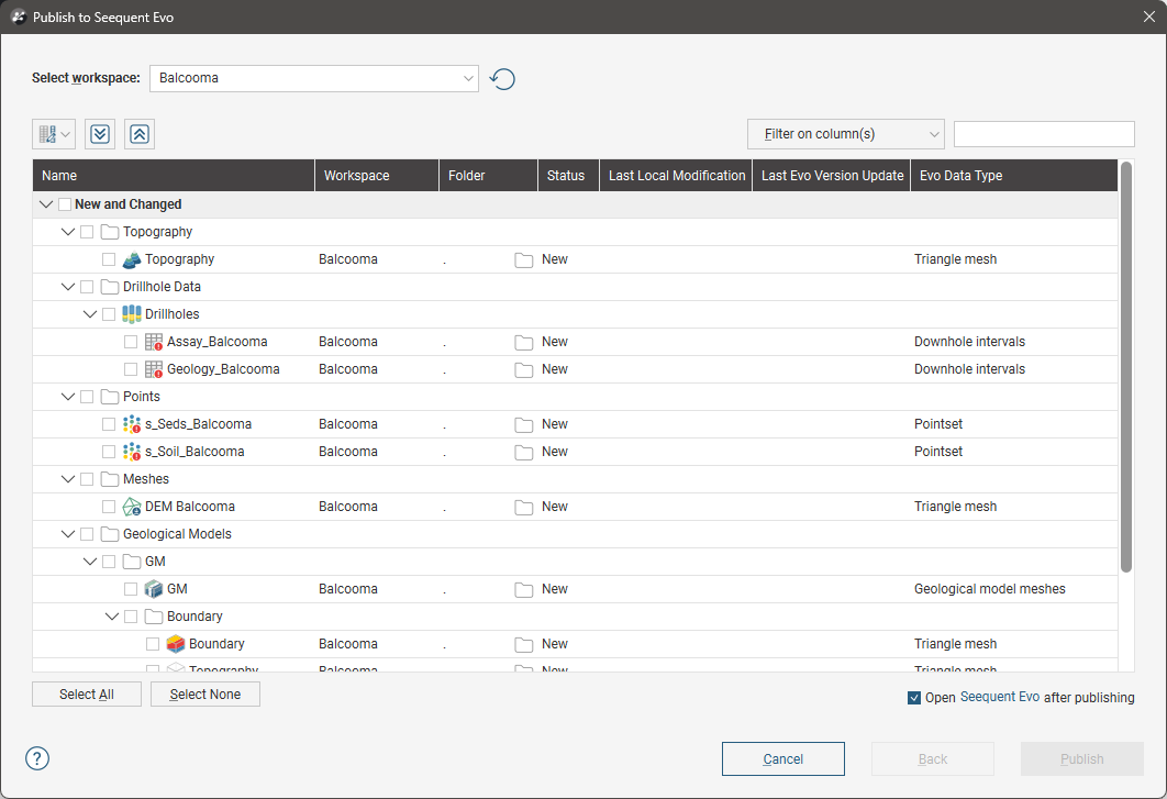

Not all data objects in a Leapfrog Geo project can be published to Seequent Evo. The easiest way to find out what objects in a project can be published to Evo is to click on the Evo menu next to the user ID menu and then click Publish:
This opens the Publish to Seequent Evo window, which lists all the objects in the project that can be published to Evo along with their Evo data type:
You may need to select an Evo workspace before you can scroll through the list, and if a workspace you expect to see is not listed, click the Refresh button (

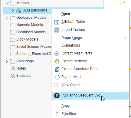

Right-click on individual objects in the project tree to find out if an object can be published to Evo. The Publish to Seequent Evo option appears for those that can:
If you right-click on a project tree item and Publish to Seequent Evo does not appear in the menu, it is not an object that can be published to Seequent Evo.

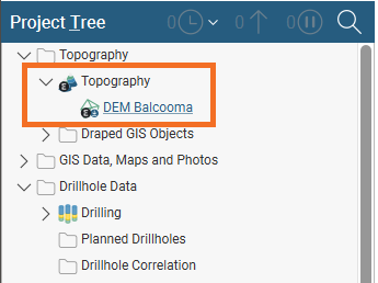

Objects in a project that have already been published to Evo are indicated in the project tree using an Evo badge, which is the case for the Topography and DEM Balcooma objects here:

- From the Evo menu next to the user ID menu. With this method, you can bulk publish all objects in the project that can be published to Evo. To do this, click on the Evo menu and then click Publish. This opens the Publish to Seequent Evo window, listing all the objects in the project that can be published. None of the objects will be selected.

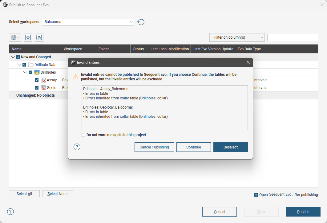

Invalid Data Entries
If any of the objects selected for publishing contain invalid entries, a warning will be displayed listing those objects. For example, here there are tables in a drilling dataset that contain invalid entries:
This warning does not mean that those objects cannot be published to Evo, but if you do go ahead with publishing those objects, the invalid entries in those tables will not be included.
If selected data objects contain invalid entries, you can:
- Cancel Publishing. Choose this option if you wish to correct errors in the data. This closes the Publish to Seequent Evo window without publishing any objects.
- Continue. Choose this option if you are satisfied with going ahead with publishing the selected data objects without the invalid entries. The warning window will be closed without closing the Publish to Seequent Evo window. You can then continue with publishing the selected objects.
- Deselect. Choose this option if you decide not to publish the objects that have invalid entries. The warning window will be closed without closing the Publish to Seequent Evo window but objects that contain invalid entries will be deselected. You can then continue with publishing the selected objects.

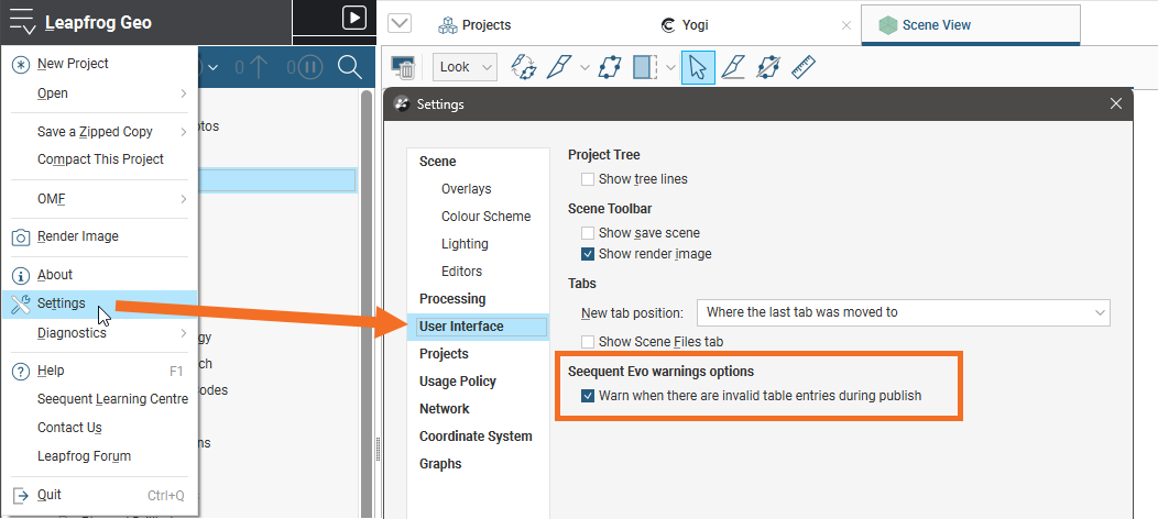

If you no longer wish to see this warning in the currently open Leapfrog Geo project, enable the tickbox. If you later decide you want to see this message when publishing data objects that contain invalid entries, you can enable it via the Settings window. Click on the Leapfrog Geo menu, select Settings, then click on the User Interface tab:

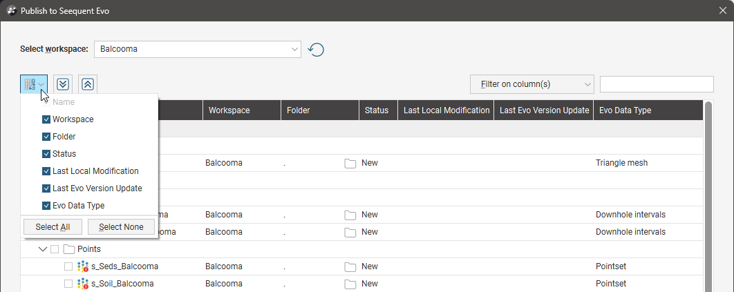

Filtering and Selecting Objects
With the column button (
), you can choose which columns appear in the table, which can assist in selecting data to publish when the project contains a lot of data.
The expand all (
) and collapse all (
) buttons above the list and the expand (
) and collapse (
) buttons in the list are useful for finding specific items, especially when there are a lot of objects that can be published or if you’re focusing on publishing one type of object.

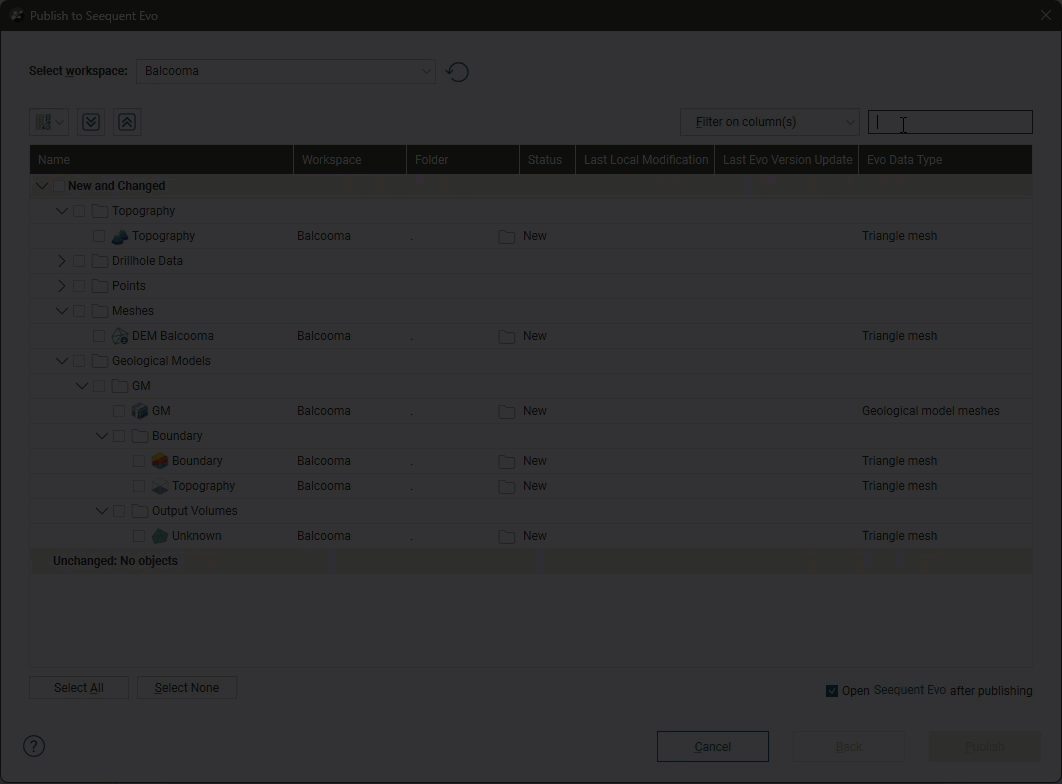

You can also filter the list to limit the number of objects displayed. For example, here we have used the filter to restrict the list to the term ‘mesh’, which shows all objects that include ‘mesh’ in their names or whose Evo data type contains ‘mesh’:

You can choose which columns are used to filter the list by clicking on Filter on columns. When no columns are selected, the filter is applied to only object names, which is why the first filter applied returns no objects. Then when the Evo Data Type column is selected, the data types with ‘mesh’ in their names are listed:
Note that filtering out objects in this way does not deselect them, if they were selected before the filter was applied. The actual number of selected objects will always be displayed below the list. For example, the list has been filtered to show only two objects but 8 are selected:

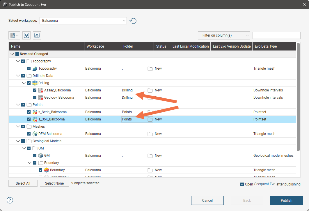

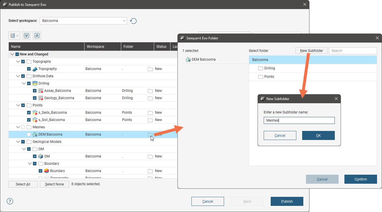

Organising Data Into Folders
You can specify folders to which objects will be published. For example, here, four of the objects listed will be published into two folders:
Note that once an object has been published, the folder to which it is published cannot be changed, nor can the folder be renamed.
To publish a data object to a folder, click the Folder button (
) for that object. You can also select multiple objects and add them to the same folder; to do this, select the objects, then click the button for one of them.
In the Seequent Evo Folder window, you can define the folder structure for the workspace:
If there are other objects in the workspace in existing folders, they will appear in this window and you can publish more objects to them.
Create new folders, if necessary, and choose the one you want to publish the selected data objects to.
Note that once you publish objects to Evo, you cannot change the folder they have been published to, nor can you rename folders that already contain published data. In the Publish to Seequent Evo window, such folders are shown as locked:

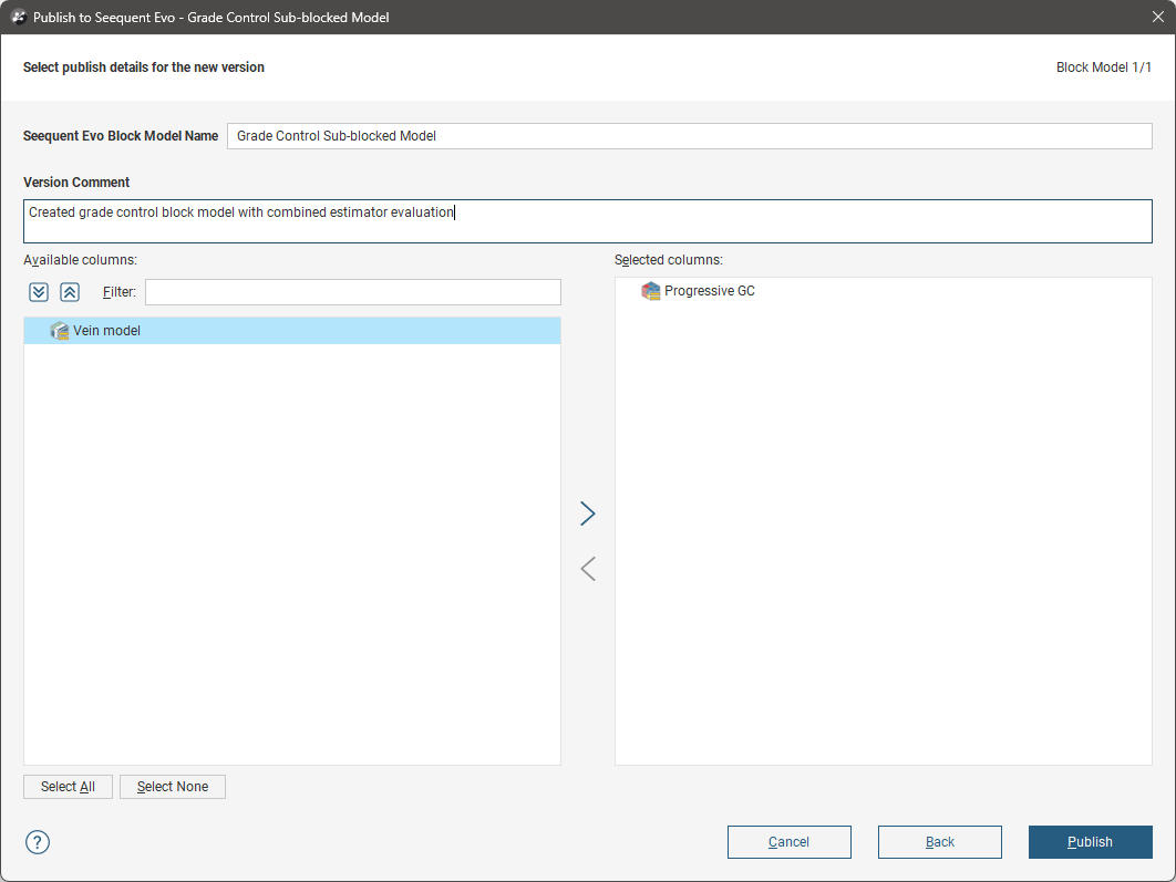

Publishing Block Models
If the list of objects you are publishing includes one or more block models, each block model will require an extra step in the publishing process. This is to assign which evaluations are to be mapped to the BlockSync block model stored in Seequent Evo.
Fore more information on publishing block models to Seequent Evo, see Publishing an Updated Model in the BlockSync integration help.

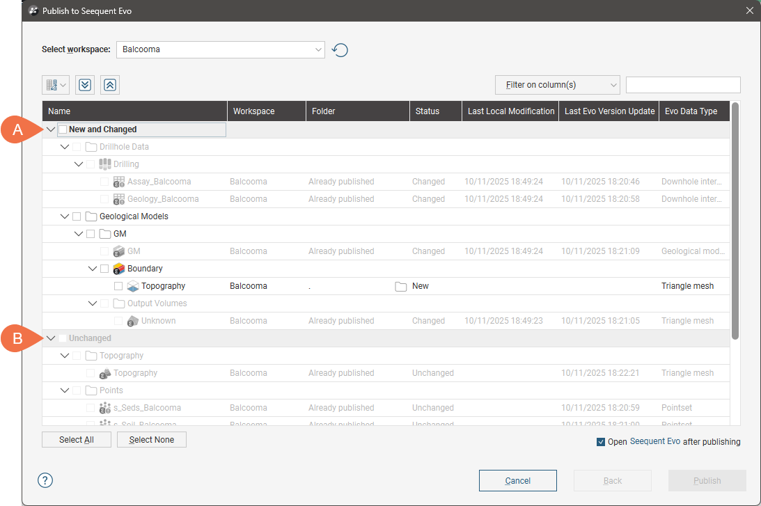

Republishing Revised Items
When you have made changes to data in your Leapfrog Geo project, those changes need to be published to Evo; they are not automatically republished when the data changes in Leapfrog Geo.
To publish changes to Evo, you can start the process using either of the methods described in Starting the Publishing Process above. When you have made changes to a lot of different data objects, it is often easier to use the Evo menu bulk publish option as that provides you with a better overview of what has changed in the project and what you might want to republish.
The Publish to Seequent Evo window categorises objects into those that have changed and those that haven’t:
New and changed objects can include:
- Objects that have been updated in the Leapfrog Geo project.
- Objects that are new to the Leapfrog Geo project.
- Objects that were previously published to Evo but have since been deleted from Evo. If this is the case, you will be prompted to publish the object as a new object. You cannot publish an ‘update’ to an object that has been deleted from Evo.
If an object has already been published to Evo, you cannot change the folder it was published into.
Select the items you wish to republish and then click Publish.
