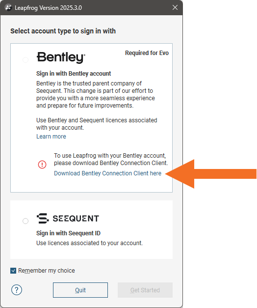

Signing in to Leapfrog Geo with a Bentley account uses the Bentley Connection Client. If you do not already have this installed when you launch Leapfrog Geo, a message will be displayed that includes a link for downloading the Connection Client:
Once the Connection Client is installed, you will be able to sign in to Leapfrog Geo using your Bentley account.

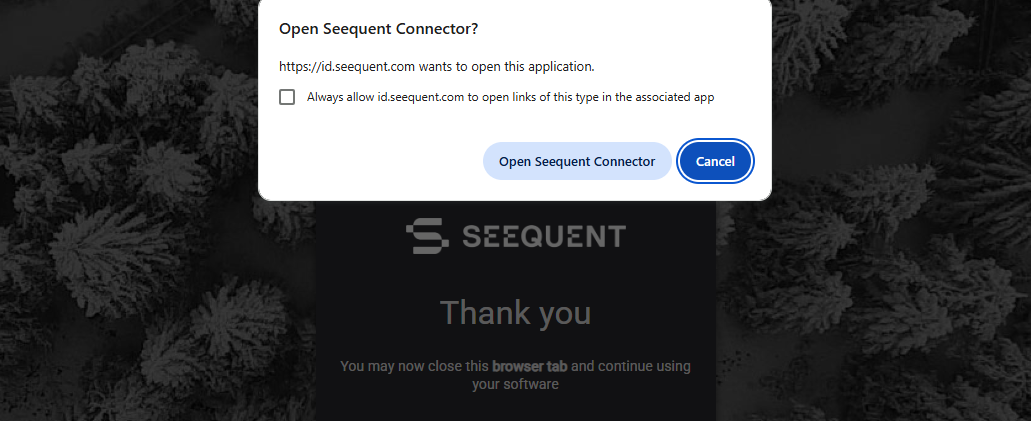

When you sign in to Leapfrog Geo using a Bentley account, Seequent Connector will still be used to manage your connection to some Seequent services. Seequent Connector will use your Bentley account credentials, but your browser may prompt you to allow Seequent Connector to run.
We recommend ticking the box to always allow id.seequent.com to open links.

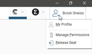

Once you have signed in using your Bentley account, you can change your permissions via the user ID menu in the upper right-hand corner of the main window:

When you launch Leapfrog Geo and sign in using a Seequent ID, a window will launch in your computer’s default browser prompting you to enter your Leapfrog Geo credentials. Follow the prompts and once you have signed in, you will be prompted to launch Seequent Connector.

Once you have signed in to Leapfrog Geo using your Seequent ID, the user ID menu in the upper right-hand corner of the main window is used to manage your MySeequent profile and your permissions:
If you are offline, options that require an internet connection will be greyed out. You can continue working in Leapfrog Geo while you are offline until your session expires. To see when this is, click on the user ID menu and select Manage Permissions. The window that appears will display the time and date when your session will expire.

If your organisation shares Leapfrog Geo seats between users, you can release your seat for other Leapfrog Geo users in your organisation when you have finished working with Leapfrog Geo. To release your seat, you can either:
  • Select the Release Seat option from the user ID menu.
  • Close Leapfrog Geo and choose the Release Seat option when you are prompted.
