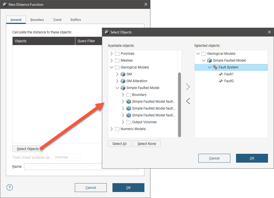

To create a distance function, right-click on the Numeric Models folder and select New Distance Function. The New Distance Function window will be displayed.
If you are unsure of some settings, most can be changed later. For a basic distance function click Select Objects to select from the suitable objects available in the project, then click on the Buffers tab to define at least one buffer so that the distance function can be visualised in the scene.

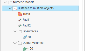

Click OK to create the distance function, which will be added to the Numeric Models folder. The new distance function contains objects representing different parts of the function, which can be expanded to show the inputs to each part of the function:
- The Trend object that describes the trend applied.
- Hyperlinks to objects used for the distance function.
- An Isosurfaces folder that contains all the meshes generated in building the distance function. In this example, two isosurfaces have been defined, at distances 2 and 4.
- An Output Volumes folder that contains all the distance buffer meshes.

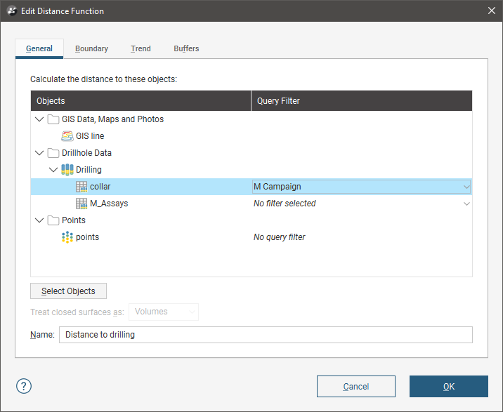

Click Select Objects to choose from the objects available in the project. For drilling data and points data, you can apply any filter that has been defined for that object. For example, here:
- A query filter has been selected for the collar table
- Query filters are available for the assay table, but none have been selected
- No query filters have been defined for the points data object
If there is no Query Filter option shown for a data object, that is because it is not possible to filter the data used for the distance function for that type of object, as is the case for the GIS line shown above.

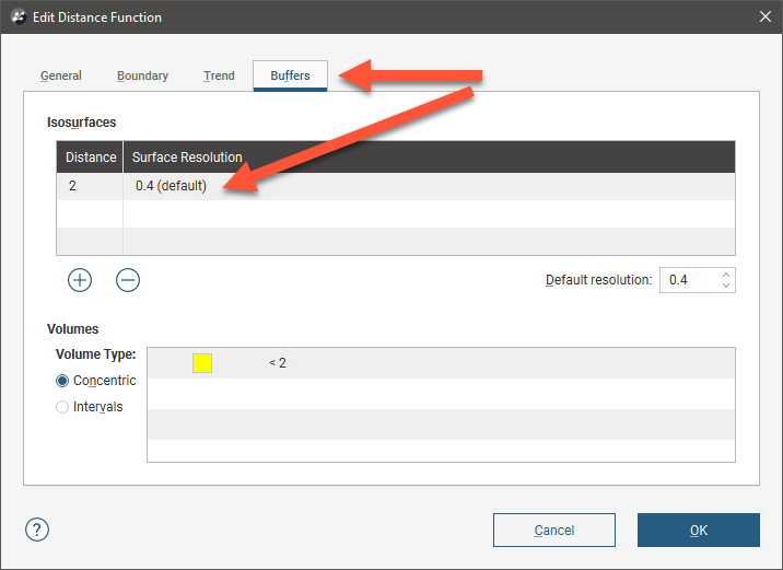

In the examples that follow, a distance function is created from a sphere and a single isosurface is defined in the Buffers tab, with its distance set to 2:
The sphere used as the basis for the distance function is coloured red on the inside and blue on the outside.
Treat Closed Surfaces as Volumes
When a surface is treated as a volume, isosurfaces are generated on the outside (the blue side) of the surface. In this example, a single isosurface (in yellow) is generated a distance of 2 away from the blue side of the sphere:

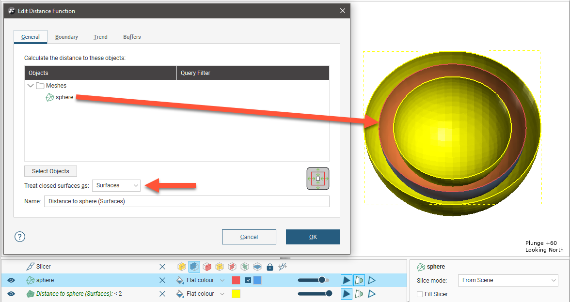

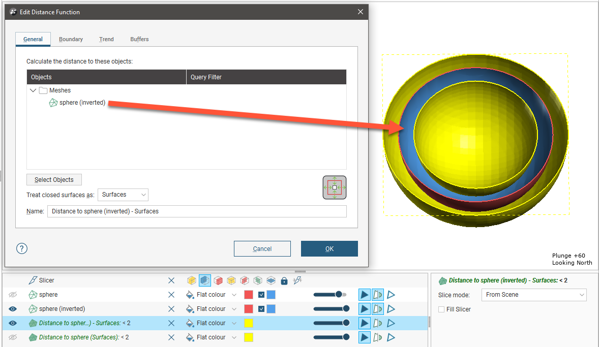

Treat Closed Surfaces as Surfaces
When the sphere is treated as a surface rather than as a volume, isosurfaces are generated on both sides of the sphere:
When the orientation of the sphere is reversed, there is no difference in the isosurfaces generated:

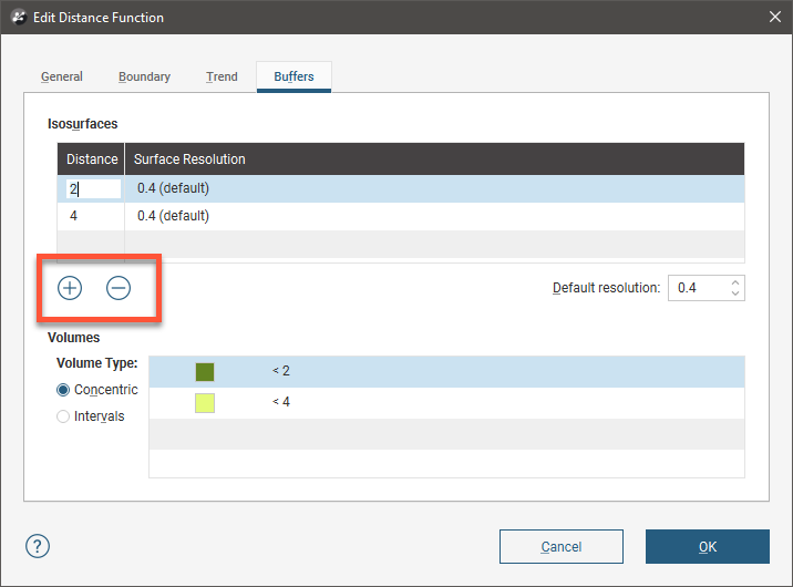

To add buffers, click on the Buffers tab, then click the Add button (
Enter the required value. To delete a buffer, click on it in the list, then click the Remove button (
). You can also change the colours used to display the buffers by clicking on the colour chips. The Default resolution setting is used for all new buffers and for existing buffers that use the default resolution.

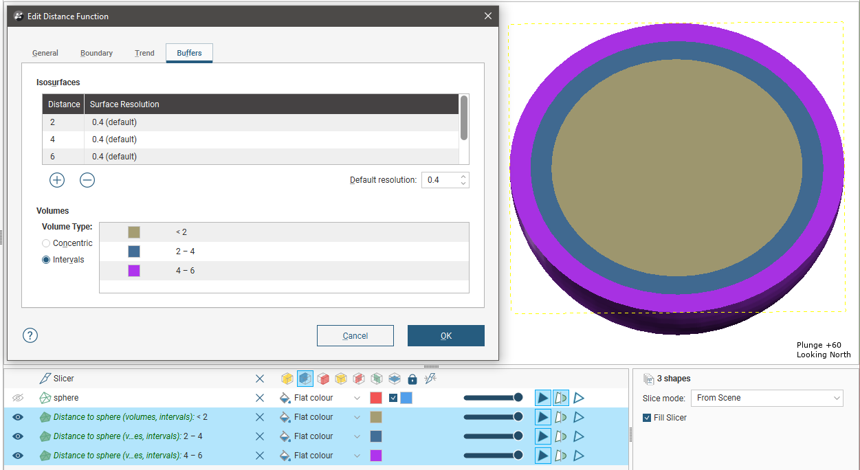

There are two options for Volume Type that affect how the buffers are calculated when more than one buffer is used. The Concentric option produces volumes that include any lower distance volumes. For example, here there are three volumes, <2, <4 and <6, and the colours used to display these volumes blend where the volumes overlap:
The Intervals option produces discrete, non-intersecting volumes. In this example, there is no overlap between the <2, 2-4 and 4-6 volumes:
