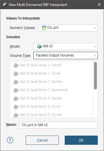

To start creating a multi-domained RBF interpolant, right-click on the Numeric Models folder and select New Multi Domained RBF Interpolant. The New Multi-domained RBF Interpolant window will be displayed:
In this window, select the basic parameters for the multi-domained RBF interpolant. You will be able to set additional properties once you click OK.
- Select the Values To Interpolate from the suitable data available in the project. You will be able to change how data is filtered at the next step, but you will not be able to change the values used.
- Select the domains used to generate sub-interpolants. These options cannot be changed once the multi-domained RBF interpolant has been created, although you will be able to select which volumes are used to generate sub-interpolants.
- Select from the geological models available in the project.
- If the selected Model has no faults defined, the Volume Type will be set to output volumes.
- If the selected Model is a faulted model, the Volume Type can be output volumes, faulted output volumes or fault blocks.

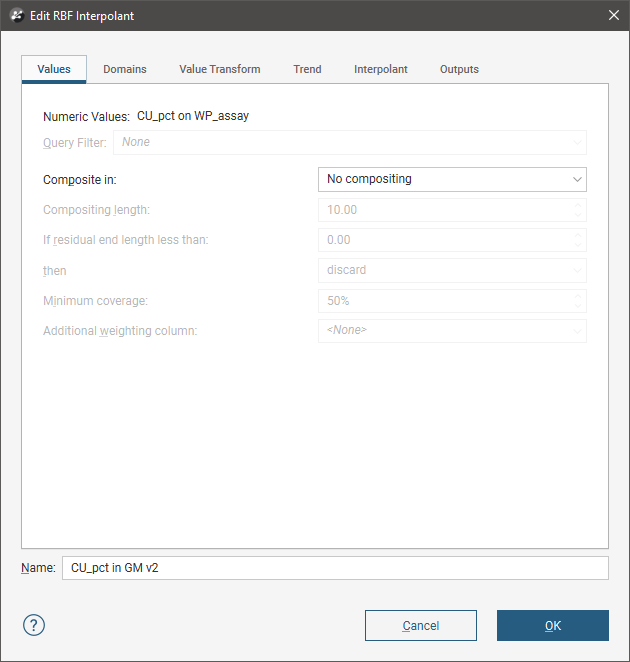

Click OK to move on to the next step. The Edit RBF Interpolant window will appear:
Compositing and Filtering the Values Used
In the Values tab, you can apply any query filters that have been defined for the data used.
When numeric values from drilling data are used to create an interpolant, there are two approaches to compositing that data:
- Composite the drilling data, then use the composited values to create an interpolant. If you select composited values to create an interpolant, compositing options will be disabled when you first create the interpolant and there will be no Compositing tab when you edit the interpolant.
- Use drilling data that hasn’t been composited to create an interpolant, then apply compositing settings to the interpolated values. If you are interpolating values that have not been composited and do not have specific Compositing values in mind, you may wish to leave this option blank as it can be changed once the model has been created. You can also change whether or not you use compositing once the interpolant has been created in the interpolant’s Compositing tab.

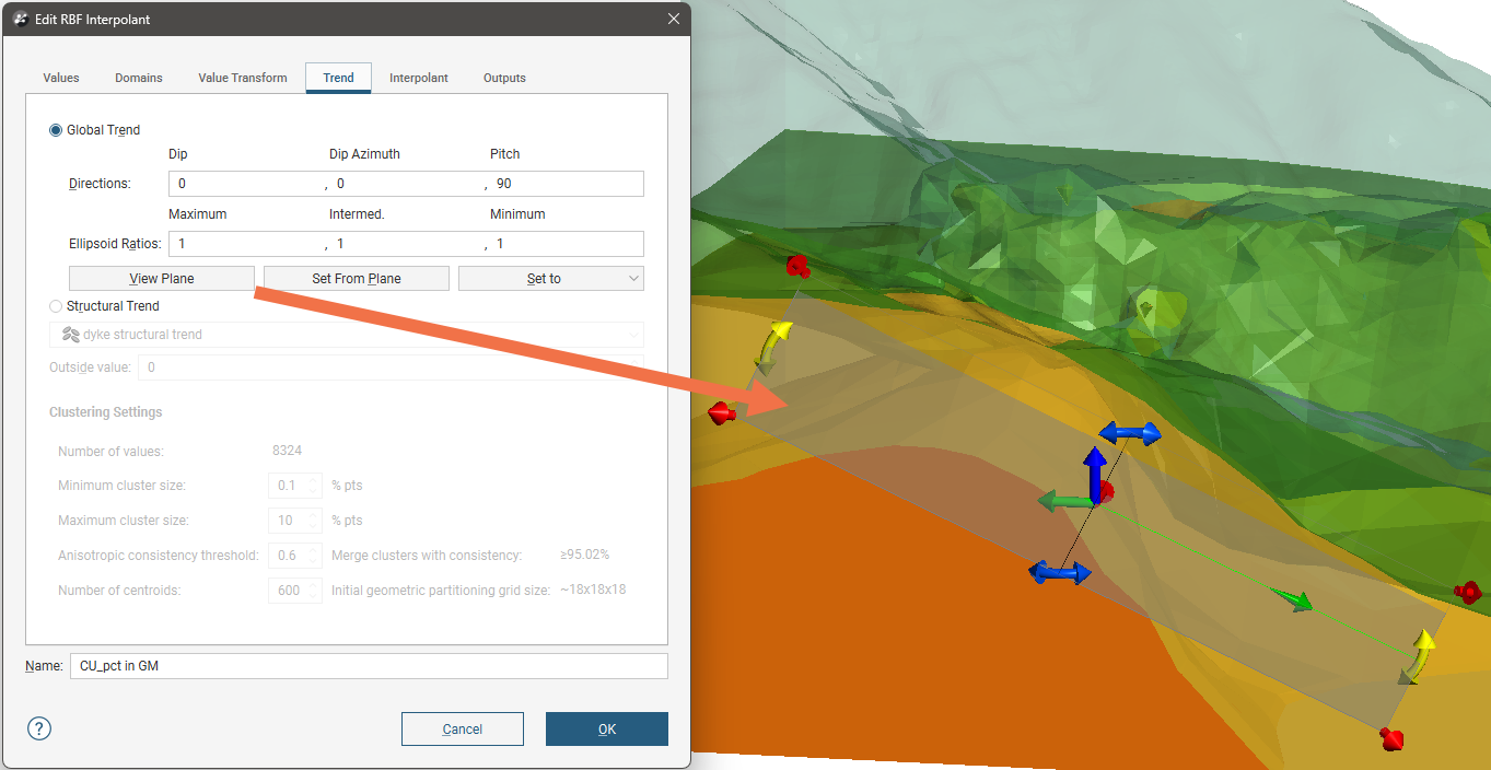

You can apply a global trend or a structural trend to a multi-domained RBF interpolant. To do this, add the interpolant to the scene, then double-click on the interpolant in the project tree. Click on the Trend tab in the Edit RBF Interpolant window.
See:
Using a Global Trend
The easiest way to change the trend applied to an interpolant is using a global trend set from the moving plane.
Click View Plane to add the moving plane to the scene, then click on the plane to view its controls. You may need to hide part of the interpolant to click on the moving plane:
You can also use the Set to list to choose different options Leapfrog Geo has generated based on the data used to build the interpolant. Isotropic is the default option used when the interpolant is created.
Click OK to regenerate the interpolant and view changes.

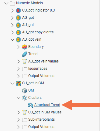

Once the structural trend has been created, add it to the interpolant by double-clicking on the interpolant in the project tree, then clicking on the Trend tab. Select the Structural Trend option, then select the required trend from the list:
Outside value represents a baseline value, the expected ambient value of the surrounding region. The Outside value is factored into the interpolation algorithm and lowers the interpolated value in the areas away from the known data points. The blending with outside value is very steep. To increase the projection area outside of the area with data the Outside value can be increased to a value just below the cut-off value.
Once you have selected a structural trend, you can adjust the clustering settings. For more detailed information For more detailed information, see the Building a Structural Trend and Clustering Settings and Visualisation topics.
Click OK. The trend will be added to the interpolant and will appear as part of the interpolant, as shown:

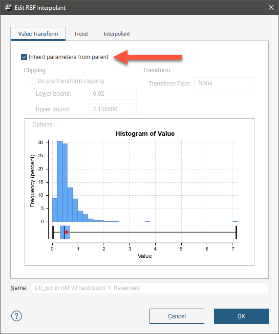

Once you have created a multi-domained RBF interpolant, you can adjust its properties as described in Changing the Settings for an RBF Interpolant. You can also change trend, clipping, transformation and interpolation settings for a sub-interpolant. To do this, double-click on a sub-interpolant. For the settings you wish to change, untick the Inherit parameters from parent box:

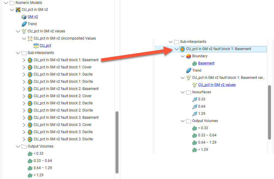

The new multi-domained RBF interpolant will be created and added to the Numeric Models folder. It contains objects that represent different parts of the interpolant:
- There is a link to the geological model from which domains are selected for the sub-interpolants.
- The Trend object describes the trend applied in the interpolant. See Changing the Trend for an RBF Interpolant for more information.
- The points data values object contains all the data used in generating the interpolant. See Changing and Adjusting the Values Used for more information.
- The Sub-interpolants folder contains the sub-interpolants, which can be edited to change the trend, clipping, transformation and interpolation settings. Each sub-interpolant has its own boundary, trend, isosurfaces and output volumes.
- The Output Volumes folder contains all the volumes generated in building the interpolant.
Other objects may appear in the project tree under the interpolant as you make changes to it.

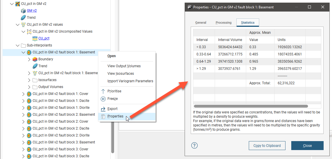

You can view the approximated mean for each output volume of a sub-interpolant by right-clicking on the sub-interpolant and selecting Properties. Click on the Statistics tab:
