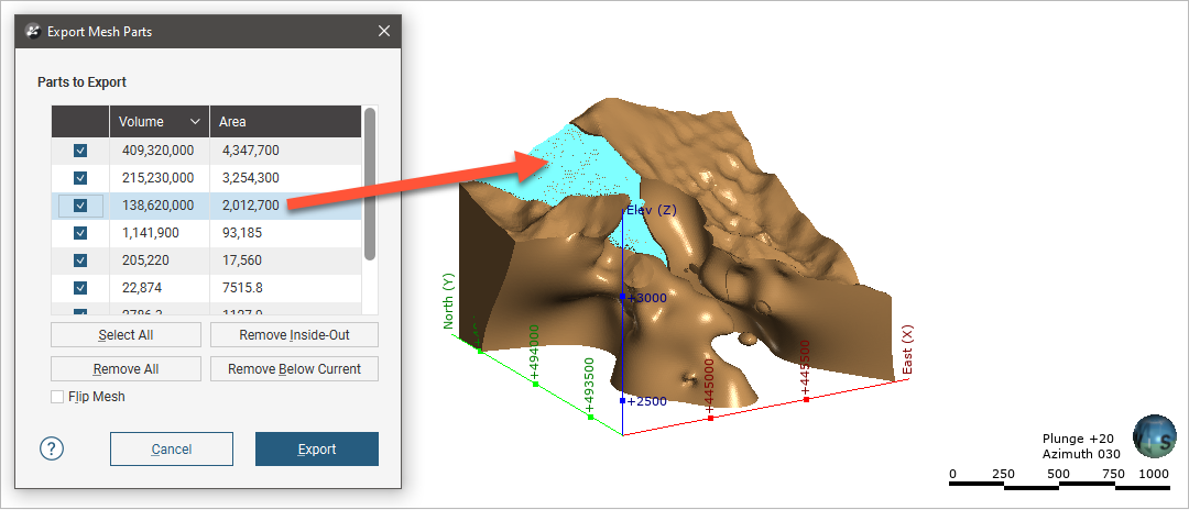

  • Non-editable meshes () are meshes imported into Leapfrog Geo and meshes created in Leapfrog Geo from the moving plane, Meshes > Mesh Operations tools and by extracting mesh parts from other surfaces in the project.

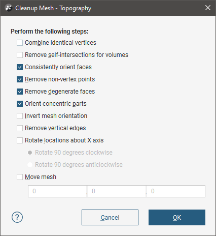

Cleaning Up a Mesh
There are several options for cleaning up a mesh that can be applied to meshes imported into Leapfrog Geo and to non-editable meshes created in Leapfrog Geo.
The next four options are automatically applied to meshes created in or imported into Leapfrog Geo:
  • Consistently orient faces ensures that a mesh can be used for inside/outside testing.
  • Remove non-vertex points removes points that are not used by any triangles.
  • Remove degenerate faces removes triangles with duplicate vertices.
  • Orient concentric parts ensures that internal parts have the correct orientation.
Other options are:
  • Invert mesh orientation reverses the polarity of the mesh.
  • Remove vertical edges removes any vertical faces from the mesh boundary.
  • Rotate locations about X axis lets you rotate the mesh 90 degrees clockwise or anticlockwise.
  • Move Mesh lets you offset the mesh by a vector. Tick the Move Mesh box and enter the required values. The offset values can be changed by opening the Clean Mesh window once again.

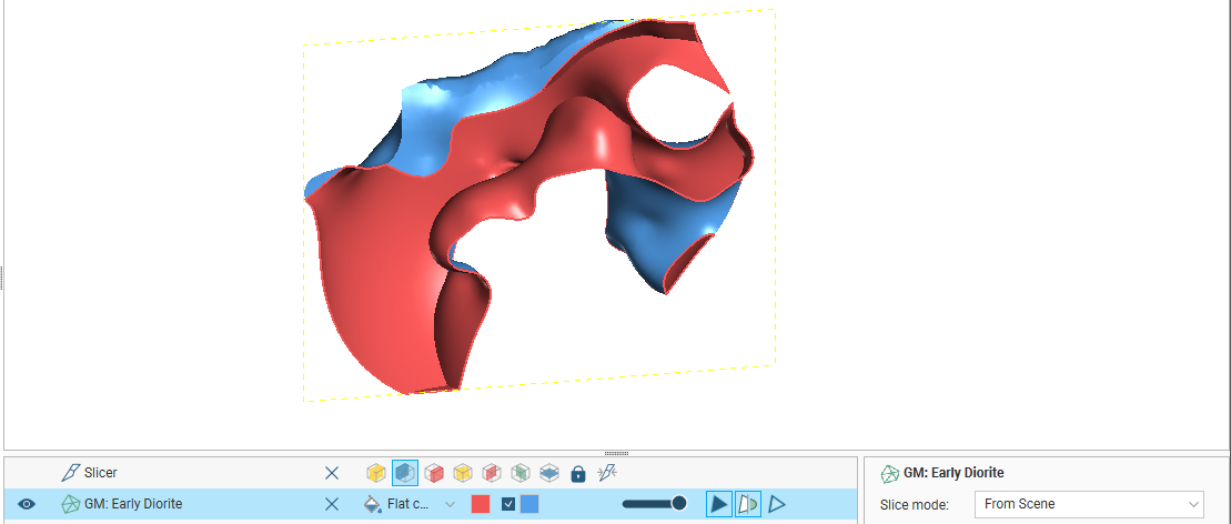

Leapfrog Geo assigns different colours to each side of a surface, according to the polarity of the surface.
See the Polarity in Leapfrog Geo for more information about the polarity of surfaces.

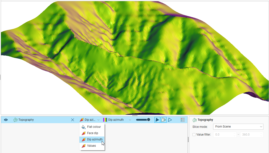

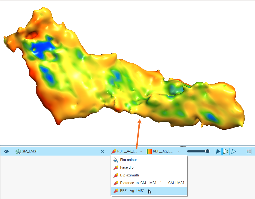

Many meshes in Leapfrog Geo can also be displayed using other properties, such as the Dip azimuth of the surface, which can be useful in highlighting areas of the surface that change direction rapidly:
Disable the Clipped surface button () to view the surface unclipped:

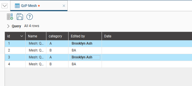

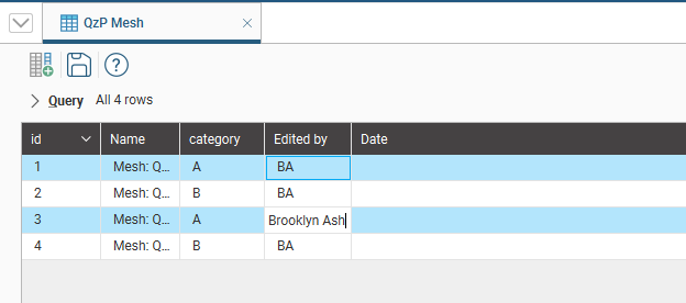

Leapfrog Geo supports the import of attributed meshes in GOCAD (*.ts) and Leapfrog Geo Attribute Binary Mesh (*.msh, *.ara) file formats. You can display such meshes using an attribute by selecting the attribute column from the view list.

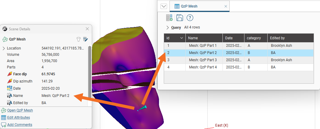

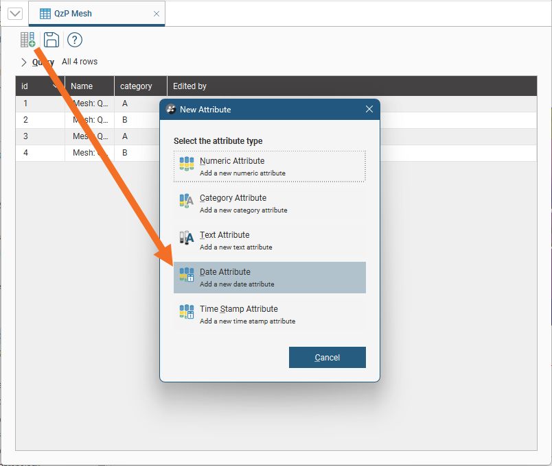

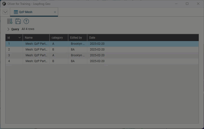

You can assign attributes to a mesh, which adds a new column to the mesh object. To do this, right-click on the mesh in the project tree and select Attribute Table. In the window that appears, click the Add a new attribute column button (). In the window that appears, select the attribute type:
This column order will be used when the attribute table is exported along with the geological model when using the LFM format.

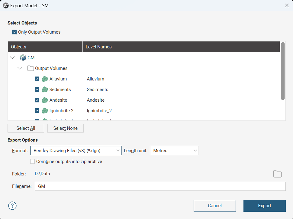

Exporting Meshes

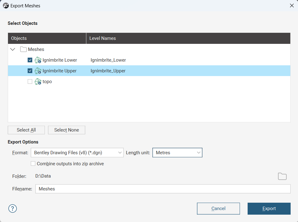

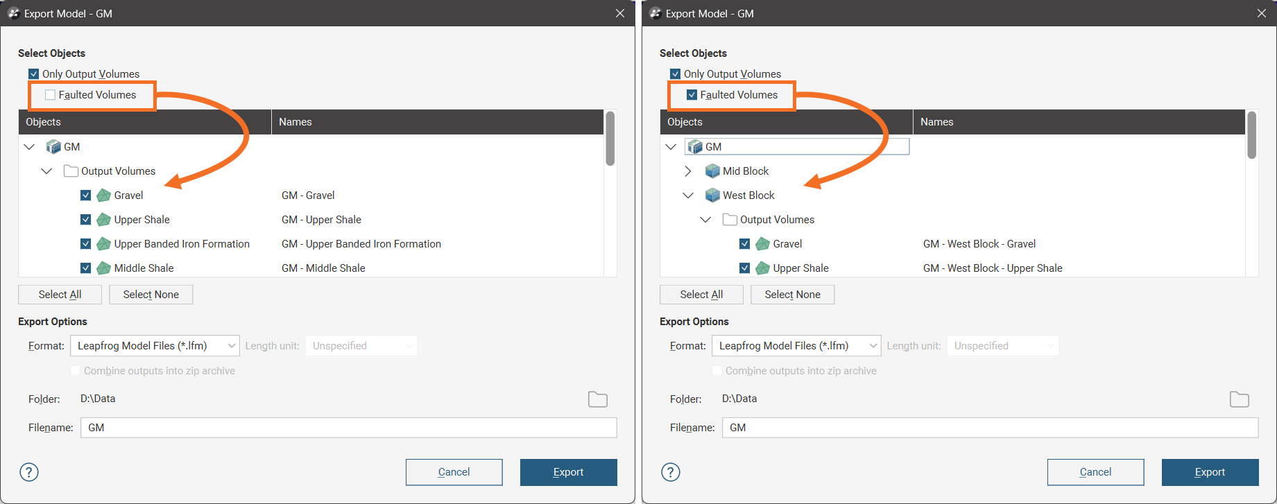

Leapfrog Geo exports meshes in the following formats:
  • Leapfrog Attribute Binary Mesh Format (*.msh)
  • GOCAD Files (*.ts)
  • Gemcom Files (*.tri)
  • Datamine Files (*_pt.asc, *_tr.asc)
  • Micromine Files (*_MMpt.dat, *_MMtr.dat)
  • Surpac Files (*.dtm, *.str)
  • DXF Polyface Files (11/12 [AC1009]) (*.dxf)
  • Alias Wavefront Object Files (*.obj)
If you have the Maptek Link extension, you can also export meshes in VULCAN .00t format. Contact Customer Support as described in Getting Support for more information about the Maptek Link extension.

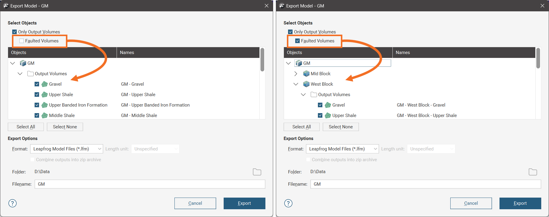

Exporting a Single Mesh
  • Leapfrog Model Files (*.lfm)
When exporting in Bentley Drawing Files (v8) (*.dgn) format, a Length unit needs to be specified.
For any of the export options other than Leapfrog Model Files format, you can select Combine outputs into zip archive to save the meshes as a zip file.
For any of the export options other than Leapfrog Model Files format, you can save the meshes as a zip file.
