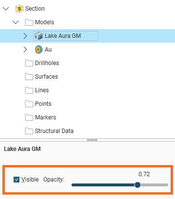

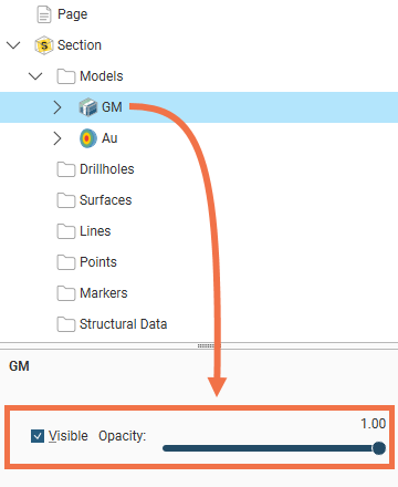

It is not necessary to evaluate objects in the project on the section before working in the section layout editor. When you add an object to the layout, Leapfrog Geo will automatically evaluate it on the section.
Models, drillholes, surfaces, lines, points and structural data occupy the same space on the section layout, and opacity settings and an object’s position among the layers can be used changed to emphasise relevant information. To change the order of objects on the page, right-click on them and select an option:
Adding and Styling Models

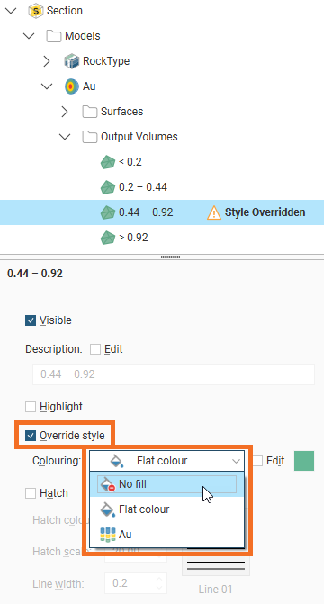

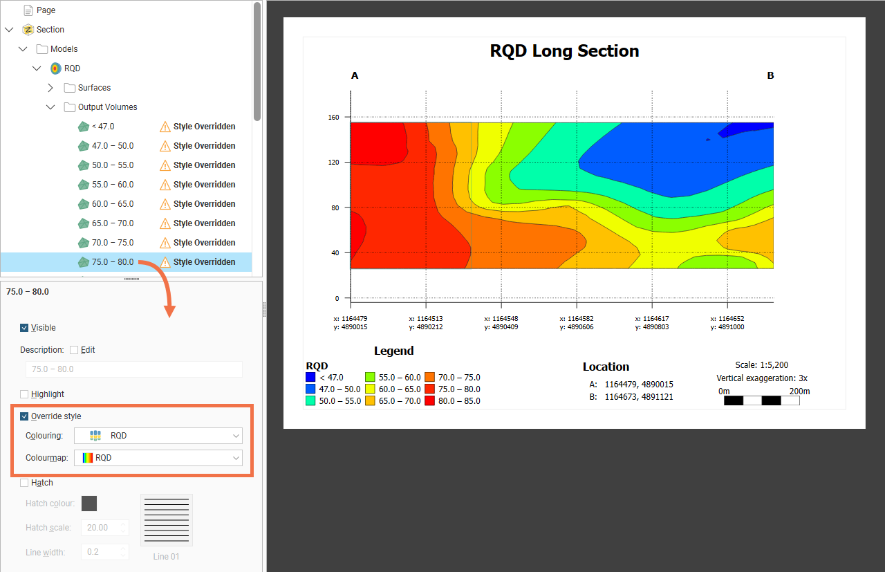

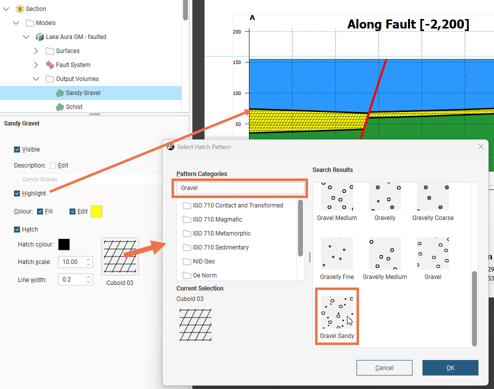

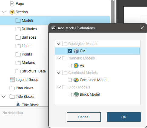

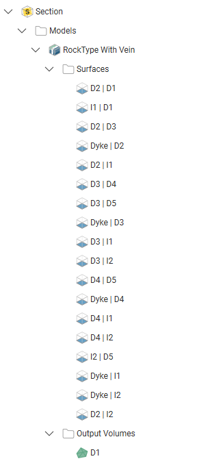

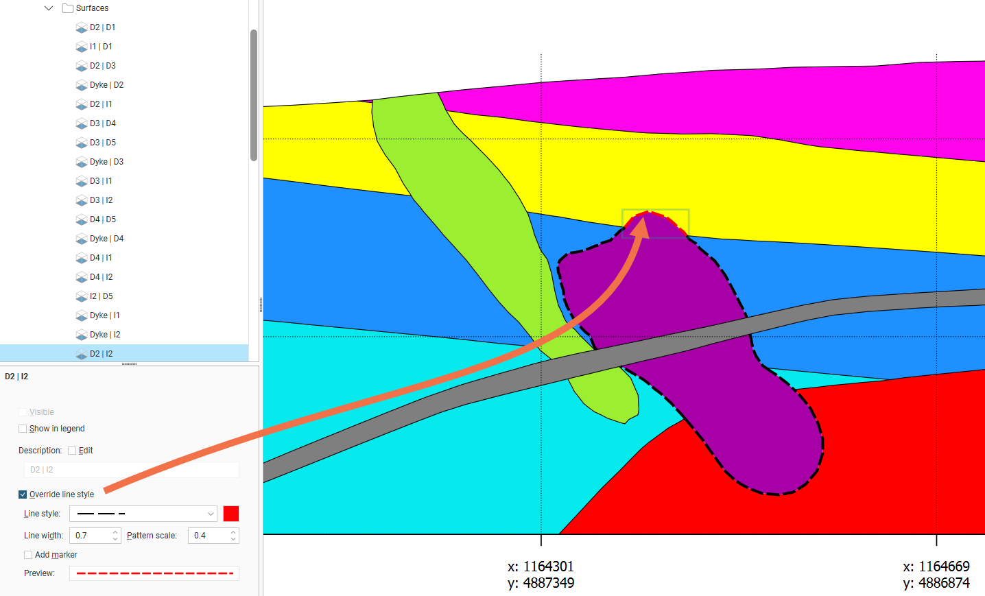

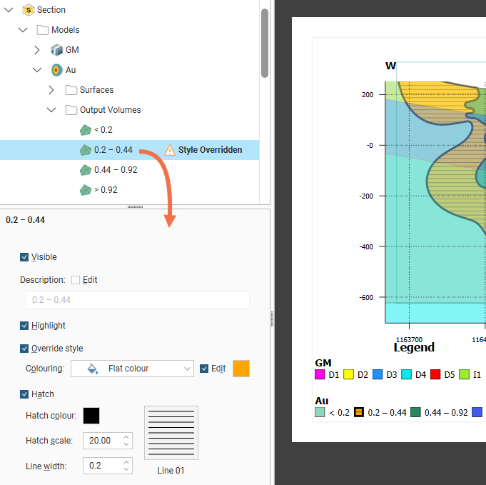

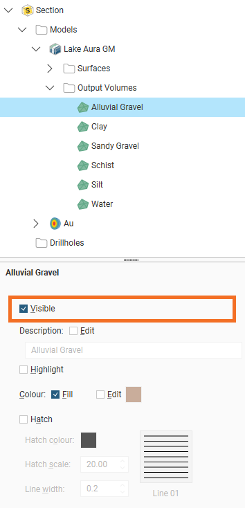

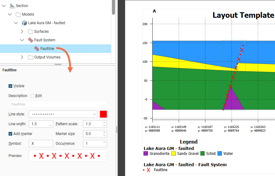

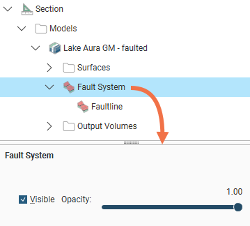

- For geological models, numeric models and combined models, expand the model in the layout tree to change how each output volume is displayed. You can hide volumes by deselecting the Visible setting, or tick Highlight to increase the weight of the some of the output volumes. You can use an automatically selected flat fill colour or set a specific flat fill colour. For numeric models, if you override the style of a volume, you can also use the colour associated with the data column and a selected colourmap. Hatching patterns and colours can be added and customised.

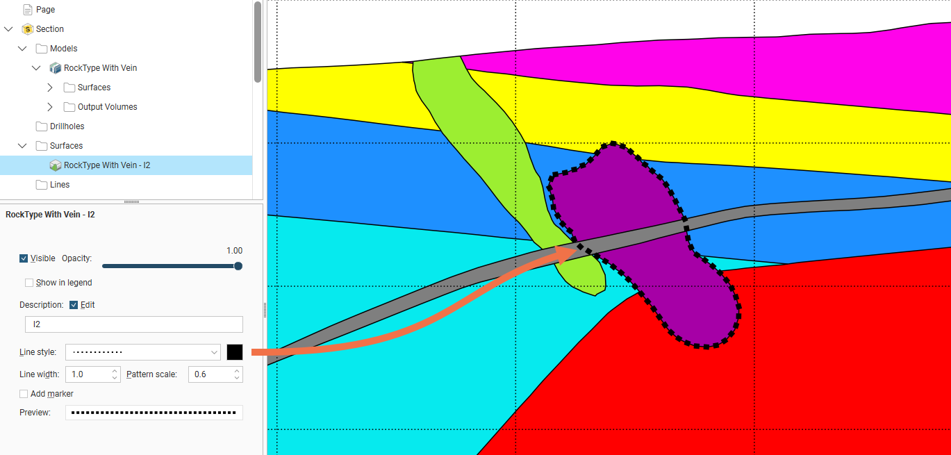

It can result in a large number of surfaces to work with, but does provide you more control over how these surfaces appear on the section layout. For example, here the outline of the purple I2 intrusion volume can be shown in different styles (as with the yellow D2 contact) or not at all (as with the grey Dyke contacts):
You could alternatively display a contact surface on a section layout as a surface evaluation, but you can have only one line style and you don’t have control over what parts of the surface are displayed. For example, you cannot hide the surface where it is intersected by the dyke:

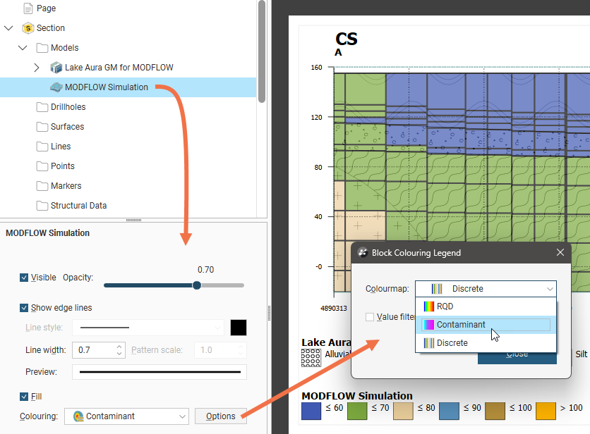

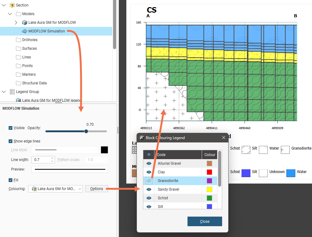

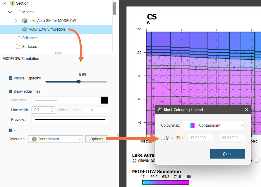

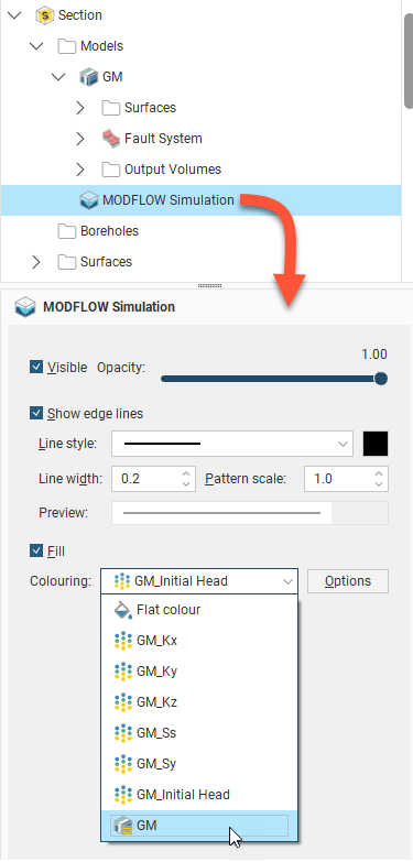

- For category evaluations, you can change what categories are visible and the colours used to display them, and hide categories so they are not displayed on the section layout.

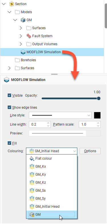

For example, here, a MODFLOW model is displayed using the Colouring from an evaluated geological model, and the block colouring legend window shows the category evaluation colour options:
Here, the MODFLOW model is displayed using the Colouring from a hydrological evaluation, and the block colouring legend window shows the numeric evaluation colour options:

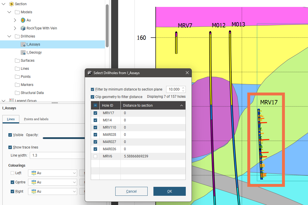

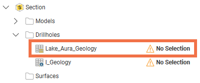

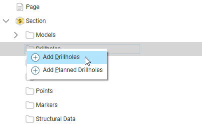

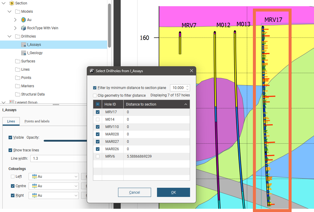

The Drillholes folder contains all drillholes and planned drillholes that have been added to the section layout. To add drillholes to the section, right-click on the Drillholes object and select either Add Drillholes or Add Planned Drillholes.

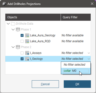

When adding a drillhole projection, you will be prompted for the interval tables to display; more than one can be selected. When available, filters can be selected to constrain the data in the selected table. Each selected table will be added as a separate item below the Drillholes folder.
When you click OK, the drillhole is added to the layout tree. It will be flagged with No Selection.

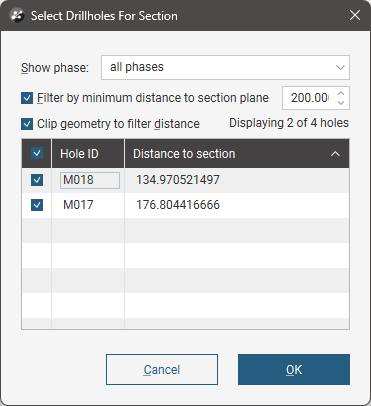

If you add a single drillhole table, the Select Drillhole window will also appear. Otherwise, double-click on a drillhole object to open the Select Drillhole window. Use the filtering options to determine the limits for the projection of the drillholes onto the section based on the minimum distance from any point on the drillhole trace to the section plane, and select from the filtered list of drillholes which should be projected.
This window can also be opened by right-clicking on the Drillholes object and selecting Projection settings.

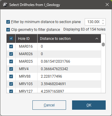

When adding planned drillholes, you can select from the available planned drillhole drilling phases or select all phases. Then use the filtering options to determine the limits for the projection of the drillholes onto the section based on the minimum distance from any point on the drillhole trace to the section plane, and select from the filtered list of drillholes that should be projected.
For both the drillhole and planned drillhole projections, the drillhole selection window offers the option to Clip geometry to filter distance. With this selected, only the parts of drillholes that are within the specified minimum distance will be projected onto the section.
With Clip geometry to filter distance unchecked, if part of a drillhole is within the minimum distance specified, the whole drillhole will be projected onto the section.

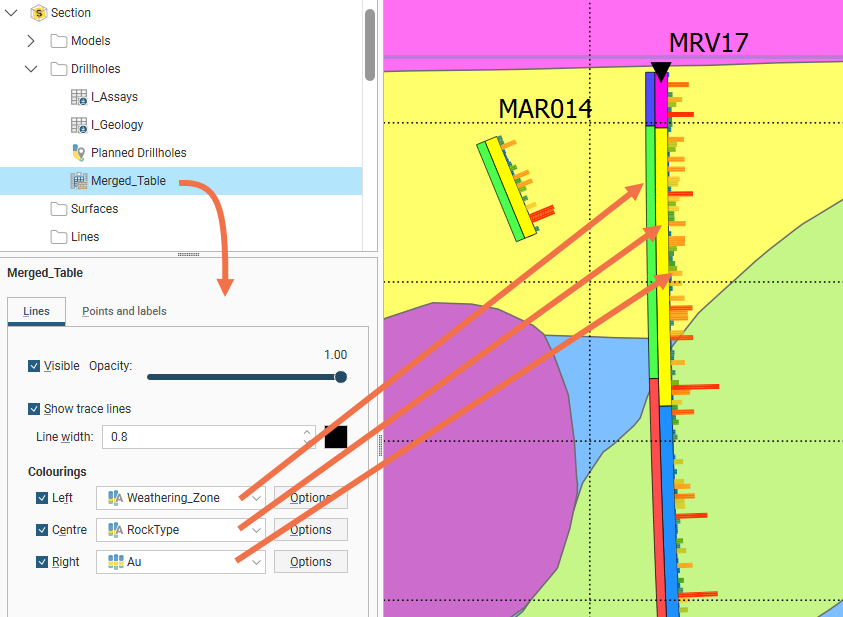

Select an item under the Drillholes in the layout tree to see the properties to make the objects visible and to change their opacity and line width.

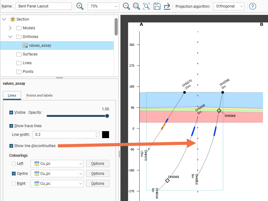

Long sections using the orthogonal projection algorithm have an additional option to Show line discontinuities, which adds a dotted line to connect drillholes that appear “broken” across panel folds due to a curve or angle in a polyline being flattened onto a section.

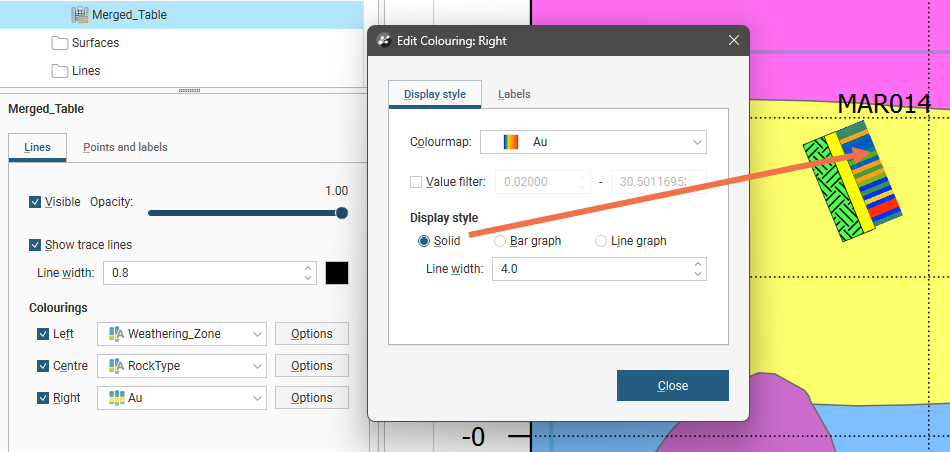

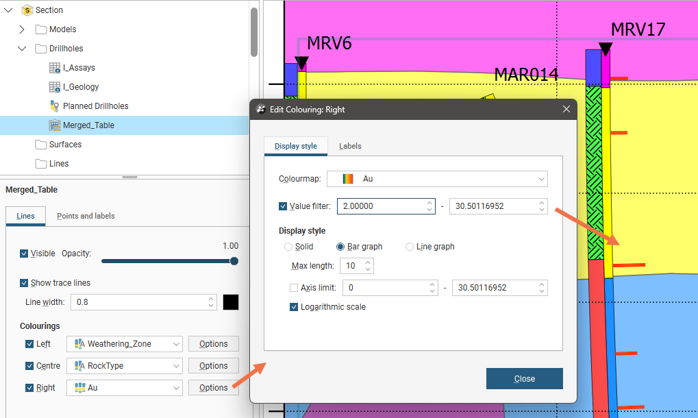

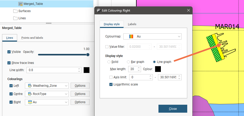

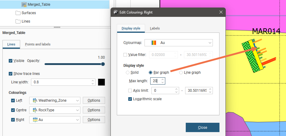

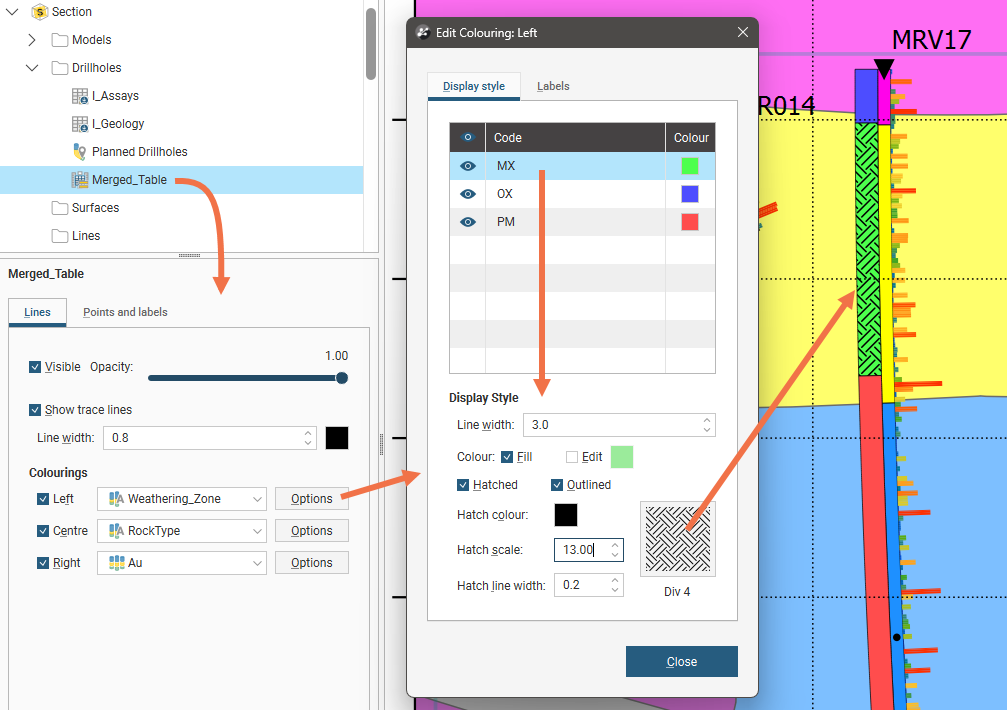

If you select an object with existing drilling data, you will have additional options. Up to three columns of data can be displayed as stripes down the drillhole, and numeric data can even be displayed as a graph. Tick either the Left, Centre or Right positions for the boreholes to enable the visualisation and assign a Colouring according to an interval data selection.
Next to each Colouring, the Options button opens a properties dialog for customisation for each set of interval data. The Line width can be set for each stripe down the drillhole.
For numeric data, a Value filter can be used to restrict the range of data shown in the drillhole stripe.

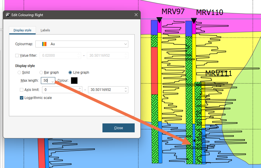

- Bar graph which adds a variable width up to create a bar graph running down the drillhole with downhole sample values being indicated by the Colourmap colouring:
The bar and line graph options are not available for the centre of the drillhole, although the solid option can be used.
Bar graph and Line graph extend out from the drillhole to a specified Max length. Select a Max length that means that displayed data does not interfere with other drillholes or data displayed on the section layout.
This is especially relevant when two graphs are displayed per drillhole.
The Axis limit fields clip the chart range to the minimum and maximum values of interest and an option is provided to make the value axis scale a Logarithmic scale. The line graph option provides the ability to specify the Colour of the line. Click the colour tile and select a new colour using the colour picker.

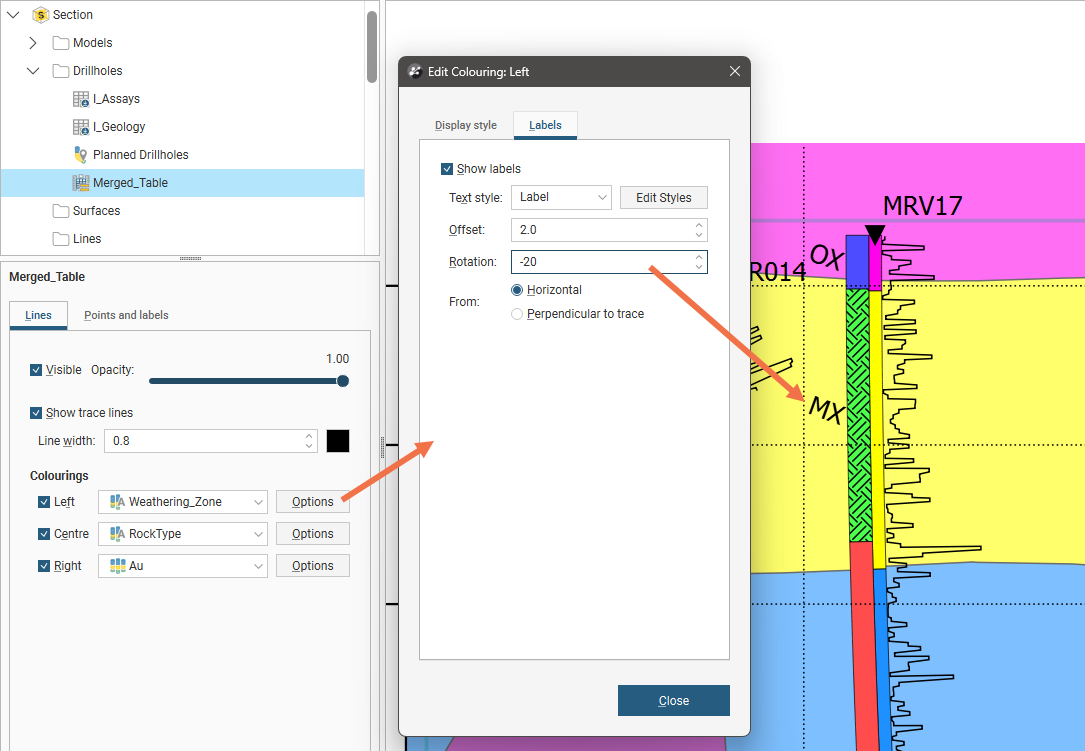

Both category and numeric data Options windows also have a Labels tab. Labels can be shown or hidden using the Show labels tickbox abd the Text style can be selected from one of the text styles provided and modified using the Edit styles button. The Offset specifies the distance from the drillhole the label will appear. Numeric data labels also add the option of making this offset a Constant distance or adding the Numeric value to the Offset to stagger the labelling according to the data values. The Rotation of the label can be specified so they appear at a tilted angle from the drillhole, and this angle can be specified to be with reference to the Horizontal if the labels should all be parallel, or Perpendicular to trace if the labels should follow the curve of the drillhole. Numeric labels also have the option to specify the number of Decimal places in the labels.
Labelling numeric data values works best for numeric datasets with sparse data sampling because when data samples are close together it can lead to cluttered and overlapping labelling, even when reducing the size of the font used for labelling.

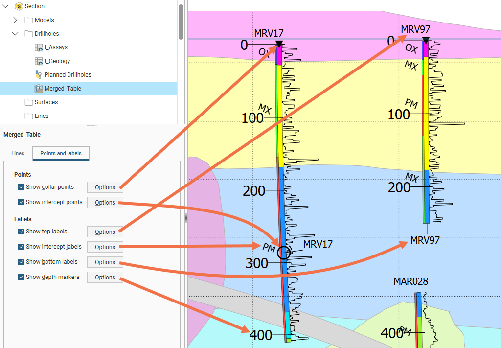

Besides the labels associated with interval data described above, you can also have the following type of labels at different points along the drillhole trace:
- Top labels
- Intercept labels
- Bottom labels
- Depth markers
- Collar points
- Intercept points
- Depth markers
An intercept point is where the drillhole intersects the section plane.

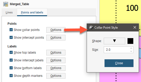

Select either a drillhole object or planned drillhole from the Drillholes folder in the layer tree, then select the Points and labels tab.
Top, bottom and intercept labels can have the Text style selected from the available styles, or you can click Edit Styles to customise the style. Offset (x, y) positions the label a specified distance away from the point it is referencing. Rotation will put an angle on the label, useful when labels are close together. Top and bottom labels have the option to Show minimum distances for the drillhole from the section plane. You can also choose to Show units and specify the number of Decimal places to show. When enabled, Show sign will add a + in front of the minimum distance if the drillhole is behind the section, and a - in front of the minimum distance if the drillhole is in front of the section. Drillholes that pass through a section will have a minimum distance of 0 and no sign will be shown.
Labels can have a line connecting them to the point they refer to, if Draw label lines is ticked and once the label is more than the At offset length away from the point. The Line style. Line width, Pattern scale and colour can be customised. A Preview shows what the line will look like on the section.

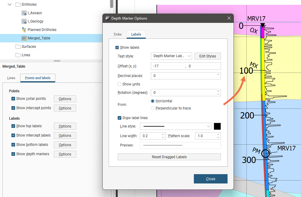

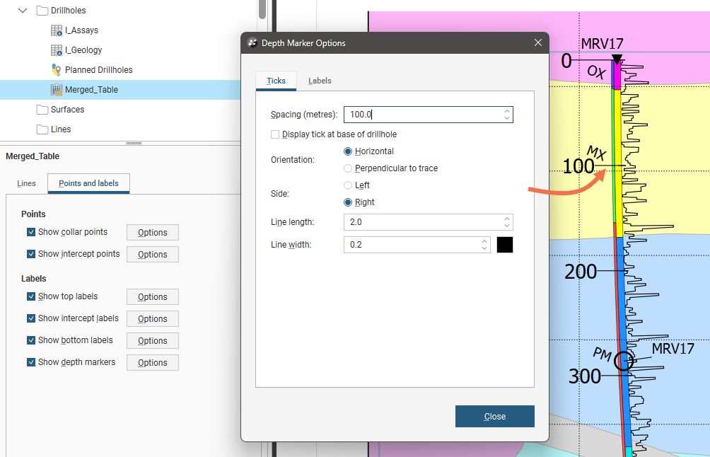

Depth markers display ticks down the length of drillholes with optional distance labels. On the Ticks tab, the tick Spacing can be specified, and you can choose to optionally Display tick at base of drillhole. The Orientation of the tick can be Horizontal to display all the ticks in parallel, or Perpendicular to trace to have the tick orientation follow the curve of the drillholes. The Side of the drillhole centreline the tick extends from can be specified as Left or Right. The Line length specifies how far from the drillhole centreline the tick extends, and the Line width determines how thick the tick is.
On the depth marker Labels tab, the labels can be enabled using the Show labels tickbox and customised in the same way as other labels using the Text style selector and the Edit Styles button. Offset (x, y) positions the label a specified distance away from the tick it is referencing. Rotation will put an angle on the label. You can also choose to Show units and specify the number of Decimal places to show. Labels can have a line connecting them to the point they refer to, if Draw label lines is ticked. The Line style. Line width, Pattern scale and colour can be customised. A Preview shows what the line will look like on the section. Depth marker labels can be selected and dragged into a new position to avoid overlapping with adjacent items on the section. Click the Reset Dragged Labels button to restore them to the default position.

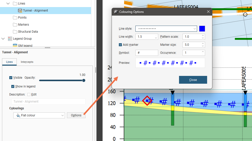

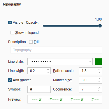

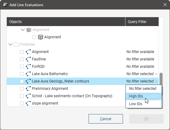

Adding and Styling Lines

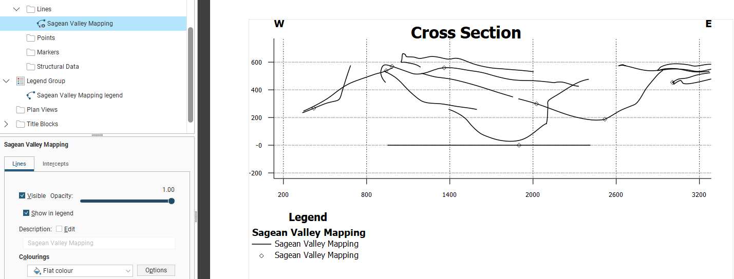

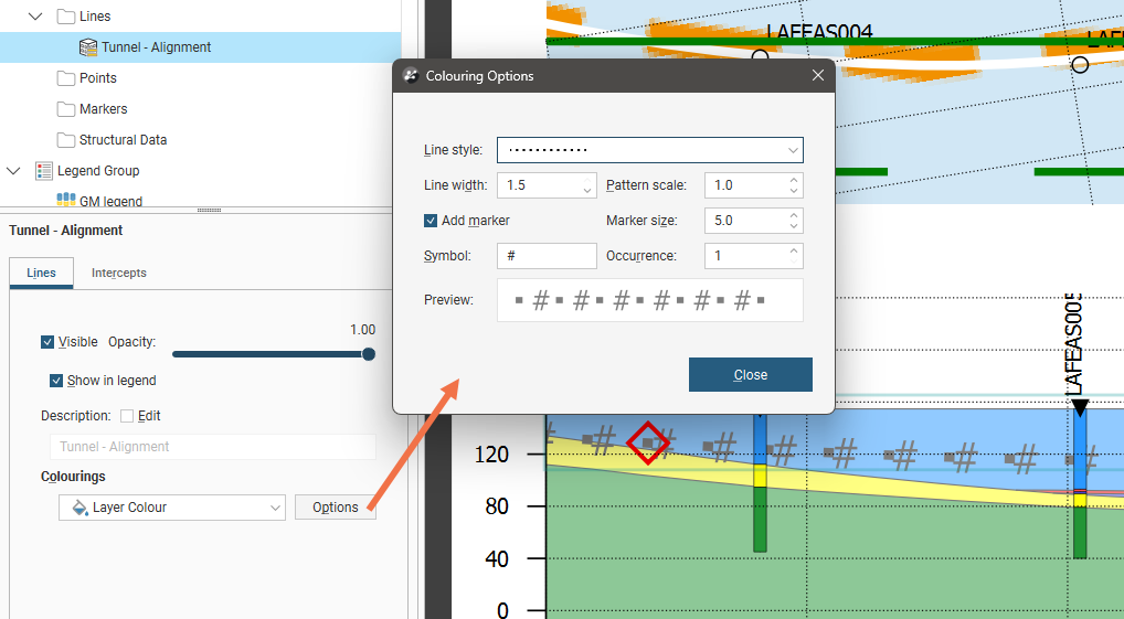

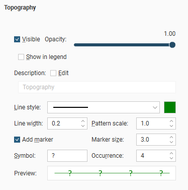

The Lines folder contains all lines that have been added to the section layout. To add another line, first make sure it has been evaluated on the section, then right-click on the Lines folder and select Add Line. Select from those available, select a query filter if available and desired, then click OK.
If your polyline has category attributes, you cannot use the category data to directly apply colouring to polylines you add to the section layout.
You can, however, right-click on the polyline and select Extract GIS Line, and add the GIS line to the section layout. While a GIS line will not contain points or tangents, it can be used to specify a category for Colourings.

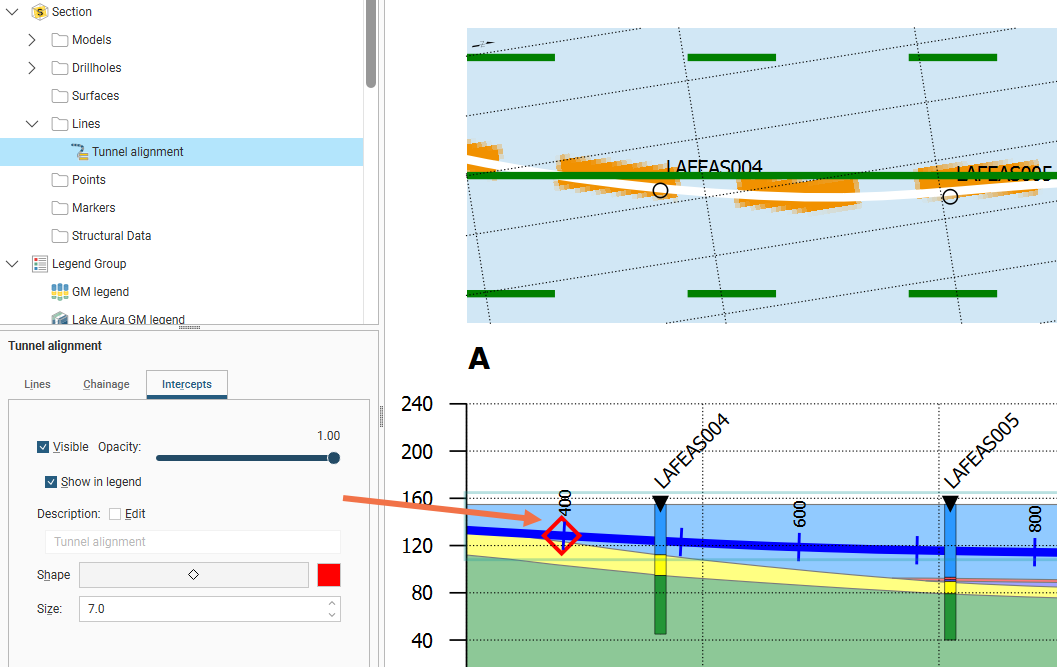

Alignment lines have a Chainage tab in which you can style and place the tick marks:

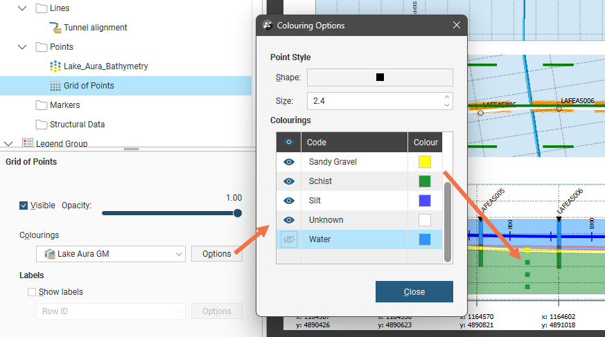

Adding and Styling Points

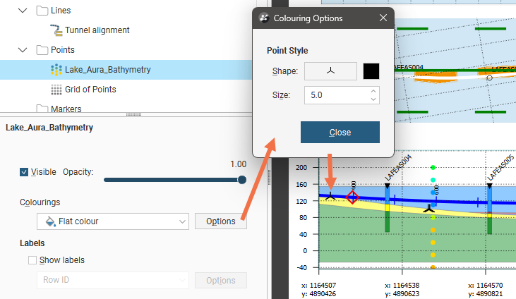

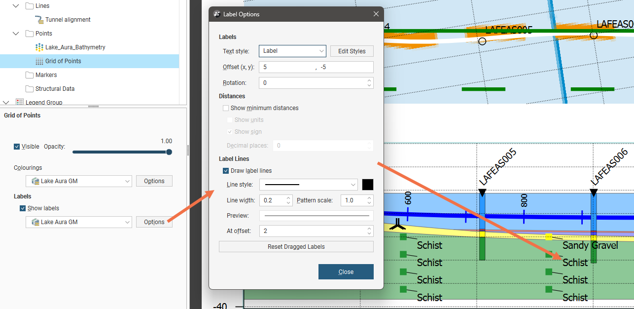

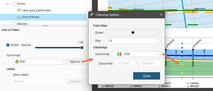

The Points folder contains all points objects that have been added to the section layout. To add another points object, right-click on the Points folder and select Add Points. Select from those available and click OK.
You can choose to Show labels or hide them. From the selector you can choose the same option as used for Colourings or a different option. Click the Options button to customise the labelling. Text style provides a list of available styles, or you can click Edit Styles to customise the style. Offset (x, y) positions the label a specified distance away from the point it is referencing. Rotation will put an angle on the label, useful when labels are close together. You can choose whether or not to Show minimum distances for the point from the section plane and you can also choose to Show units and specify the number of Decimal places to show.
When enabled, Show sign will add a + in front of the minimum distance if the point is behind the section, and a - in front of the minimum distance if the point is in front of the section. Points that pass through a section will have a minimum distance of 0 and no sign will be shown.

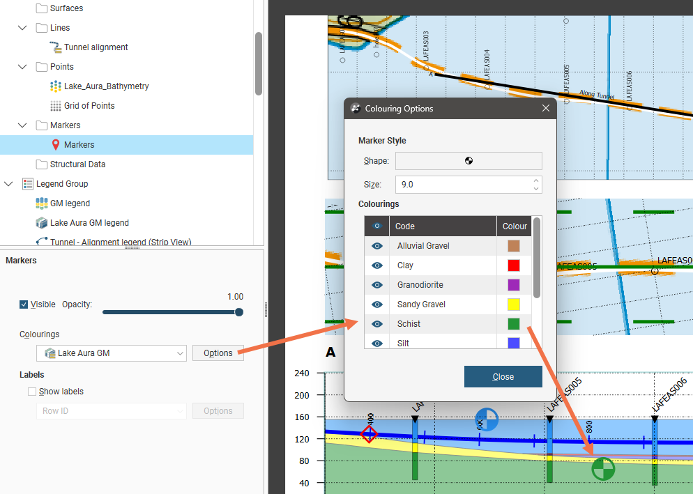

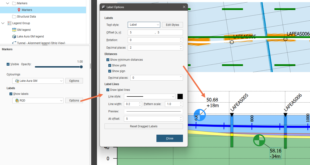

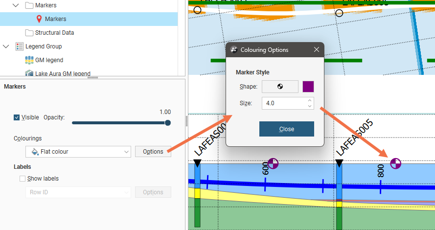

The Markers folder contains all marker tables that have been added to the section layout. To add another marker table, right-click on the Markers folder and select Add Markers. Select from those available and click OK.

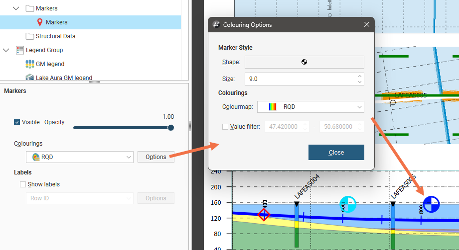

Click on the markers table in the layout tree to view marker styling options. Visibility can be turned on or off and the Opacity of the points can be set.
If you choose a numeric value column associated with the markers and click Options you can pick a Shape from 60 symbols and set the Size of the markers on the section. You may also be able to select from available Colourmaps if more than one is available, and enable a Value filter to only show points between a specified minimum and maximum value.
If you choose a category column associated with the markers and click Options you can pick a Shape from 60 symbols and set the Size of the markers on the section. You can also set the visibility for the markers by category. The Code and Colour cannot be customised in this window.
You can choose to Show labels or hide them. From the selector you can choose the same option as used for Colourings or a different option. Click the Options button to customise the labelling. Text style provides a list of available styles, or you can click Edit Styles to customise the style. Offset (x, y) positions the label a specified distance away from the marker it is referencing. Rotation will put an angle on the label, useful when labels are close together. You can choose whether or not to Show minimum distances for the marker from the section plane and you can also choose to Show units and specify the number of Decimal places to show.
When enabled, Show sign will add a + in front of the minimum distance if the marker is behind the section, and a - in front of the minimum distance if the marker is in front of the section. Markers that pass through a section will have a minimum distance of 0 and no sign will be shown.
Labels can have a line connecting them to the marker they refer to, if Draw label lines is ticked and once the label is more than the At offset length away from the point. The Line style. Line width, Pattern scale and colour can be customised. A Preview shows what the line will look like on the section.

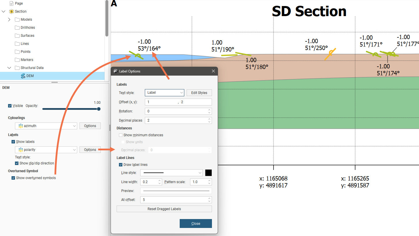

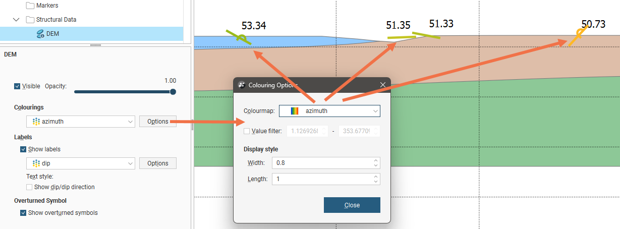

Click the Options button to customise the labelling. Text style provides a list of available styles, or you can click Edit Styles to customise the style. Offset (x, y) positions the label a specified distance away from the point it is referencing. Rotation will put an angle on the label, useful when labels are close together. The Decimal places setting under the Labels heading sets how many decimal places are shown in the label value. You can choose whether or not to Show minimum distances for the drillhole from the section plane and you can also choose to Show units. The Decimal places setting under the Distances heading sets how many decimal places are shown in the minimum distance value.
When enabled, Show sign will add a + in front of the minimum distance if the structural data symbol is behind the section, and a - in front of the minimum distance if the structural data symbol is in front of the section. Structural data symbols that pass through a section will have a minimum distance of 0 and no sign will be shown.
Labels can have a line connecting them to the structural data they refer to, if Draw label lines is ticked and once the label is more than the At offset length away from the structural data. The Line style. Line width, Pattern scale and colour can be customised. A Preview shows what the line will look like on the section.
