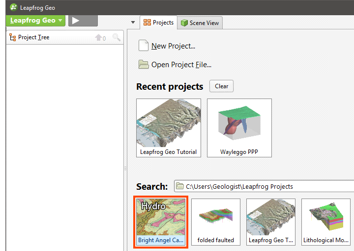

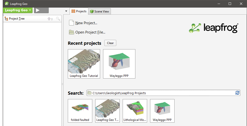

When you launch Leapfrog Geo, the main window will appear with the Projects tab displayed:
Thumbnails for the most recent projects are displayed in the Recent projects list. Click on a thumbnail to open a project.
You can also navigate directly to the required project file by clicking on Open Project File.
Once a project file has been opened, Leapfrog Geo switches to displaying the Scene View tab.
The second set of thumbnails is for projects contained in the Search folder:
- Click on the folder button (
) or press the F5 key to change the Search folder. The Search folder is useful if you have one folder in which you keep most of your Leapfrog Geo projects. - Click on the Refresh button (
) or press the F4 key to update the list of projects in the Search folder.

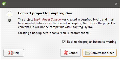

Leapfrog Hydro projects can be converted to Leapfrog Geo projects. However, the process is one-way, and projects opened in Leapfrog Geo can no longer be opened in Leapfrog Hydro.
When you open a Leapfrog Hydro project, you will be prompted to save a backup before converting the project:
Once a Leapfrog Hydro project has been converted to Leapfrog Geo, it can no longer be opened in Leapfrog Hydro. It is strongly recommended that you back up the project before converting it.
In the Projects tab, the thumbnails for unconverted Leapfrog Hydro projects in the Search folder will be marked as Leapfrog Hydro projects:
