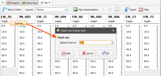

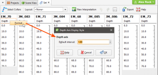

You can change how data is displayed by clicking on the column header, then selecting Format:
The options available depend on the type of column being formatted.

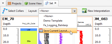

Once you have organised data columns and how they are displayed, you can save this information as a column layout that can be applied to other correlation sets. To do this, click the Layout button in the toolbar and select Save Current Layout from the list:
You will be prompted for a name. Click OK to save the layout, which can then be applied to other correlation sets by selecting the layout from the list.

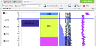

- Create the table without using a base table. Each drillhole will have an empty legend and a single empty interval from 0 to its maximum depth. Select <None> for the Source Column.
Click OK to create the table. A new interpretation table will be added to the project tree under the Drillholes object and the column will be added to the correlation set window:
Assigning Lithologies

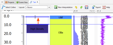

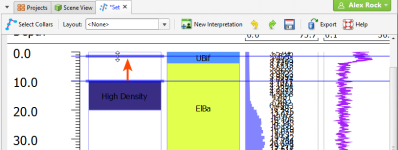

In the correlation set window, the blue line is used to create intervals. Position the blue line then right-click on it and select one of the options:
For example, to create an interval at the top of the table called “High Density”, move the blue line near to where you wish to create the interval. You do not need to be precise as you can adjust the interval once you have added it. Right-click and select Insert interval:
In the legend window, click the Add button and add a lithology called “High Density”:

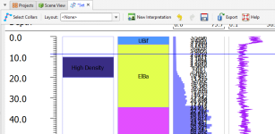

Click OK, then select the new lithology to close the legend window. The new lithology has been assigned to the interval:
To resize the interval, click and drag the interval end points:
1. Click on the interval end point and drag it into position without releasing the mouse button.
2. Move the mouse across to the data point you wish to snap to.
3. Release the mouse.
