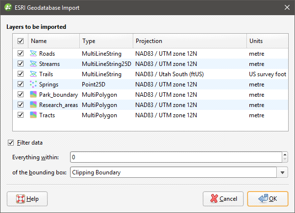

To import GIS points, lines and polygons in this way, right-click on the GIS Data, Maps and Photos folder and select Batch Import > from ESRI Geodatabase. In the window that appears, navigate to the folder that contains the database and click Open.
Leapfrog Geo imports uncompressed ESRI geodatabases.
Data is automatically clipped to the clipping boundary, but you can change how the data is filtered to suit any bounding box that exists in the project. If you do not wish to clip the data, untick the Filter Data box.
Click OK to import the selected files, which will be added to the GIS Data, Maps and Photos folder as a group (
