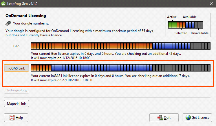

If you have an OnDemand licence, you will be prompted to check out days. In the window that appears, the bars shows the maximum checkout period, divided into blocks that each represent one day. Green blocks are active days remaining on your licence, and blue blocks are days available for checkout. Click blue blocks to select additional days; the blocks will turn orange to indicate the additional days you will be checking out.
You may also have module licences available, in which case you can click on the button for that licence and select the required number of days:
Click Get Licence to update your licence and check out the days indicated in orange.

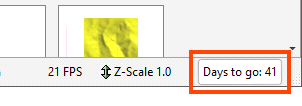

Once Leapfrog Geo is running, you can check out additional days by selecting Extend Licence from the Leapfrog Geo menu or by clicking on the button at the bottom of the main window:
