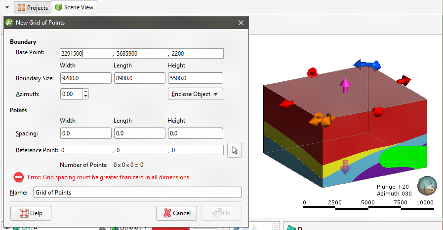

To create a grid of points, right-click on the Points folder and select New Grid of Points. The New Grid of Points window will appear, together with controls in the scene that will help in setting the grid’s boundary:
If there are objects displayed in the scene, the initial grid dimensions will be based on those objects.
The controls in the scene adjust the size and position of the grid as follows:
  • Red and pink handles adjust the Boundary Size.
  • The orange handle adjusts the Base Point.
  • The blue handles adjust the Azimuth.
Set the Spacing and Reference Point, which will control the number of points in the grid. You can set the Reference Point by clicking in the scene. To do this, first click on the Select button () for the Reference Point, then click in the scene. The coordinates in the scene will be copied to the New Grid of Points window.
