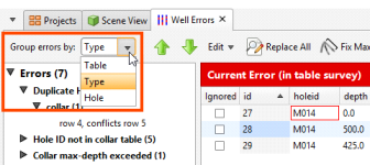

Errors are automatically grouped by Type, but if there are many errors, you may find it useful to view them grouped by Table or HoleID:
When a row that contains an error is selected, a red box indicates the source of the error. When two rows of data conflict, both rows will be displayed, which may be useful in determining how to fix the error:

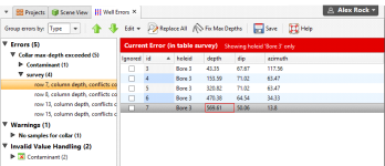

Collar Max Depth Error
Interval tables will have Collar max-depth exceeded errors when the depth values in the interval table exceeds the maxdepth value defined in the collar table. The maxdepth defined in the collar table is often a theoretical value established before drilling. If the depth value flagged as an error is not unrealistic, click on the Fix Max Depths button (
This results in the collar table being updated with a maximum depth value that reflects the data in the interval tables.
