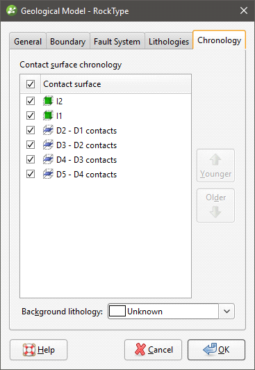

To add a contact surface to the surface chronology, double-click on the Surface Chronology object. The Surface Chronology window will be displayed:
In the project tree, the surfaces are also arranged in chronological order:
The Surface Chronology determines the overall chronological order of the contact surfaces in the model. If you build your models from the bottom up, you will find that often the contact surfaces are in the correct chronological order when you first open the Surface Chronology window. However, you can easily rearrange the chronology using the Younger and Older buttons. Tick the boxes for surfaces you wish to include in the model. When you click OK, the included surfaces will be used to subdivide the geological model into lithological volumes. The volumes will appear in the Output Volumes folder.
