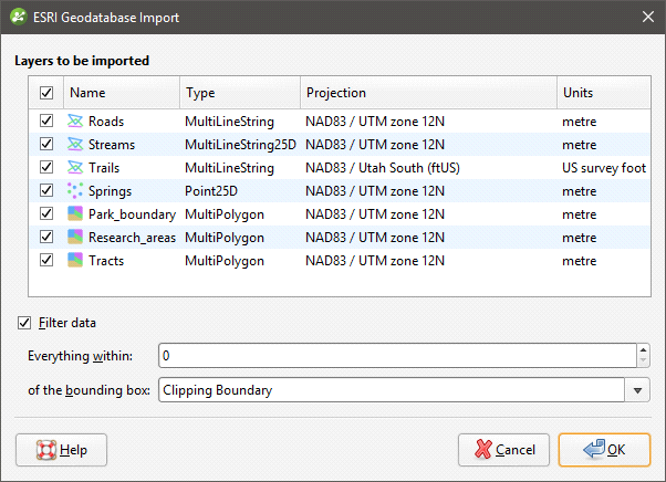

To import GIS points, lines and polygons in this way, right-click on the GIS Data, Maps and Photos folder and select Batch Import > from ESRI Geodatabase. In the window that appears, navigate to the folder that contains the database and click Open.
Leapfrog Geo imports uncompressed ESRI geodatabases.
Click OK to import the selected files, which will be added to the GIS Data, Maps and Photos folder as a group (
