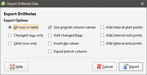

To export all drillhole data, right-click on the Drillholes object and select Export. The Export Drillhole Data window will appear:

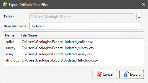

Once you have selected how you wish to export the data, click OK. The Export Drillhole Data Files window will appear:
The list shows the files that will be created, one for each data table. Choose the Folder where the files will be saved, then enter a Base file name, which will be added to the front of each file name.
Click Export to save the files.

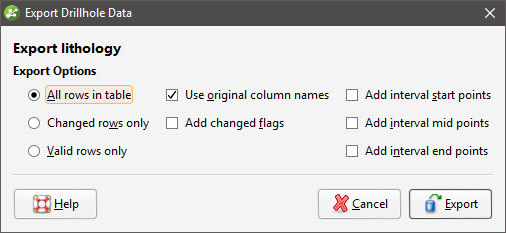

To export a single drillhole data table, right-click on that table and select Export. The Export Drillhole Data window will appear:
Once you have selected how you wish to export the data, click OK. You will be prompted for a filename and location.
