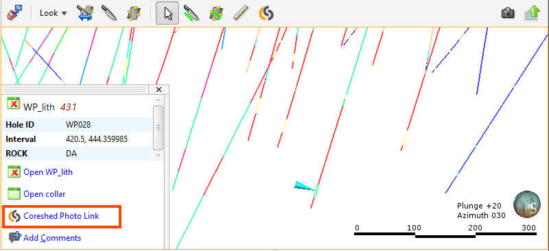

To view core photos, click on a drillhole in the scene, then click on the Coreshed Photo Link button in the window that appears:
Your browser will be launched and you will be prompted to log in to the Coreshed database. Enter the Username and Password, which are case-sensitive. Remember to allow the browser to save the details so that you will not be prompted to log in each time you wish to view a photo.
Your browser settings may require that you install a plugin or make changes to settings in order to view core photos. If you are not able to access the Coreshed database from Leapfrog Geo and have ensured your Username and Password have been entered correctly, contact Customer Support as described in Getting Support.

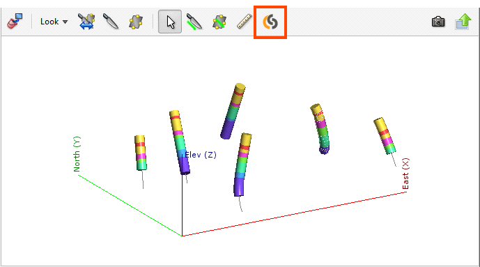

If you want to view core photos in rapid succession, click on the Coreshed Photo Link button (
) in the toolbar, then click on a drillhole in the scene. This will simultaneously:
- Display information on the segment selected in Leapfrog Geo
- Display the core photo in your browser
