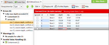

To correct errors in a data table, right-click on the table and select Fix Errors. The Drillhole Errors window will appear. Leapfrog Geo identifies a range of common errors, and all errors identified in a table are grouped by type. Click on an error type to expand it and see the source of a specific error:
You can change the size of the Drillhole Errors window and the columns in the table to view more information easily. When you have finished fixing errors, click the Save button (
). Leapfrog Geo will then update the database.
Errors are automatically grouped by Type, but if there are many errors, you may find it useful to view them grouped by Table or HoleID:
When a row that contains an error is selected, a red box indicates the source of the error. When two rows of data conflict, both rows will be displayed, which may be useful in determining how to fix the error:
