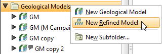

To start refining a lithological volume, first create the refined geological model. To do this, right-click on the Geological Models folder and select New Refined Model:

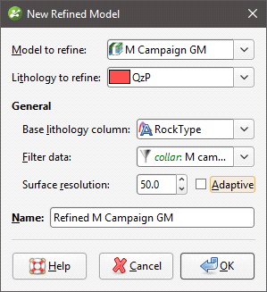

In the window that appears, select the geological model to refine and then select from its lithologies.
Next, set the Base lithology column, Filter data and Surface resolution. You cannot change the Base lithology column once the refined geological model has been established, but you will be able to change the resolution and data filter settings.
Click OK to create the refined lithology.

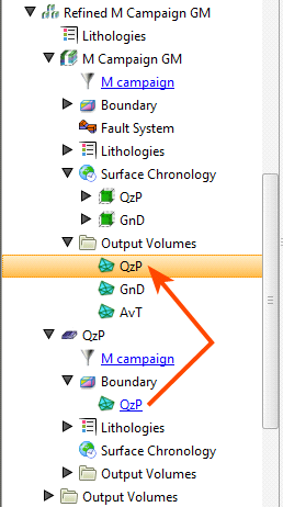

A new refined model () will be created in the project tree and the parent geological model will be moved into it. Here, a model called “M Campaign GM” has been used to created a new refined model, with the QzP volume selected as the refined lithology ():
The sub-model () is created inside the refined geological model and has its own Boundary, Lithologies, Surface Chronology and Output Volumes objects.

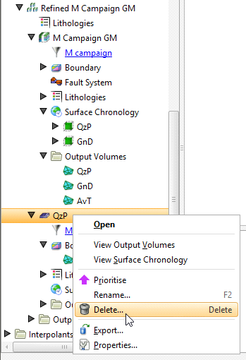

Deleting the refined geological model deletes all models it contains. To return to the original project tree organisation for a geological model, delete the sub-models:
Once there are no more sub-models, the refined model object is also deleted, leaving the parent geological model.

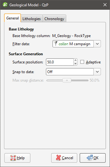

To change the lithology’s resolution settings, double-click on the sub-model () in the project tree. The Geological Model window appears:
This window has only three tabs:
  • There is no Boundary tab because the sub-model’s boundary can only be modified by modifying the parent geological model.
  • There is no Fault System tab because a sub-model cannot have its own fault system.
