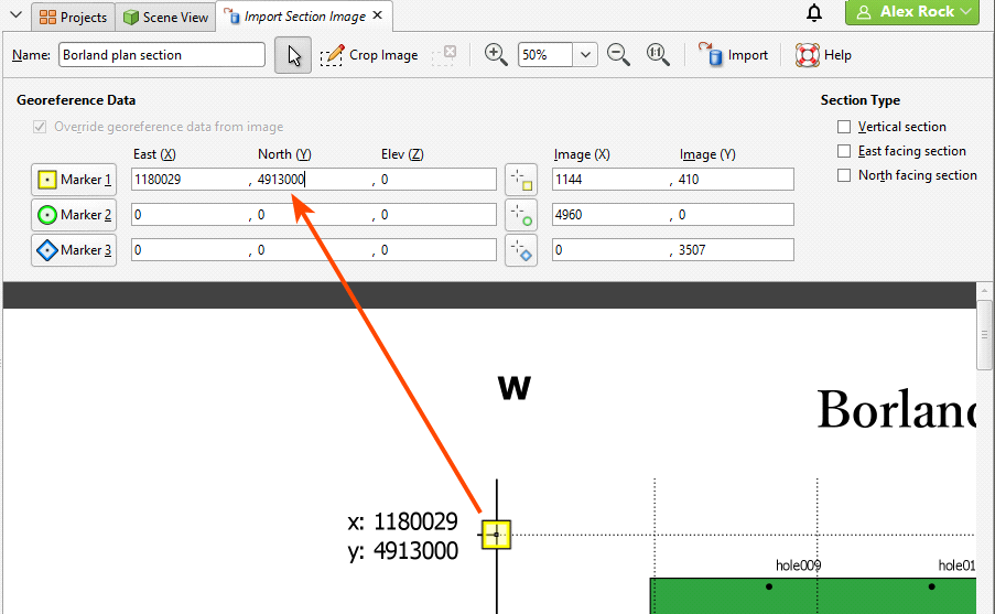

If the image does not contain georeferencing information, you will need to add it manually by adding reference markers and then entering coordinates. First, tick the box for any Section Type options as these constrain the markers that need to be set. For example, selecting East facing section means you will only need to enter the East (X) coordinates once.
To add coordinates to the image, click on a marker and move it to the required location. Then enter the coordinates for the marker:
The Image (X) and Image (Y) fields give you fine control over the location of the marker on the image.
If the image is georeferenced and you wish to discard the information, tick the Override georeference data from image box and edit the markers.
