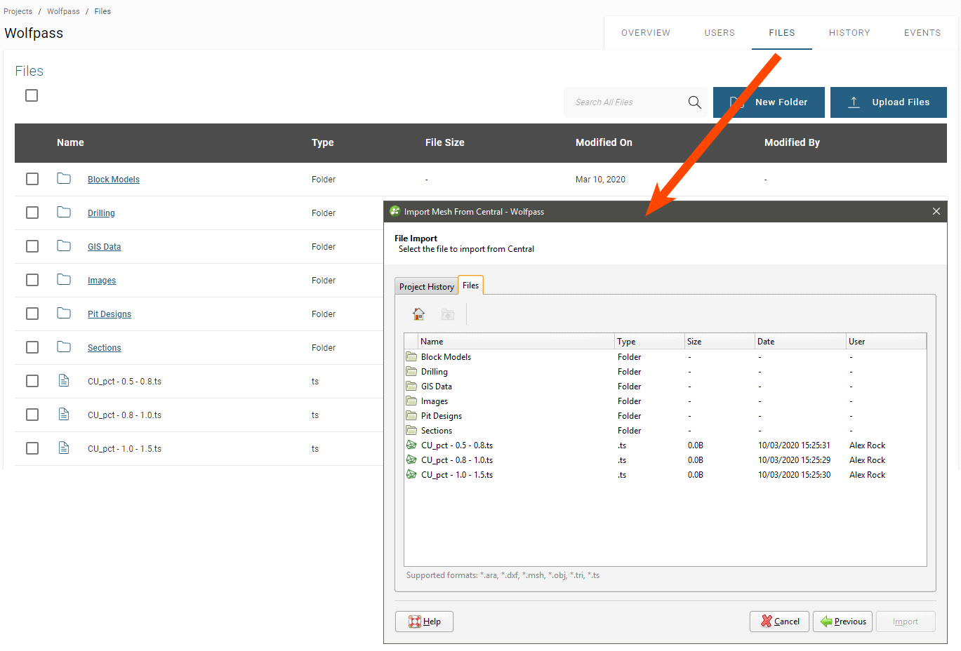

- Uploaded to the project’s Data Room via the Central Portal. These appear in the Import From Central window in the Files tab.

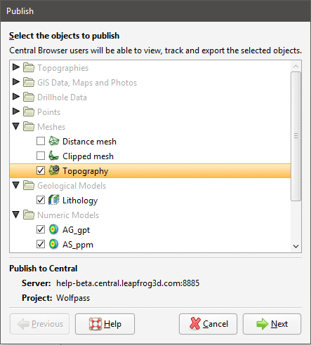

When you publish a project revision to Central from Leapfrog Geo and wish to make a data object available for use in other projects, make sure you select that object from those in the project:
For example, in the project above, the data objects that will be available for use in other projects on the same Central server are the Topography mesh and the surfaces in the Lithology, AG_gpt and AS_ppm models. Unticked objects such as the Distance mesh and the Clipped mesh will not be available.

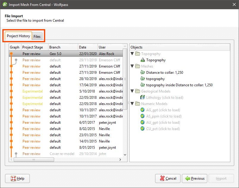

In the next window, there are two options, the Project History tab and the Files list:

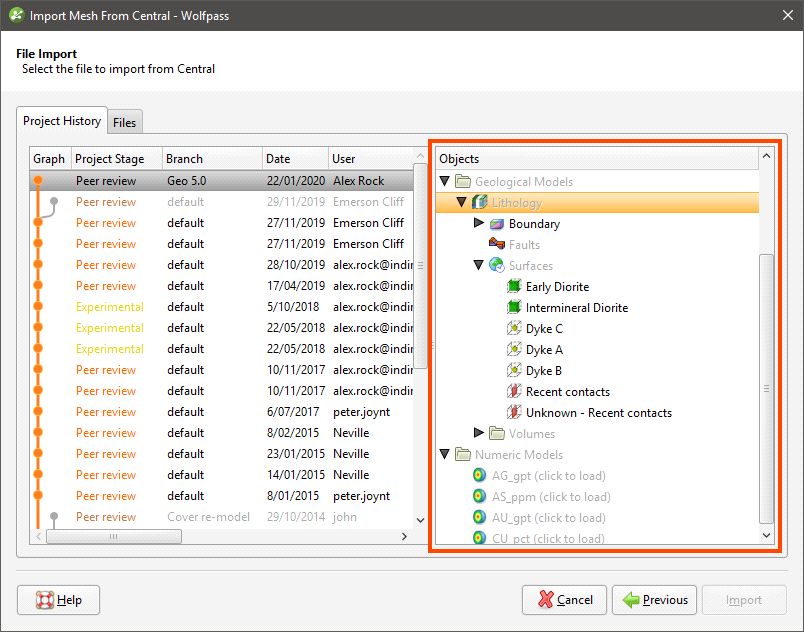

In the Project History tab, select a revision to view its published objects, then click on a model to load its list of surfaces:

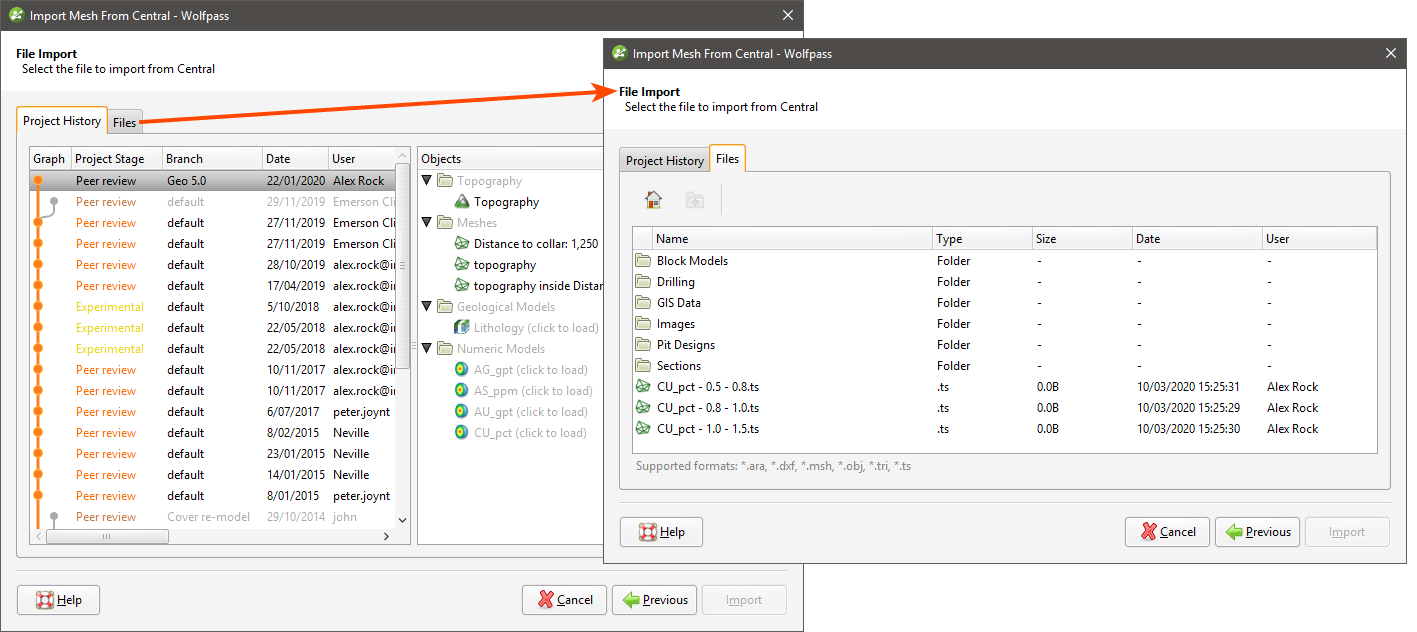

The Files tab shows any files that have been uploaded to the Central project’s Data Room:

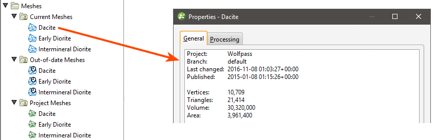

Whether you wish to import files from a revision or from the Data Room, use the Shift and Ctrl keys to select as many objects as required. Click Import to import the objects, which will be saved into the project tree. A different colour is used to indicate objects imported from Central, and viewing the properties shows you what version of the project the mesh came from:
Leapfrog Geo also checks to see if the object imported from Central is the latest version from that branch. In the example above, the meshes in the Current Meshes folder are displayed using a blue mesh icon (
), which indicates that these meshes are the latest version available on that branch. The meshes in the Current Meshes folder, however, are displayed using a different icon (
) to indicate that there are newer versions available.

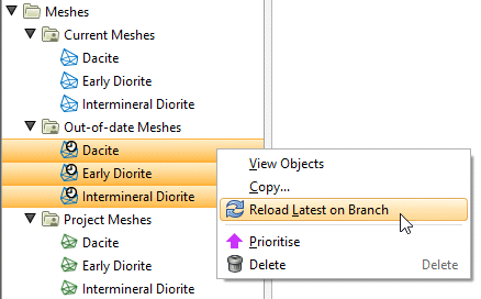

Right-click on a data object and choose one of these options.
If you have selected multiple objects in the project tree, the Reload Latest on Branch option is the only one available:
