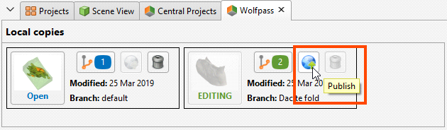

When you are ready to submit your project to Central, you can start the publishing process by clicking on the Central button in the lower left-hand corner of the screen and selecting Publish:
You can also select the Publish button (
) in the Local copies panel:

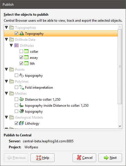

Select the objects you wish to publish from those available in the project:
When you publish a project revision to Central from Leapfrog Geo and wish to make a data object available for use in other projects, make sure you select that object from those in the project:
For example, in the project above, the data objects that will be available for use in other projects on the same Central server are the Topography mesh and the surfaces in the Lithology, AG_gpt and AS_ppm models. Unticked objects such as the Distance mesh and the Clipped mesh will not be available.
Although sub-blocked models can be published to Central, the dip will not be included.
Click Next to choose options for how the project will be uploaded.
