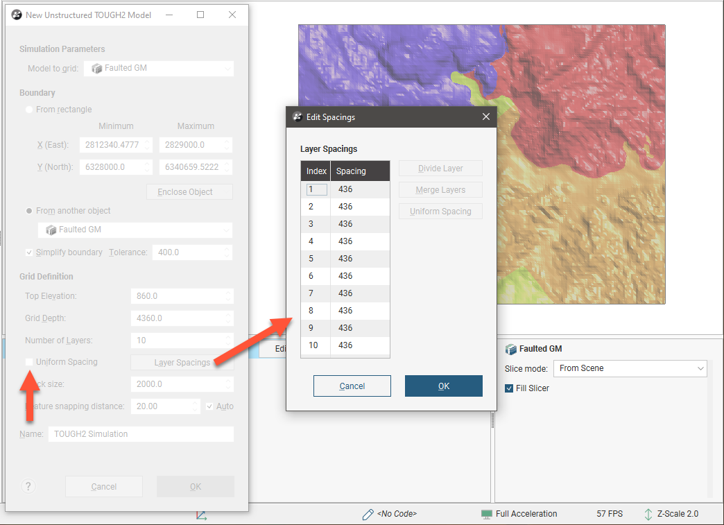

Layers will be uniform, but if you want more control over the layers, untick the Uniform Spacing option and click Layer Spacings to set custom layers:
As with editing the spacings for a structured grid, there are four ways to change the spacings:

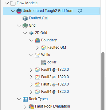

Click OK to create the model, which will appear in the project tree under the Flow Models folder:

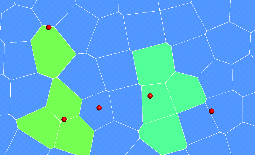

Features can be points (
), lines (
) or polygons (

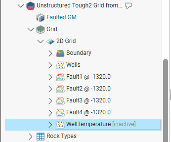

Double-click on the 2D grid (
) to see what features the grid has:
When a faulted geological model used to define the model, the geological model’s faults will be included on the grid as features.

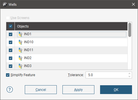

When the model is created and there is only one drilling data set in the project, the well collars are added to the model as a feature. If there is more than one drilling data set in the project, no well collars will be added to the model; you will need to add one of the drilling data sets to the model manually. To do this, add the drilling data set as a feature, as described below.
Double-click on the wells object in the project tree to view the individual wells:
Untick any wells you do not want to use for defining the grid.
If screens are included in the well data, there will be a Use Screens option. When enabled, the x-y coordinates of the mid-point of the screen intervals will be used for the centre points. Otherwise, the x-y coordinates of the collar will be used.
Double-click on individual faults to change their settings.

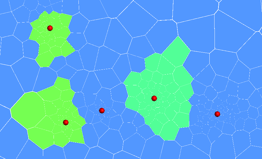

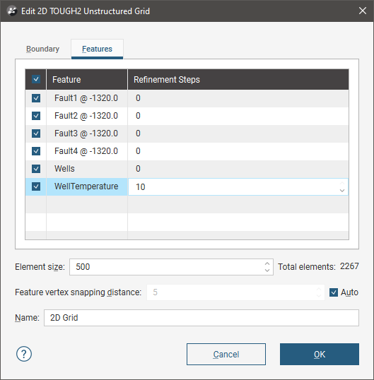

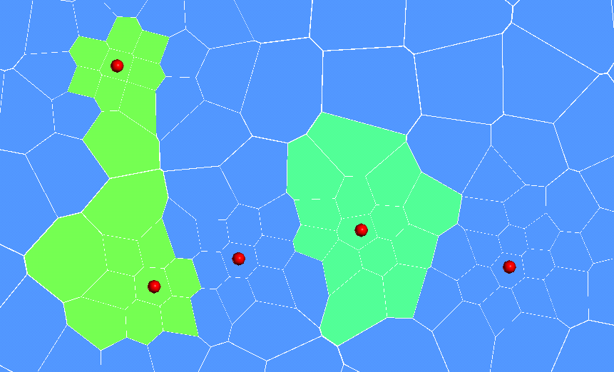

To add features to the grid, right-click on the 2D grid (
) in the project tree and select New Feature. The New TOUGH2 Feature window will appear:

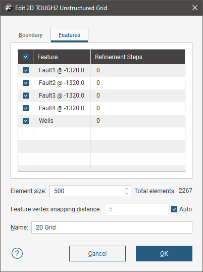

Click Select Feature Object to choose from suitable objects in the project. You can add Point, Line and Polygon features. Ticking the Simplify Feature option will reduce the number of points used.
Click OK to add the feature, which will appear in the project tree under the TOUGH2 grid object:
You can edit the feature by double-clicking on it or by right-clicking and selecting Open. However, the feature has not yet been applied to the grid. To enable the feature, double-click on the grid to open the Edit 2D TOUGH2 Unstructured Grid window. Tick the box to enable the feature, then adjust the number of Refinement Steps:
More Refinement Steps will produce more detail near the feature.
Click Apply or OK to view the effect the feature and its settings have on the grid.
| No features | Collars with 2 refinement steps | Collars with 10 refinement steps |

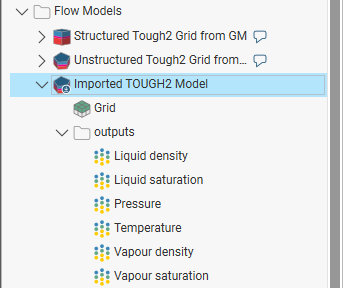

You can import structured and unstructured TOUGH2 models into Leapfrog Geothermal. The process for each type is the same. Right-click on the Flow Models folder and select TOUGH2 > Import Model. Leapfrog Geothermal will ask you to specify the file location. Click Open to import the file.
The TOUGH2 model will appear in the project tree under the Flow Models folder. You can then load TOUGH2 inputs and outputs and generate rocktypes.
Loading TOUGH2 Outputs
To import the outputs, right-click on the model in the project tree and select Import TOUGH2 Simulation Outputs:
Navigate to the required file and click Open. The information will be added to the model and will appear in the project tree in a folder underneath the model:
The outputs can be visualised as described in Displaying TOUGH2 Models below.

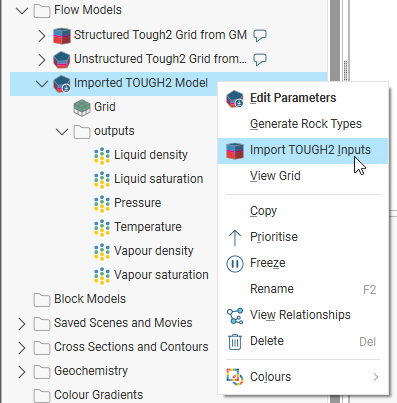

Loading TOUGH2 Inputs
If you have imported a TOUGH2 grid, you can load the model inputs. To do this, right-click on the model in the project tree and select Import TOUGH2 Inputs:
Select the inputs file and click Open. The information will be added to the TOUGH2 model and can be visualised as described in Displaying TOUGH2 Models below.
You can delete the inputs by right-clicking on the model in the project tree and selecting Delete TOUGH2 Inputs.

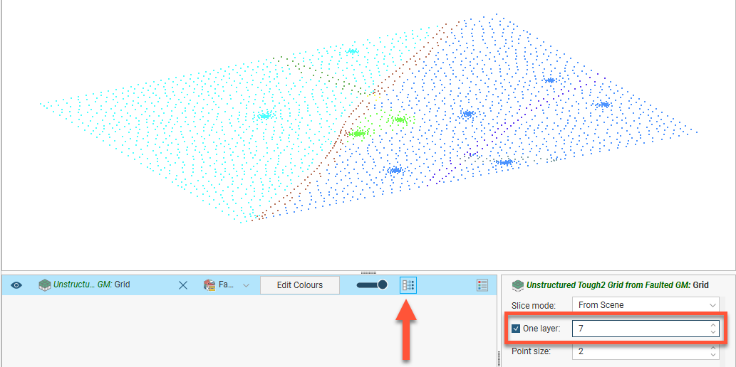

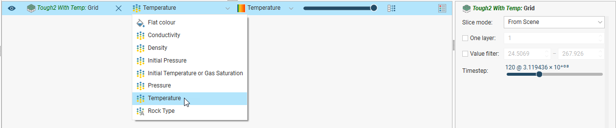

Display a TOUGH2 model by dragging it into the scene:
You can display the model as blocks or points, and you can display all layers or only one layer:
You can select any input as a colour option in the shape list. If the input is time-dependent, a timestep slider will be available from the shape properties panel:
Click and drag the slider or click along the timeline to view the different timesteps available.

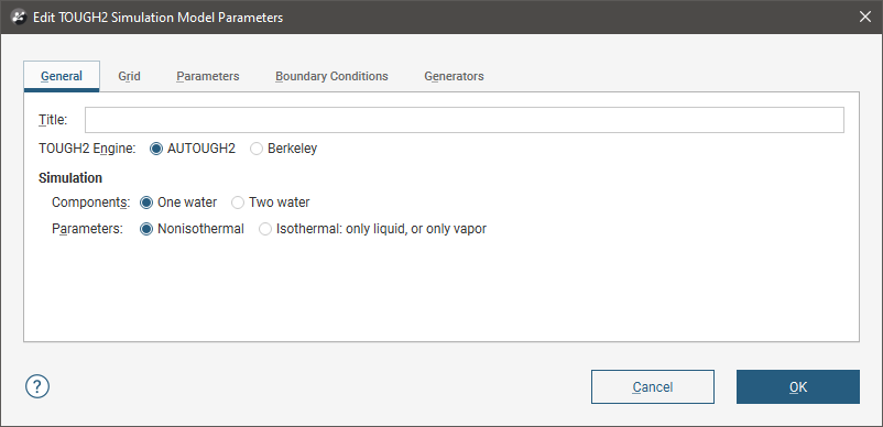

Once you have imported or created a TOUGH2 grid, you can edit information about the grid by double-clicking on the grid in the project tree or by right-clicking and selecting Edit Parameters. The Edit TOUGH2 Simulation Model Parameters window will appear:
Select the TOUGH2 Engine used and set the simulation parameters. When the Two water component is selected, a Mass Fraction option is available when setting rocktypes for the simulation. See Generating Rocktypes for more information.
Note that if you select Two water, only the Nonisothermal option is available.

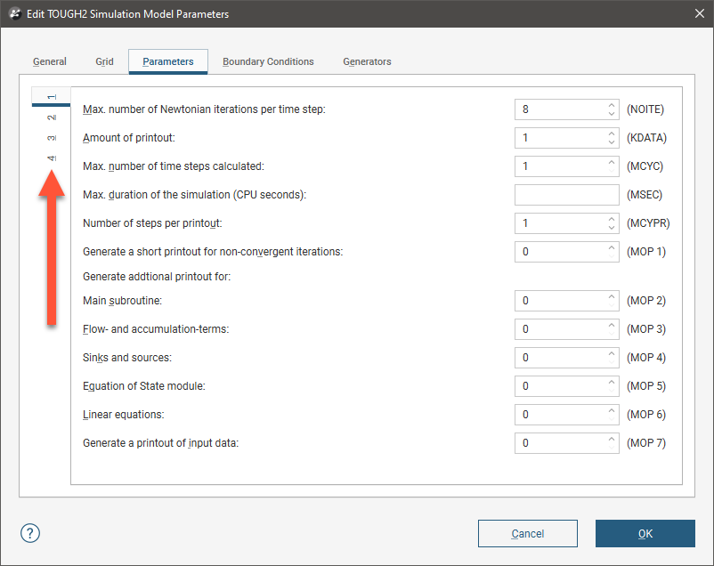

TOUGH2 Parameters
The Parameters tab is divided into a number of sub-tabs along the left-hand side of the window:
A negative value must be set for the Length of time steps (DELTEN) field before the Duration of timestep (DLT) fields can be set.
Once you have set the model parameters, click OK to make the changes.

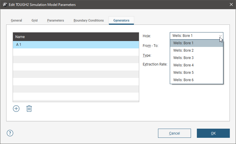

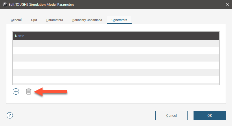

TOUGH2 Generators
If well data in the project includes a screens table, you can define generators for a structured TOUGH2 grid using the screens. To do this, double-click on the model in the project tree, then select the Generators tab:
In defining generators, it is important that the screens are correct and related to the wells; any errors in the screens table should be corrected before generators are defined.
If the Add button (
) at the bottom of the screen is greyed out, check that your screens table has been imported and that all errors in the table have been corrected.
Click the Add button (
) to add a generator, then select the well required from the Screen list:
The From - To list displays the depths available for the selected well.
Select whether the Type is Extraction, Injection or Heat. Enter the properties required for each Type.
You can delete any generator by clicking on it in the table and selecting Delete.

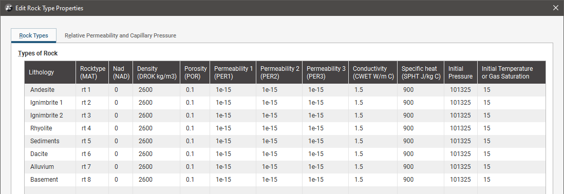

To edit rock type properties for a TOUGH2 model, expand the model in the project tree and double-click on the rocktype object. The Edit Rock Type Properties window will appear:
The window above shows properties for an unfaulted model. See Evaluating a Faulted Model for information on editing rock type properties for a faulted model.
Note that the NAD property is read-only and locked to zero.
The Mass fraction of water 2 option can only be set for Two water simulations. See TOUGH2 Parameters for more information.

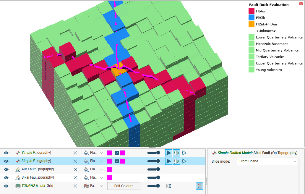

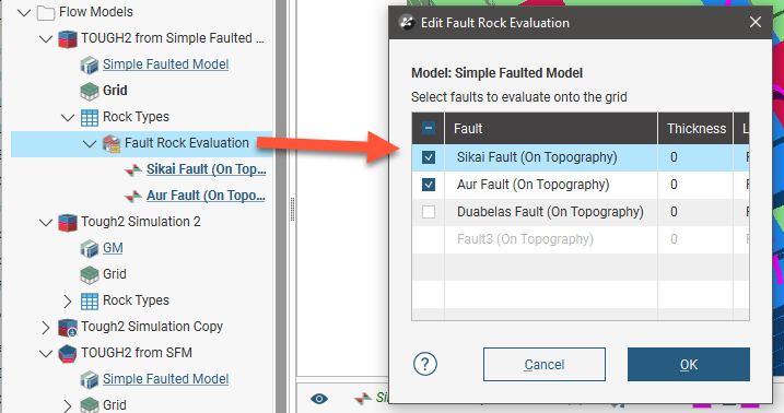

A faulted rocktype evaluation is based on the fault system of the model associated with the TOUGH2 model. For TOUGH2 models created in Leapfrog Geothermal, the faulted rocktype evaluation is automatically created when the TOUGH2 model is defined; for imported TOUGH2 models, the evaluation is created when rocktypes are generated for the model.
Each fault is assigned its own lithology value and if more than one fault intersects a block, a combination lithology is created. This grid shows two intersecting faults (in pink) evaluated on the grid; all geological model blocks in this image are set to display in green. There are three faulted lithologies, one for each fault (blue and red) and one for the blocks where the two faults intersect (orange):
In the project tree, the Fault Rock Evaluation appears under the Rock Types table. You can change which of the model’s faults are evaluated by double-clicking on the Fault Rock Evaluation and disabling faults:
In this example, one fault (Duabelas) is disabled in the TOUGH2 model, whereas the greyed out fault (Fault3) is disabled in the geological model itself.
The Thickness value represents the width of the fault’s crush zone. It is a distance value, and blocks within that distance are assigned the fault lithology. The default value is 0, which means that only blocks intersected by the fault will be assigned the fault lithology.
You can also change the evaluation names in the Fault Rock Evaluation window; simply double-click on the name and edit the text. It is recommended that you keep evaluation names shorter than 10 characters.
Fault lithologies are separated from the model’s lithological units in the rock type table:
