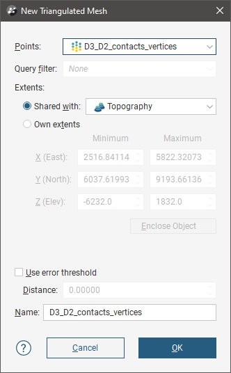

Here, a new triangulated mesh is being created from points:
Select the required object from the list.
When defining the mesh’s extents, you can set the extents to be independent of other objects in the project (Own extents) or you can use the extents of another object (Shared with). When you select the Shared with option, the mesh will be updated when the extents object it shares is updated.

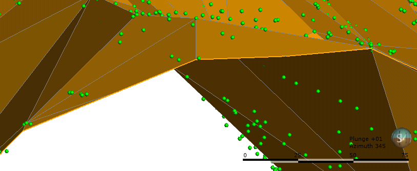

The Use error threshold setting lets you exclude data points that fall within the threshold. This can be useful if you are using a large data set and you require a more coarse surface that omits some data. When Use error threshold is disabled, the mesh will follow all the data.
Here, a mesh created from points has the Use error threshold disabled. The mesh follows all the points:
Here, a mesh has been created with the Distance set to 20. The mesh ignores points that fall outside the threshold:

Enter a name for the new mesh and click OK.
