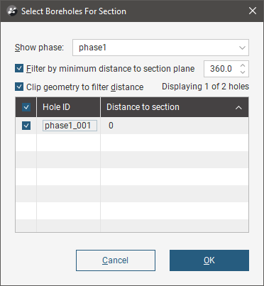

When you click OK the well is added to the layout tree. It will be flagged with No Selection.

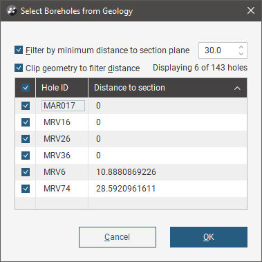

Select the new well and double-click it to open a window to select boreholes. Use the filtering options to determine the limits for the projection of the wells onto the section based on the minimum distance from any point on the well trace to the section plane, and select from the filtered list of wells which should be projected.
When adding planned wells, you can select from the available planned well drilling phases, or select all phases. Then use the filtering options to determine the limits for the projection of the wells onto the section based on the minimum distance from any point on the well trace to the section plane, and select from the filtered list of wells which should be projected.
For both the well and planned well projections, the well selection window offers the option to Clip geometry to filter distance. With this selected, only the parts of boreholes that are within the specified minimum distance will be projected onto the section.
With Clip geometry to filter distance unchecked, if part of a well is within the minimum distance specified, the whole well will be projected onto the section.
