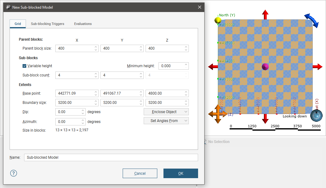

To create a new sub-blocked model, right-click on the Block Models folder and select New Sub-blocked Model. The New Sub-blocked Model window will appear, together with a set of controls that will help you set the size, location and orientation of the model in the scene:
The block model is defined from its Base point, and the reference centroid is the Base point plus one half the Block size. Block models extents always include complete blocks, even when sub-blocking, and when changes are made to the Block size parameter, the model’s extents will be enlarged to fit the Block size.
Model Extents and Rotation
It is a good idea to set the sub-blocked model’s extents from another object in the project, selecting the required object from the Enclose Object list.
The Dip and Azimuth set the rotation of the model. If you know the values you wish to use, enter them in New Sub-blocked Model window. You can also:
- Use the controls in the scene to set the orientation. The yellow handle adjusts the Dip and the blue handle adjusts the Azimuth.
- Use either the slicer or the moving plane to set the orientation. To do this, add the slicer or the moving plane to the scene and adjust the orientation. Then select the object to use from the Set Angles From list.
If you have set the extents from another object and then rotated the model, you will need to reset the extents by selecting the object again from the Enclose Object list.

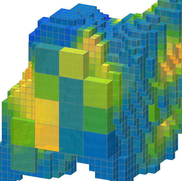

Here the block size is 16 and the sub-block count is fixed at 4 x 4 x 4. Note the regular size and placing of the sub-blocks.

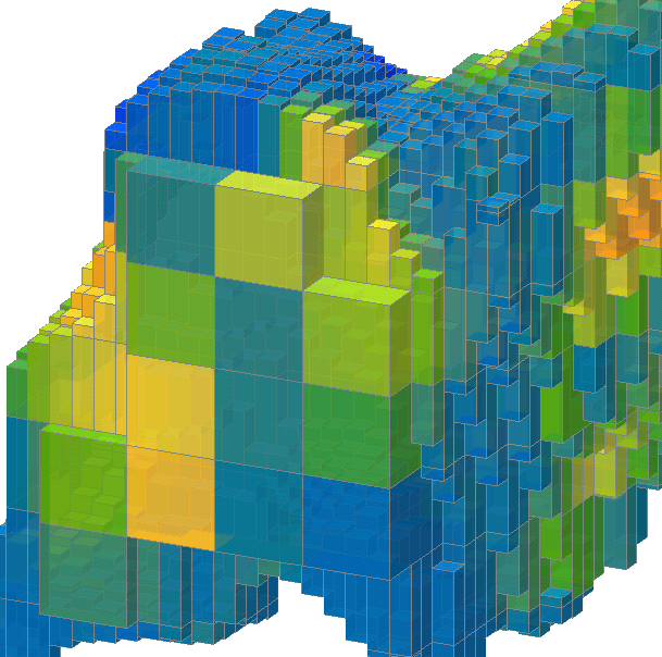

This same model has been sub-blocked with a sub-block count of 4 x 4 with Variable height ticked and a Minimum height of 0.0. The sub-blocks are regularly sized and placed in the X-Y plane, but the Z height of the sub-blocks are not regular in size or placement. The height of a block is not divided into multiple sub-blocks, but the single block can be any height between 0 and the block height. The variable height block is measured inward from the top or the bottom edge of the block, making variable height blocks grow up and down from the block boundary, but sub-blocks will not hover between the top and bottom edges of parent blocks.

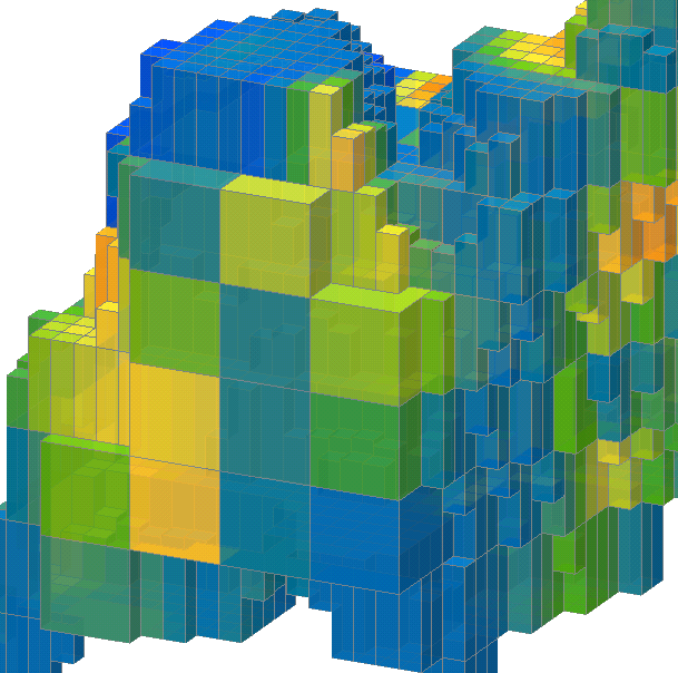

If Minimum height is increased, all the sub-blocks are at least as tall as the Minimum height, in this case 6. Because the variable and minimum heights are measured from the top and bottom edges of the parent block, block heights will be one of:
- 0 (no sub-block)
- exactly the Minimum height
- somewhere between the Minimum height and the block height minus the Minimum height
- exactly the block height minus the Minimum height
- exactly the block height.
If the Minimum height is more than half the block height there will not be a (c) range of sub-block heights.
In this example where the block height is 16 and the Minimum height is 6, if the triggering boundary is:
- between 0 and 3 there will be no sub-block
- between 3 and 6, the block will be 6 high
- between 6 and 10, the sub-block will be between 6 and 10 as per the triggering boundary
- between 10 and 13, the sub-block will be 10 high
- between 13 and 16, the sub-block will be 16 high.
