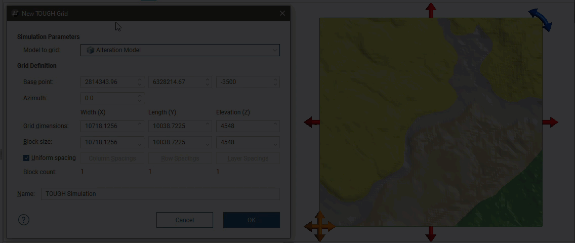

To create a new structured TOUGH model, right-click on the Flow Models folder and select TOUGH > New Structured Model. The New TOUGH Grid window will appear, together with controls in the scene that will help you define the model. In this example, a geological model has been added to the scene to aid in defining the TOUGH grid:
Select the geological model or combined model you wish to use from the Model to grid list, then define the grid using the in-scene controls or the fields in the New TOUGH Grid window. The model should be slightly smaller than the selected Model to grid; any TOUGH blocks that exist outside the Model to grid will be marked as inactive when the model is exported.
Once you have created a structured TOUGH model, you can edit the grid but you cannot change the Model to grid.
As you make changes in the New TOUGH Grid window, the scene will be updated to reflect those changes. For example, here the initial grid dimensions are updated using the in-scene controls. Then the Block size is changed in the New TOUGH Grid window, which results in Block count being updated.
You cannot have partial blocks, which is why when you adjust the grid size using the in-scene handles, the grid will snap to the nearest full block size.
If you wish to use different block sizes in different parts of the grid, untick the Uniform Spacing box and then click the Spacings buttons to change the number of blocks. There are four ways to change the spacings:

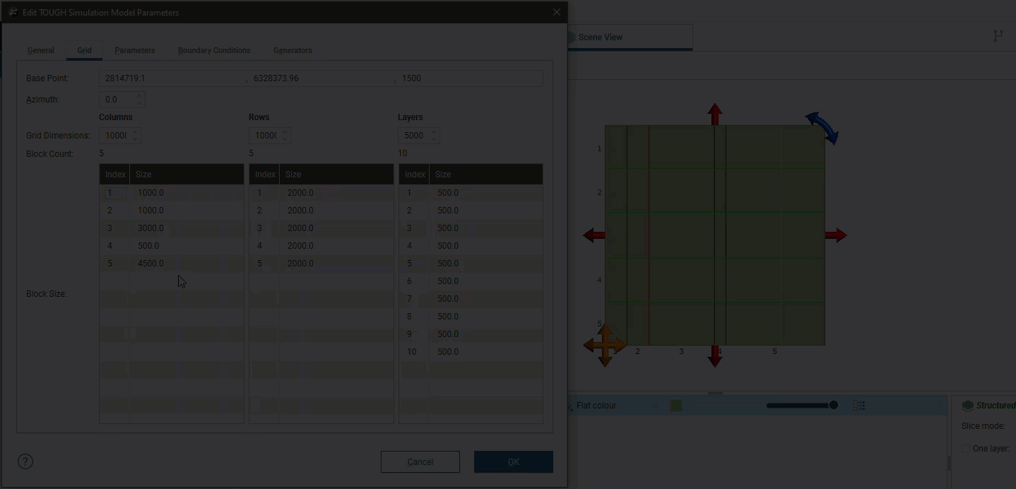

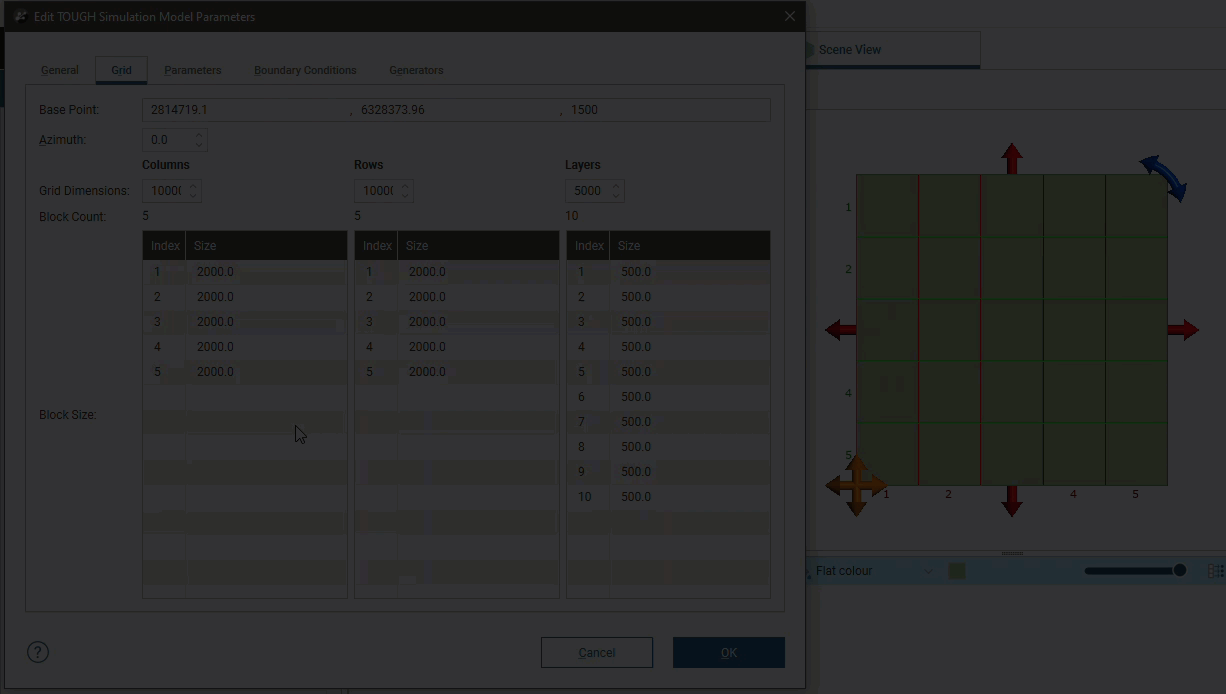

Double-clicking on the grid in the project tree displays a TOUGH Grid Properties window. You cannot edit the grid in this window. To edit the grid, double-click on the model in the project tree, then click on the Grid tab.
In this tab, you can edit:
- The Base Point, using either the fields in the Grid tab or the orange handle in the scene
- The Azimuth by entering a specific value or using the blue handle in the scene
- The Grid Dimensions by changing the Columns, Rows or Layers dimensions in the Grid tab or using the red handles in the scene
- The Block Sizes by clicking on a particular block and changing its value. Note that the difference in value will be accrued to the next block in the list and that the last block in the list cannot be edited.
The block counts cannot be edited; they are calculated from the grid dimensions and the block sizes.
In this example, each column block is 2000. Note how changing one block affects the following block and that changing the block sizes does not affect the overall grid dimensions.
When you enlarge the grid using the red handles in the scene, blocks are added using the value of the last block in the list. Here, enlarging the grid adds blocks of 4500:
Here, the last block is 500 and so enlarging the grid adds blocks of 500:

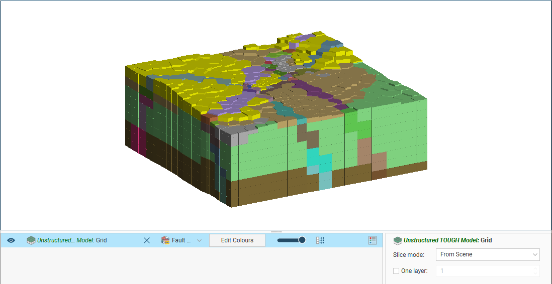

Creating Unstructured TOUGH Models

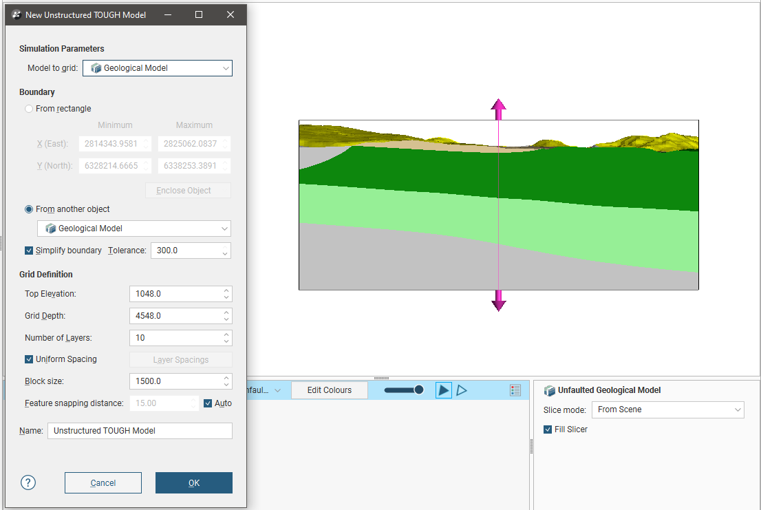

Unstructured TOUGH models are built using Voronoi grid geometry, which typically allows for more detail than structured grids due to the variable size and shape of the cells. To create a new unstructured TOUGH model, you must first have at least one geological model defined in the project.
To create an unstructured TOUGH model, right-click on the Flow Models folder and select TOUGH > New Unstructured Model. The New Unstructured TOUGH Model window will appear, together with controls in the scene that will help you define the top and depth of the grid. In this example, a geological model has been added to the scene to aid in defining the TOUGH model:
A geological model or a combined model can be used for the initial grid dimensions. Select the model required from the Model to grid list and set the dimensions of the grid.
Once you have created an unstructured TOUGH model, you can edit the grid but you cannot change the Model to grid.
The Boundary can be rectangular or it can be defined from another object in the project.
The Simplify boundary option reduces the number of points along the boundary. Reducing the Tolerance value increases the number of points along the boundary. The two settings together let you define a basic boundary with elements that are roughly uniform in size, set by the value of Block size. Once you have created the grid, you will be able to add features to it, which will change the size of the blocks.

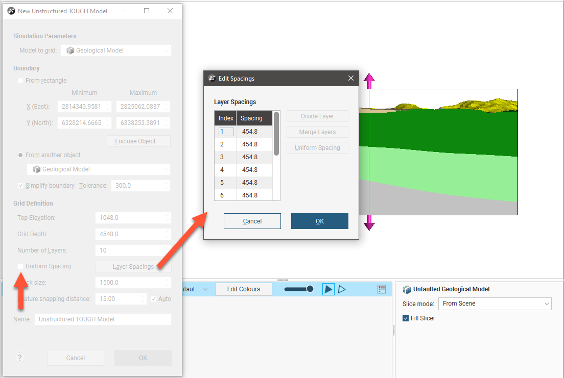

Layers will be uniform, but if you want more control over the layers, untick the Uniform Spacing option and click Layer Spacings to set custom layers:

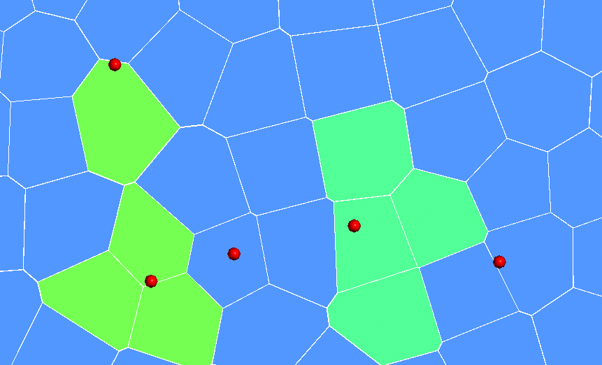

In the New Unstructured TOUGH Model window, the Block size setting determines the basic size of the blocks that make up the grid, although the size will vary according to features applied to the grid and the Feature snapping distance. The size will also vary if the Simplify boundary option is unticked, in which case the Block size setting is the maximum size of the blocks.
The Feature snapping distance is automatically set to 1 percent of the Block size. To use a smaller snapping distance, untick the Auto box and set the value required. You cannot set a value that is larger than 1 percent of the Block size.
The effects of the Feature snapping distance do not become apparent until features have been added to the grid. When enabled, Leapfrog Geothermal will merge centroid points that would be closely spaced so that they occupy a single cell, as opposed to creating tiny cells to accommodate the points.
Click OK to create the model, which will appear in the project tree under the Flow Models folder:

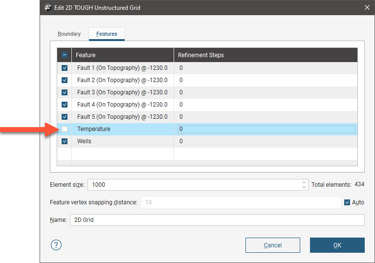

Features are objects added to the model to help control where the cell centroids will be placed, which in turn can help with accuracy and localised detail when defining geologic features. These objects can be points (), lines (
) or polygons (
), as well as existing fault planes, which are automatically added to the model if the model used as for gridding is a faulted model.

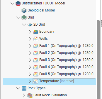

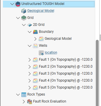

Double-click on the 2D grid () to see more detail about the grid’s features:
When a faulted geological model used to define the model, the geological model’s faults will be included on the grid as features.

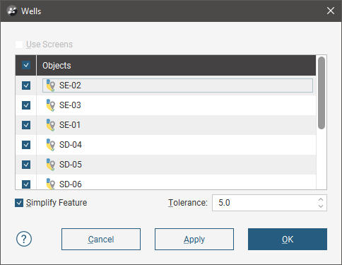

When the model is created and there is only one drilling data set in the project, the well collars are added to the model as a feature. If there is more than one drilling data set in the project, no well collars will be added to the model; you will need to add one of the drilling data sets to the model manually. To do this, add the drilling data set as a feature, as described below.
Double-click on the wells object in the project tree to view the individual wells:
Untick any wells you do not want to use for defining the grid.
If screens are included in the well data, there will be a Use Screens option. When enabled, the x-y coordinates of the mid-point of the screen intervals will be used for the centre points. Otherwise, the x-y coordinates of the collar will be used.

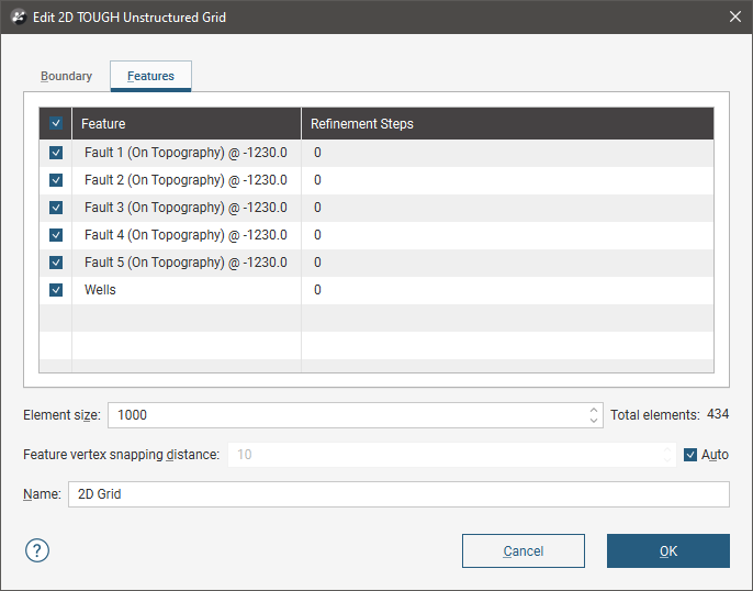

Double-click on individual faults to change their settings.

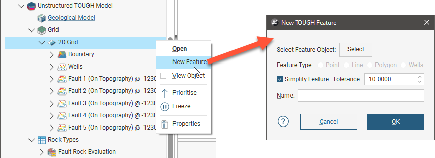

To add features to the model, right-click on the 2D grid () in the project tree and select New Feature. The New TOUGH Feature window will appear:
Click the Select button to choose from suitable objects in the project. You can add Point, Line and Polygon features. Enabling the Simplify Feature option will reduce the number of points used.
You can edit the feature by double-clicking on it or by right-clicking and selecting Open. However, the feature has not yet been applied to the grid. To enable the feature, double-click on the grid to open the Edit 2D TOUGH Unstructured Grid window. Tick the box to enable the feature, then adjust the number of Refinement Steps:

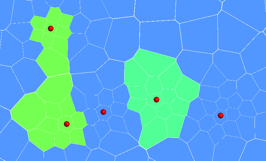

More Refinement Steps will produce more detail near the feature.
Click Apply or OK to view the effect the feature and its settings have on the grid.
No features | Collars with 2 refinement steps | Collars with 10 refinement steps |

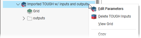

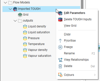

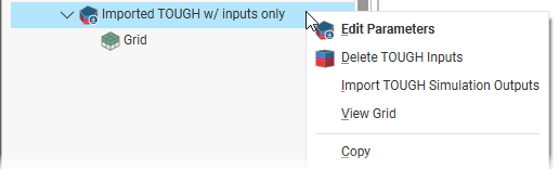

The TOUGH model will appear in the project tree under the Flow Models folder. If outputs are imported, they are added to the project tree in a separate folder.
The options available for the model depend on whether inputs or outputs have already been imported.
- If you only imported the geometry, you can edit the model’s parameters, generate rock types by evaluating another model and import inputs and outputs:
- If you imported the geometry and inputs, you can edit the model’s parameters, delete the inputs and import outputs:
- If you imported the geometry, inputs and outputs, you can edit the model’s parameters and delete the inputs:
If you delete inputs, you can then either import another inputs file or evaluate a model in the project on the grid to generate rock types as described in Generating Rock Types.

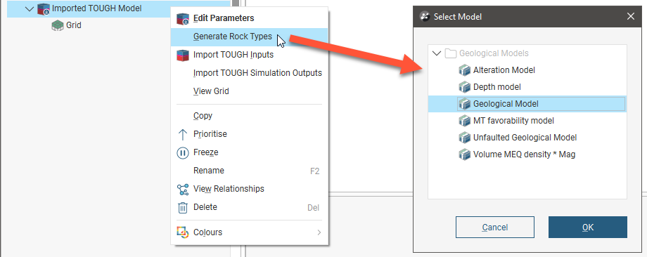

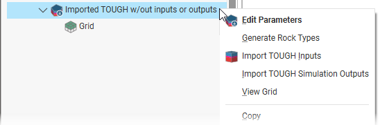

If you have not imported inputs onto an imported TOUGH model, you can generate rock types by evaluating a geological model or combined model in the project onto the TOUGH grid.
For TOUGH models created in Leapfrog Geothermal, the rock type table is automatically generated from the model used as a basis for the TOUGH model.

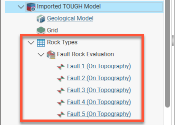

To generate rock types for an imported TOUGH model, right-click on the model in the project tree and select Generate Rock Types.
In the window that appears, select the model you wish to use, then click OK.
A Rock Types table with a Fault Rock Evaluation will be added to the model:
If the selected model has active faults, they will automatically be evaluated on the TOUGH grid, as shown above. If the selected model does not have active faults, the Fault Rock Evaluation will still be present but it is, in effect, only the model evaluation.
Change how faults are evaluated on the TOUGH model by double-clicking on the Fault Rock Evaluation. See Evaluating Faults on the Grid.
Edit rock type properties by double-clicking on the Rock Types table. See Editing Rock Type Properties.

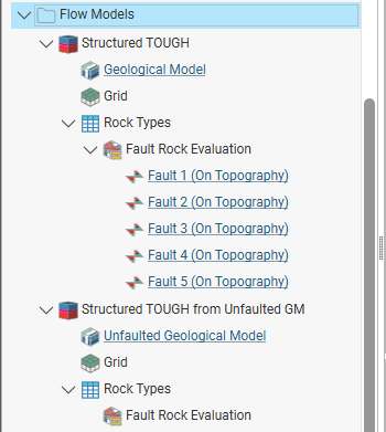

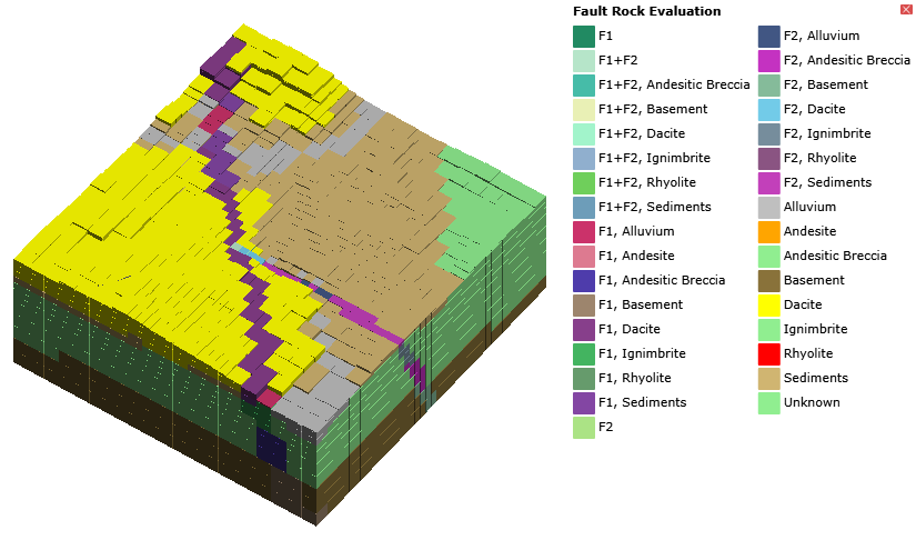

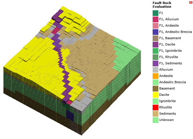

A faulted rock type evaluation is based on the fault system of the model associated with the TOUGH model. For TOUGH models created in Leapfrog Geothermal, the faulted rocktype evaluation is automatically created when the TOUGH model is created; for imported TOUGH models, the evaluation is created when rock types are generated for the model.
Each fault is assigned its own lithology value and if more than one fault intersects a block, a combination lithology is created. For this grid, there are no faults enabled and so there are no fault lithologies:
Here a single fault, F1, has been added to the model. Where the fault intersects blocks, there are combinations of the fault lithology and the other lithologies:
The addition of a second fault, F2, results in more fault+lithology combinations:

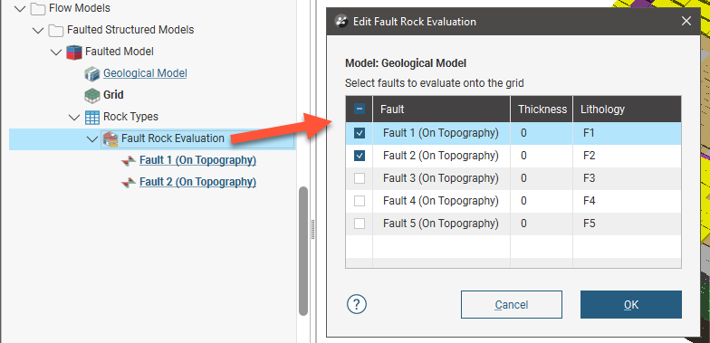

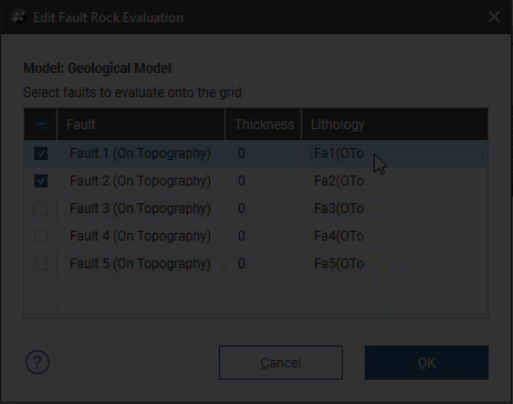

To change which faults are evaluated, double-click on the Fault Rock Evaluation in the project tree. In the Edit Fault Rock Evaluation window, you can choose which of the model’s active faults are evaluated on the TOUGH grid.
The Thickness value represents the width of the fault’s crush zone. It is a distance value, and blocks within that distance are assigned the fault lithology. The default value is 0, which means that only blocks intersected by the fault will be assigned the fault lithology.
You can also change the evaluation names in the Fault Rock Evaluation window; simply double-click on the name and edit the text:

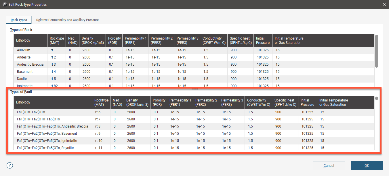

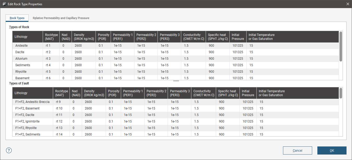

You can set rock type properties for the fault and combination lithologies. In the Edit Rock Type Properties window, the fault units are listed separately from the model’s lithological units:

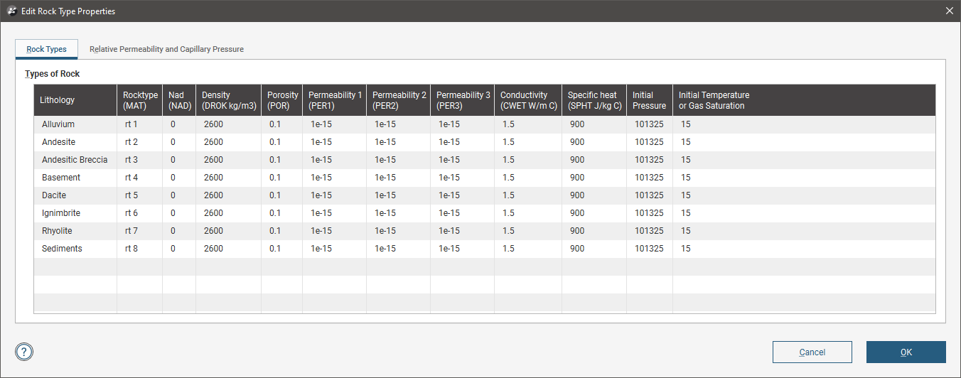

To edit rock type properties for a TOUGH model, expand the model in the project tree and double-click on the Rock Types table. The Edit Rock Type Properties window will appear. This table shows properties for an unfaulted model, where properties can be set for each lithology in the model:
When a faulted model is evaluated on the grid, you can also change properties for the combination lithologies where the faults intersect blocks, as is the case here:
See Evaluating Faults on the Grid for more information on faulted model evaluations.
The tables shown above are those for One water simulations. For Two water simulations, there is an additional column, Initial mass fraction of water 2. The model parameters are changed by double-clicking on the TOUGH model in the project tree. See TOUGH Parameters for more information.
The NAD property is read-only and locked to zero.

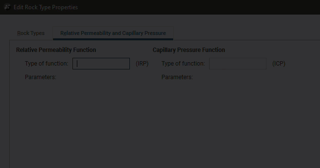

In the Relative Permeability and Capillary Pressure tab, enter the Type of function and set the parameters.
Leapfrog Geothermal supports TOUGH2 two-phase functions:
- For relative permeability, IRP 1 to 8
- For capillary pressure, ICP 1, 2, 3, 4, 6, 7 and 8

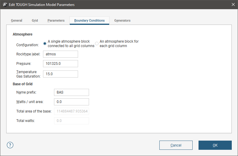

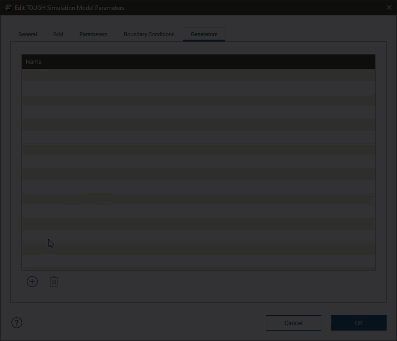

Editing TOUGH Model Parameters

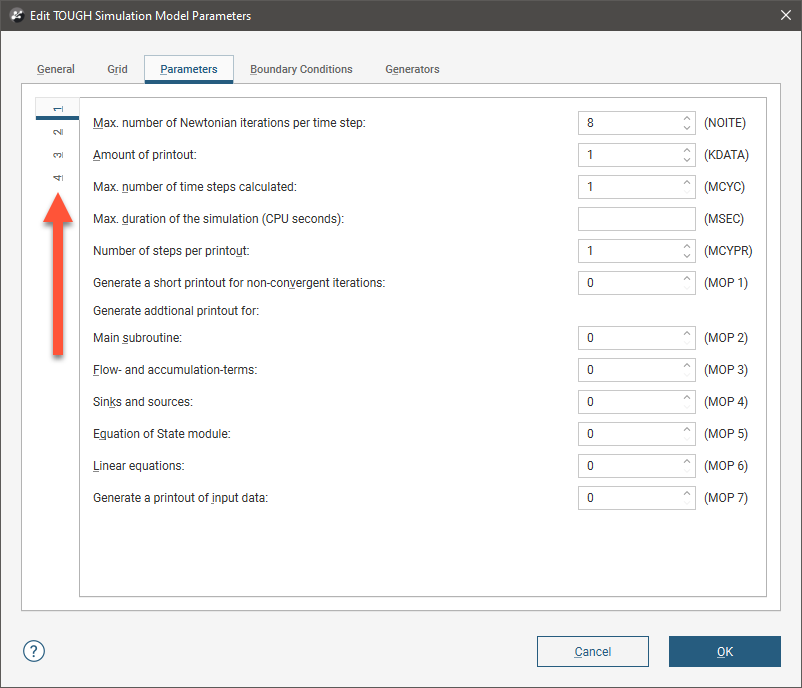

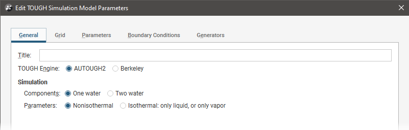

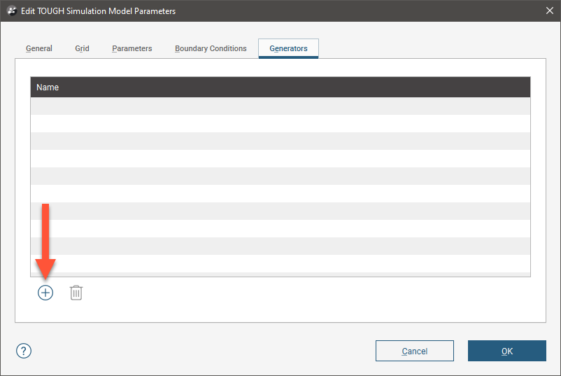

Once you have imported or created a TOUGH model, you can edit information about the model by double-clicking on the model in the project tree or by right-clicking and selecting Edit Parameters. The Edit TOUGH Simulation Model Parameters window will appear.
The options in this window are largely the same regardless of whether a TOUGH model is structured or unstructured, created in Leapfrog Geothermal or imported. The main differences are as follows:
- The General tab contains TOUGH engine settings and different simulation parameters, which are described below.
- The Grid tab displays a summary of the grid definition for all TOUGH models.
- For structured TOUGH models created in Leapfrog Geothermal, you can edit the grid definition in this tab. See Editing the Grid Definition for a Structured TOUGH Model.
- For unstructured TOUGH models created in Leapfrog Geothermal, this tab only displays a summary. However, you can edit the grid definition by double-clicking on the grid (
) in the project tree, which opens the Edit Unstructured TOUGH Model window. All settings except for the Model to grid can be changed. The controls in this window are similar to those for creating the initial unstructured model; see Creating Unstructured TOUGH Models for more information on the settings in the Edit Unstructured TOUGH Model window.

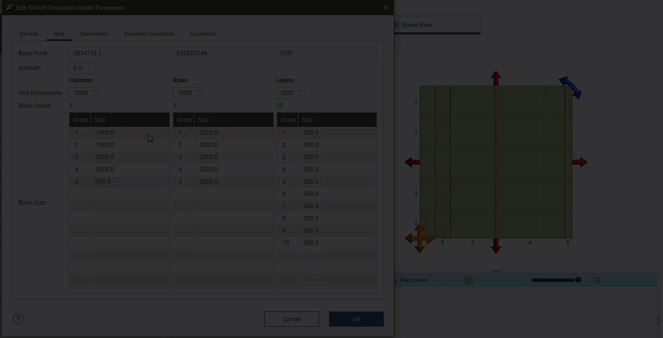

- For TOUGH models imported into Leapfrog Geothermal, only a summary a displayed; the grid definition cannot be changed.
- The Parameters and Boundary Conditions tabs are the same regardless of whether the model is structured or unstructured, created in Leapfrog Geothermal or imported. See TOUGH Parameters and Boundary Conditions.
- The Generators tab applies to structured TOUGH models. See Defining Generators.
In the General tab, select the TOUGH Engine used and set the simulation parameters. When the Two water component is selected, a Mass Fraction option is available when setting rocktypes for the simulation. See Generating Rock Types for more information.
Note that if you select Two water, only the Nonisothermal option is available.
TOUGH Parameters
To change TOUGH parameters, double-click on the TOUGH model in the project tree. In the window that appears, click on the Parameters tab.
The Parameters tab is divided into a number of sub-tabs along the left-hand side of the window:
A negative value must be set for the Length of time steps (DELTEN) field before the Duration of timestep (DLT) fields can be set.
Once you have set the model parameters, click OK to make the changes.
Boundary Conditions
To change boundary conditions for a TOUGH model, double-click on the model in the project tree. In the window that appears, click on the Boundary Conditions tab.
For Atmosphere, you can choose between:
- A single block that forms the top of all the grid columns
- Individual atmosphere blocks for each grid column
The Pressure and Temperature Gas Saturation units are kPa.
Defining Generators
If well data in the project includes a screens table, you can define generators for a structured TOUGH model using the screens.
Before defining generators, it is important that the screens are correct and related to the wells; any errors in the screens table should be corrected before generators are defined.
To defined generators for a structured TOUGH model, double-click on the model in the project tree, then select the Generators tab.
If the Add button () at the bottom of the screen is greyed out, check that your screens table has been imported and that all errors in the table have been corrected.
Click the Add button () to add a generator, then select the well required from the Hole list:
The From - To list displays the depths available for the selected well.
Select whether the Type is Mass Injection, Mass Extraction or Heat, then enter the properties required for each Type.
You can delete any generator by clicking on it in the table and then clicking the Delete button ().

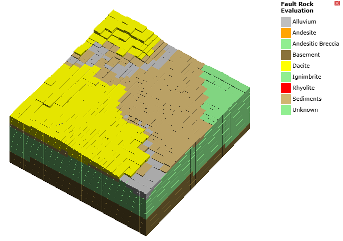

Displaying TOUGH Models

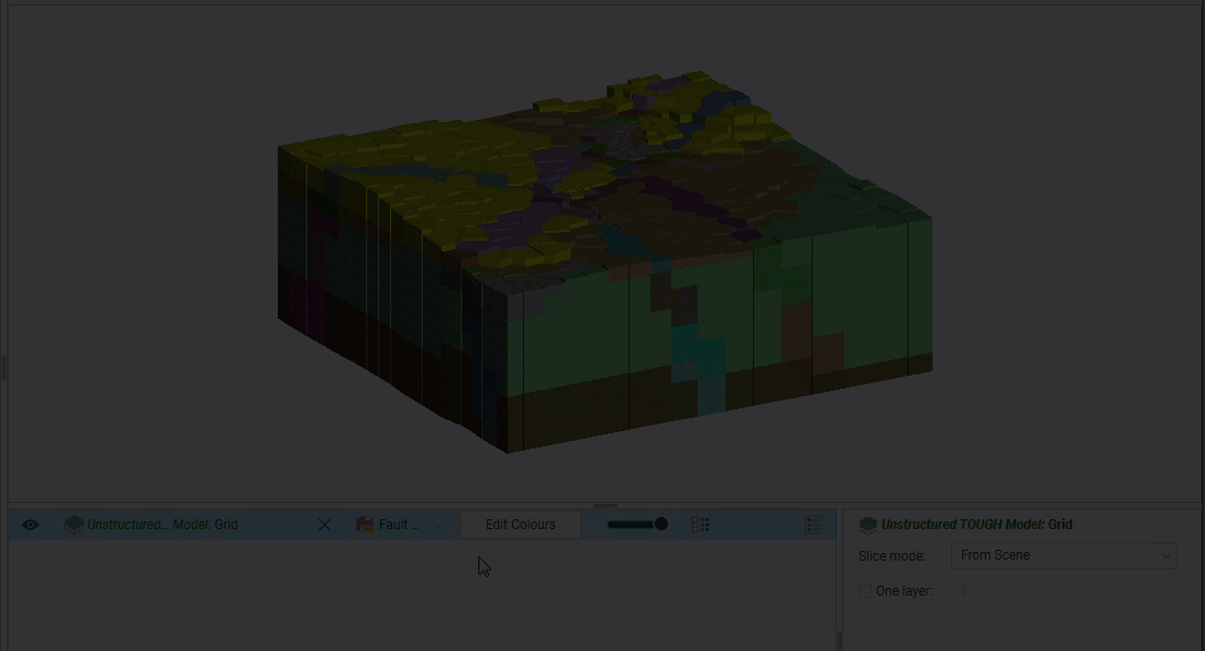

Display a TOUGH model by dragging it into the scene:
You can display the model as blocks or points, and you can display all layers or only one layer:

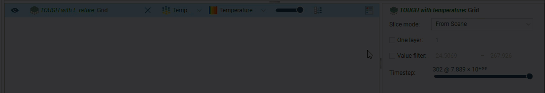

You can select any input as a colour option in the shape list. If the input is time-dependent, a timestep slider will be available from the shape properties panel:
Click and drag the slider or click along the timeline to view the different timesteps available.
