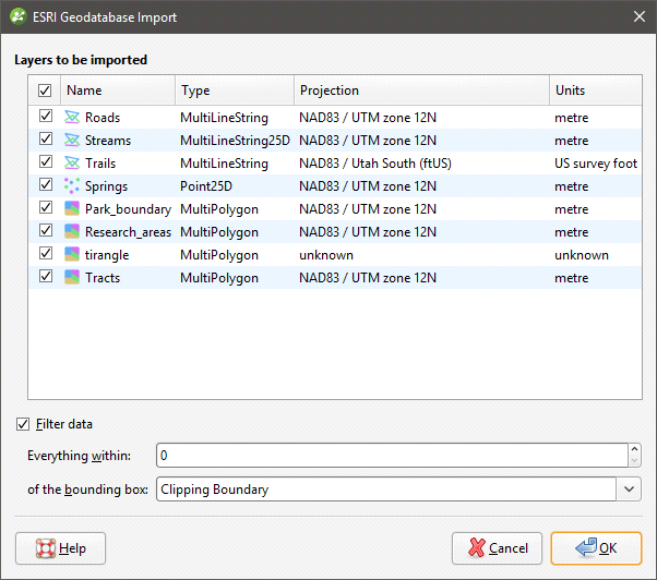

To import GIS points, lines and polygons in this way, right-click on the GIS Data, Maps and Photos folder and select Batch Import > from ESRI Geodatabase. In the window that appears, navigate to the folder that contains the database and click Open.
Leapfrog Geothermal imports uncompressed ESRI geodatabases.
Click OK to import the selected files, which will be added to the GIS Data, Maps and Photos folder as a group (). Data in the group can be reloaded individually or as a group, which is described in Reloading GIS Data.
