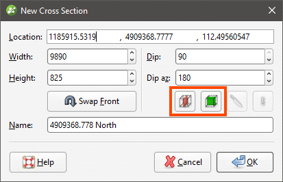

To create a cross section in the scene, add a model to the scene. Next, right-click on the Cross Sections and Contours folder and select New Cross Section. The New Cross Section window will appear, together with a section plane and controls in the scene that let you adjust the position of the section plane:

Two buttons in the New Cross Section window let you create a cross section that is aligned north-to-south () or east-to-west ():
The other two buttons are active when the slicer is in the scene. Clicking the Set section to slicer button () creates a cross section from the position of the slicer in the scene. When the Lock section to slicer button () is enabled, moving the position of the slicer will update the position of the cross section in the New Cross Section window.
Once the section plane is positioned as required, click OK to create the new cross section, which will appear in the Cross Sections and Contours folder. Display it by clearing the scene, then adding the cross section to the scene.
