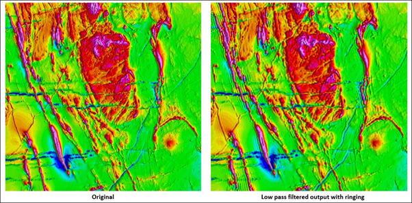

The Butterworth filter is excellent for applying straightforward high-pass and low-pass filters, in particular because if allows you to control the sharpness of the filter around the wavelength cutoff. Many other low and high pass filters result in “ringing” (Gibbs phenomenon) in the output, because they have a sharp “cut-off” either side of the cutoff wavelength. Ringing generally manifests as “waves” emanating from the edges of high amplitude anomalies (see below).
Original magnetic data (left), low pass filtered magnetic data with ringing (right)
The “Filter order” parameter controls the degree of filter roll-off, centered on the cutoff wavenumber, which enables the user to eliminate ringing from the result. If ringing is observed in the filtered result, reduce the filter order by one and re-apply the filter.
