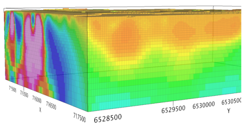

Rotated Voxels
Voxels are commonly gridded with a rotated geometry because geophysical surveys are rarely lined up with the cardinal directions. Creating a voxel with a rotated geometry allows the data to be represented with the least number of voxels and ensures interpolation is not cross cutting the data at sub-optimal angles. This improves modelling efficiency since the number of cells directly impacts data transfer, storage, and computation.

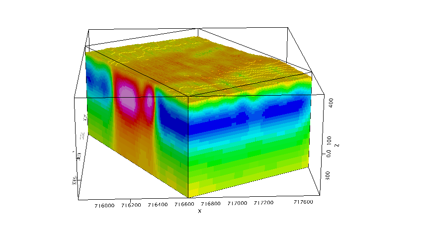

Variable Cell Size Voxels
Voxels are commonly gridded with variable cell sizes to improve voxel quality and to reduce the size of the voxel. Users often represent areas of high data resolution with smaller cell sizes and areas of low data resolution with larger cell sizes. Padding with larger cell sizes may also be added to voxels to reduce the edge effects when modelling geophysical data.
