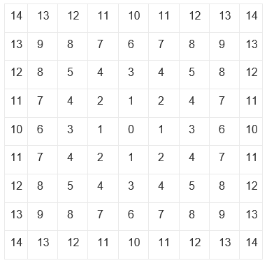

A filter file contains the 6, 10 or 15 filter coefficients starting with the centre point of the centre row for 5X5, 7X7 and 9X9 respectively, then continued with successive rows listed centre then the next right, then continued with successive rows listed centre to right:
For example, in this 7x7 symmetric filter, set filter values for 0, 1, 2, 3, 4, 5, 6, 7, 8 and 9 in the filter file in this order. There cannot be any spaces within or between numbers, and the numbers themselves must be real numbers in the range of-1e31 to 1e32.
If you enter the 6, 10 or 15 coefficients as a string, then enter them just like the above filter file format, using commas to delimit the values.
