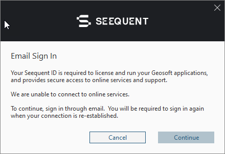

- The Email Sign In dialog appears.
Click Continue and an email to the Seequent ID Service, with the subject "Seequent ID Sign In Request", is displayed.
- Send the email and the second Email Sign In dialog appears.

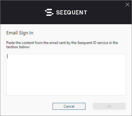

Once you receive a follow-up email response from the Seequent ID Service, copy the content of the returned email and paste it into the window provided in the Email Sign In dialog.

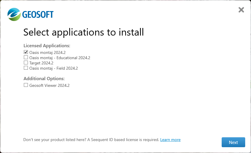

Click OK and the Select applications to install dialog appears. - Select the Licensed Applications and Additional Options you want to install and click Next.

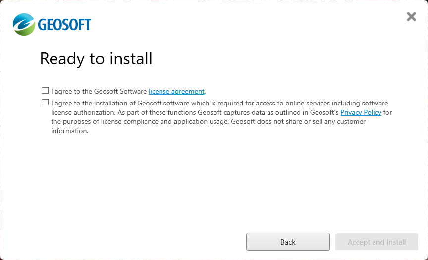

The Ready to install dialog appears. -
Once you have read the license agreement and the privacy policy, click Accept and Install. Your software will be installed.
