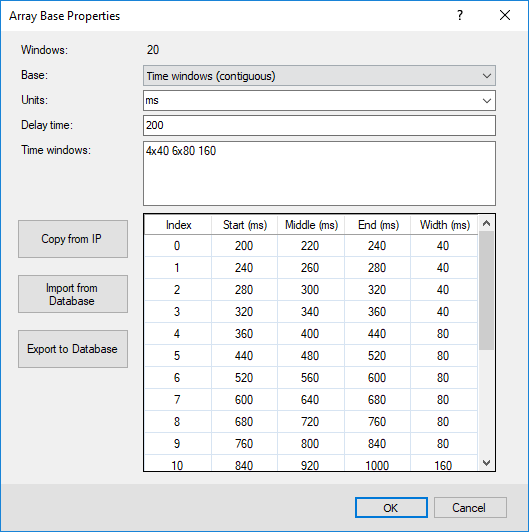

Figure 1: Contiguous time windows. Time increments are provided as a set of consecutive time windows.

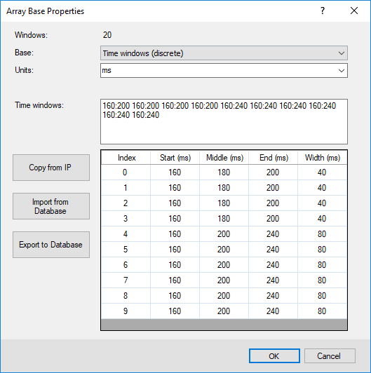

Figure 2: Discrete time windows. Time gates are provided as a set of potentially overlapping start & end times.

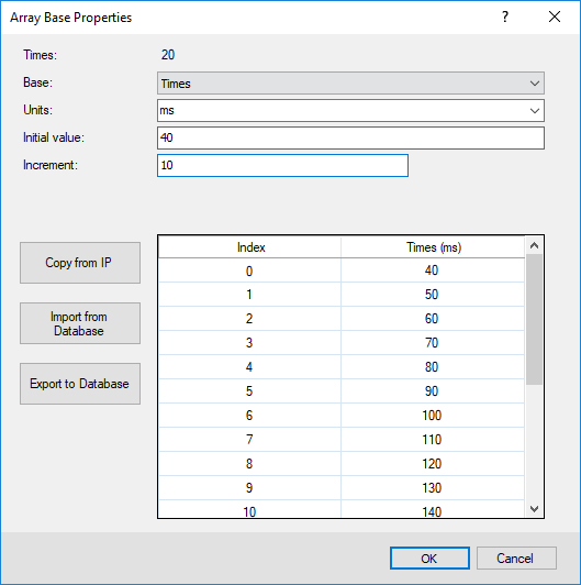

Figure 3: The widths can also be constants.
