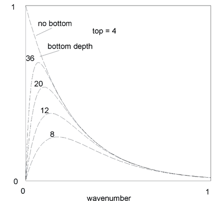

The spectrum for a prism with top and bottom surfaces is:
Where ht and hb are the depths to the top and bottom surfaces, respectively. As the prism bottom is brought up, the peak moves to higher wavenumbers as illustrated in the following figure:
Considering the spectrum of a fixed-size prism, as the prism depth is increased, the peak of the spectrum is shifted to lower wavenumbers (the anomaly becomes broader), and the magnitude of the spectrum is reduced.
An important fact to note in the above figure is that the spectrum of a deep prism does not exceed the magnitude of the same prism at a lesser depth at any wavenumber – only the peak is shifted to lower wavenumbers. Because of this, there is no way to separate the effect of deep sources from shallow sources of the same type using wavenumber filters. This is only possible if the deep sources are of stronger magnitude, or if the shallow sources have a lesser depth extent.

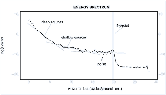

When considering a grid that is large enough to include many sources, the logarithmic spectrum of this data can be interpreted to determine the statistical depth to the tops of the sources using the following relationship:
The depth of an ensemble of sources is easily determined by measuring the slope of the energy (power) spectrum and dividing it by 4π. A typical energy spectrum for magnetic data may exhibit three parts – a deep source component, a shallow source component, and a noise component.
The following figure illustrates the division of an energy spectrum into these three components:
Matched Filtering helps determine the slope of these 3 regions and produces the equivalent depth slices.
