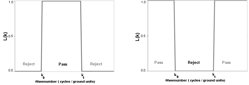

The bandpass filter (BPAS) can be used to pass or reject a range of wavelengths contained in the data. However, applying such a simple cutoff filter operator to an energy spectrum almost invariably introduces a significant amount of oscillation (also known as Gibbs’ Phenomenon). This filter is present for the sake of completeness. We recommend that you use a tapered filter such as the Butterworth filter (BTWR).

Where:
k0 |
Low wavenumber cutoff in cycles/ ground unit. |
k1 |
High wavenumber cutoff in cycles/ground unit. |
