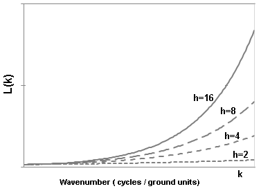

Downward continuation is used to enhance the responses from sources at a depth by effectively bringing the plane of measurement closer to the sources. Note that it is not theoretically possible to continue through a potential field source. Since short-wavelength signal can appear to be from shallow sources, it must be removed to prevent high amplitude and short wavelength noise in the processed data. To do this, you would usually apply some type of low-pass filter, such as the Butterworth filter and Optimum Wiener filter. A plot of the radially averaged energy spectrum would help you determine the wavenumber at which sources (noise) appears to be more shallow than the depth of continuation. The energy spectrum is also a good guide for determining the depth to which data can be downward continued.
