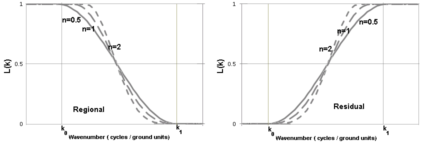

The starting wavelength roll-off in ground unit. See illustration, this parameter is equivalent to k0-1. |
Short wavelength cutoff |
The ending wavelength roll-off in ground unit. See illustration, this parameter is equivalent to k1-1. |
The degree n of the cosine function. The higher the degree, the sharper the roll-off. The default is 2. |
To generate the regional field, select Low pass. This is the default. The High pass is the reciprocal filter and produces the residual field. |

Because this filter has a smooth shape, and it does not alter the energy spectrum below the start of roll-off (or after the end of roll-off in high-pass mode), it is commonly used for simple high-pass or low-pass operations. To reduce ringing, the separation between k1 and k0 can be increased.
Cosine roll-off filter
Where,
k0 |
The starting wavelength roll-off. |
k1 |
The ending wavelength roll-off. |
n |
Positive integer value determining the degree of sharpness of the cutoff. |
k |
Wavenumber domain increment, used to depict a radially symmetrical variable. |
