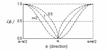

Direction of the filter in degrees azimuth (from North CW) in space domain. It can be used to isolate or remove a predominant geological strike. |
The degree of the cosine function (n). By default, a degree of 2 is used to give a cosine squared function. |

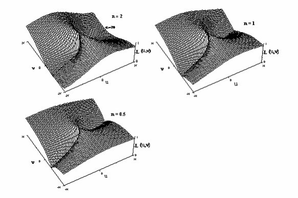

The directional cosine filter is used to remove or isolate signal in the specified azimuth direction. The rejection (or pass) notch can be narrowed or widened by setting the degree of the cosine function so that highly directional features can be isolated more narrowly (see the filter figure below). The use of a directional cosine filter instead of a straight directional pass/reject filter is recommended as it overcomes the ringing artifacts associated with the discrete Fourier transform.

Directional cosine filter
to reject direction ![]() |
to pass direction ![]() |
