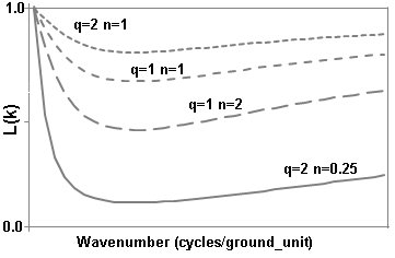

The Notch filter allows to reject the desired mid-wavenumber range while maintaining the low and high extremes of the wavenumber continuum. The Power controls how wide the rejection bad is; the Depth factor controls the degree of the abruptness of the wave form operator.
Notch Filter
Where:
k0 |
Cutoff wavenumber in cycles/ ground unit. |
n |
Power of the filter function |
q |
Degree of the filter function |
